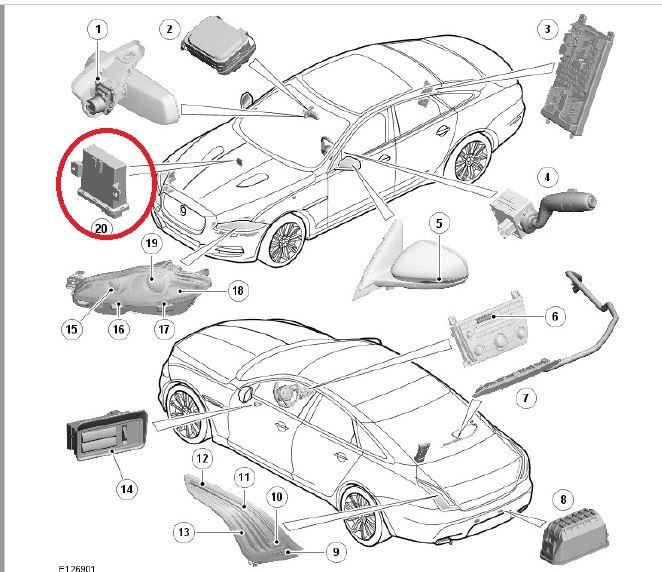

Boy that's an odd and unique one! Never seen or heard of that code but you did get me to dig into this and the module appears to be mounted somewhere on the passenger side firewall? No I think it's on the inside passenger side floor board behind the side plastic kick panel. I found that on an XF so not your car but worth a look.

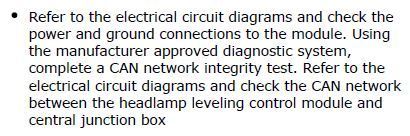

Note it is a network code and the manual suggests checking the power and ground wires going to the module plus a possible CAN bus problem which would again be a wiring issue. I do get a slightly different action description too?
Yours says "Instrument Cluster" and mine says "Central Junction Box". I got the above from my 2014 XJ workshop manual.
Item 20 is what your looking for.

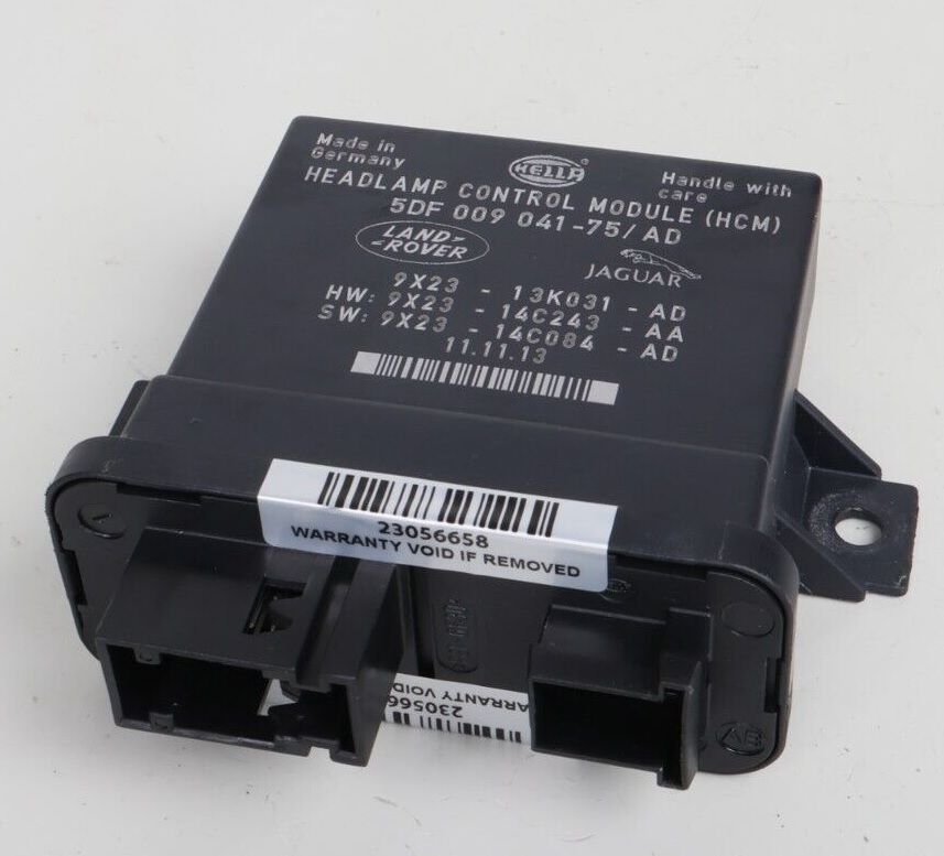

Here is what that module looks like and they seem cheap at under $100 used so if it is the module not an expensive or rare part as every XJ came with one.

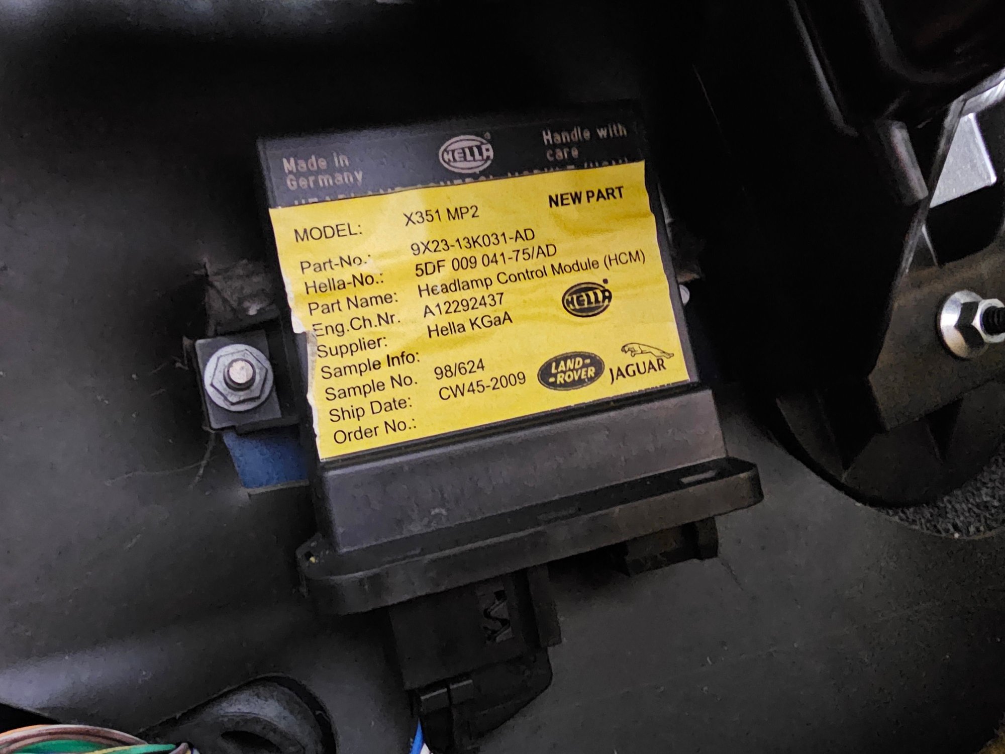

Thanks for the picture and confirming that the module is in the same place on the XJ as it is on the XF.
Your picture only has one plug attached to the module? Was there another plug or was that one on the right side empty?
With the added yellow tag with "New Part" on it I wonder if it has been replaced? I have never seen Jaguar put a label like that on anything?
