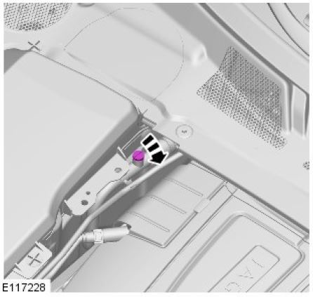

Can you check for codes using a dealer level tool like the SDD? You do have a AUX coolant pump and it may have an air bubble in it or not working.
Have you bled the system using the bleed valve?

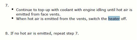

Also from the manual;
Also there are a number of stepper motors or blend doors that can cause this. They all set codes as it's a complicated system. With your symptoms it points to a blend door problem rather than a heater core problem. If the heater core was blocked you should see less heat on both sides of the car. In the manual it states there are 13 stepper motors mounted to the heater/ac case controlling air flow and temperature!
Is the air flow the same on both sides? Long shot but have you looked at the pollen filter? That should not effect anything like this but might as well check it. Another long shot is as always these cars are very sensitive to voltage and battery condition.
I really think that there is a code set that you need to find otherwise there are too many possibilities.

@clubairth1 Thank you! I had tried bleeding, but didn't have the procedure correct, so thank you for that.
I wasn't able to get it onto an SDD, but I was able to get the heater hoses off and gently flush it in reverse before performing a coolant flush. There was some gel that was pushed out in the flush, I think the coolant had been mixed with another type at some point in the past.
The first flush improved the situation (better heat from the mid drivers side vent, but not from the far left) so I did it one more time, and now have great and consistent heat all the way across.
There is one heater hose that is a pain to remove in the engine compartment, just forward of the bleed screw. I was able to get to it with a DEF hose disconnect tool, and remove it that way. Easy to push back on afterwards, just hard to remove.
