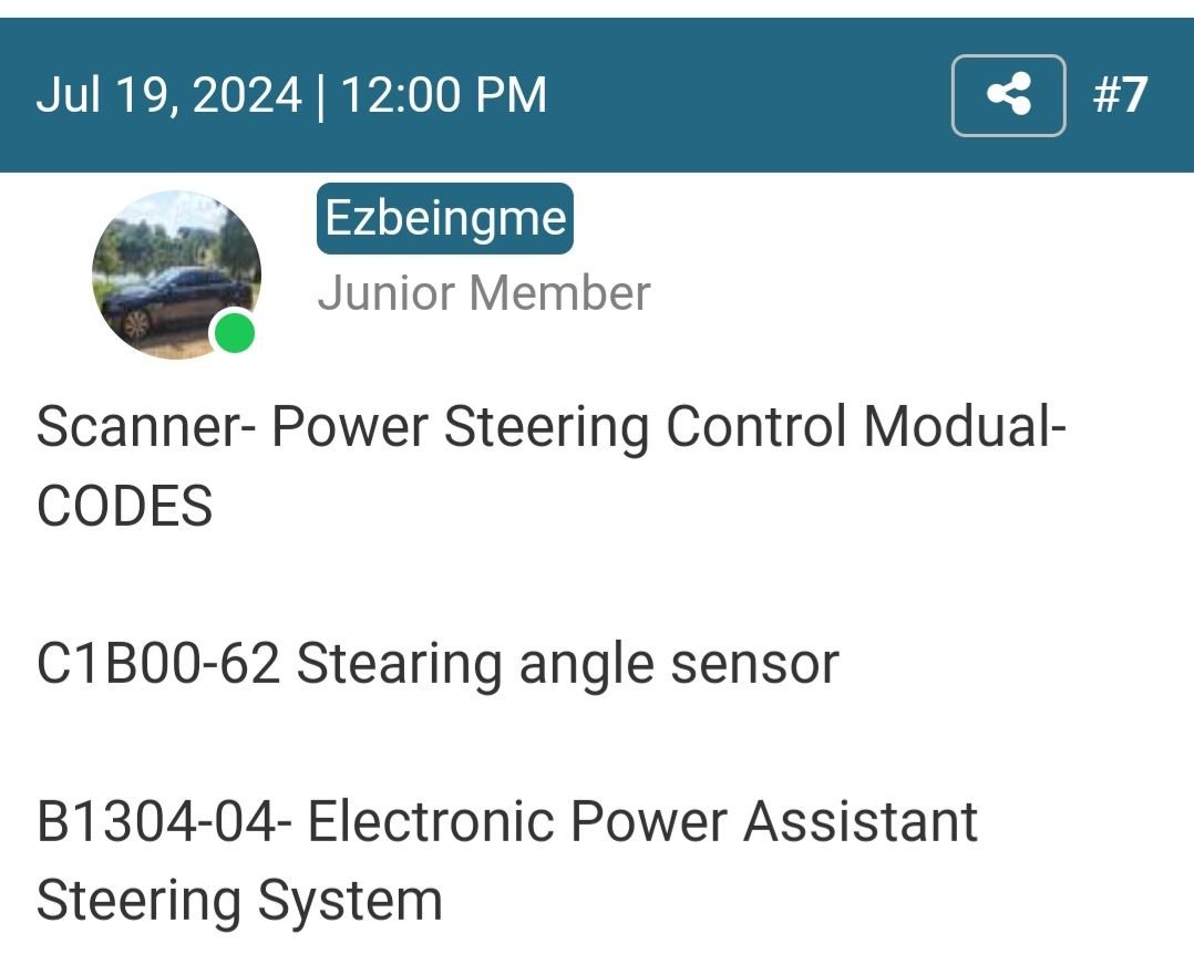

Powe to the car got restored but now Meaning it Works when wheels are off the ground but when I sit it down nothing. Any ideas?

Did you replace any parts?
Your error says steering angle sensor?

The electric Rack & Pinion was replaced and a new battery (the one in the trunk)
we have power now and steering is great when the car is on the lift but as soon as it's lowered to the ground the steering is tight again.
Any help or suggestions would be appreciated.

Are the steering wheel straight when wheels are straight forward? Did you keep the Zero steering wheel position during pinion change and did the new pinion had center position when attached to the steering axle? (on modern cars you cant freely rotate the steering wheel/axle, when pinion is detached)
I think you need re-set the steering angle sensor by diag tool after pinion change?

Ok, Did that already before it wouldn't let us communicatie with steering module
