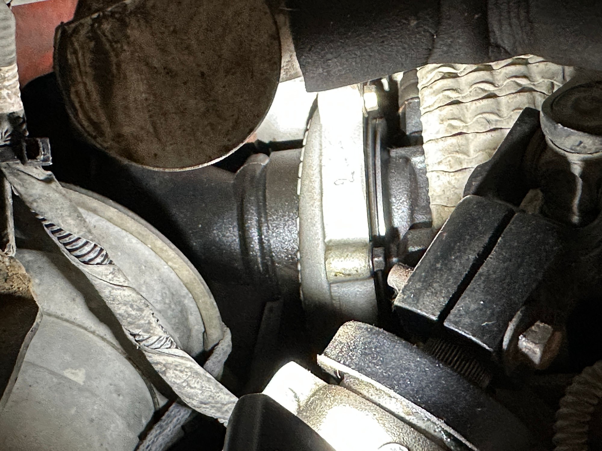

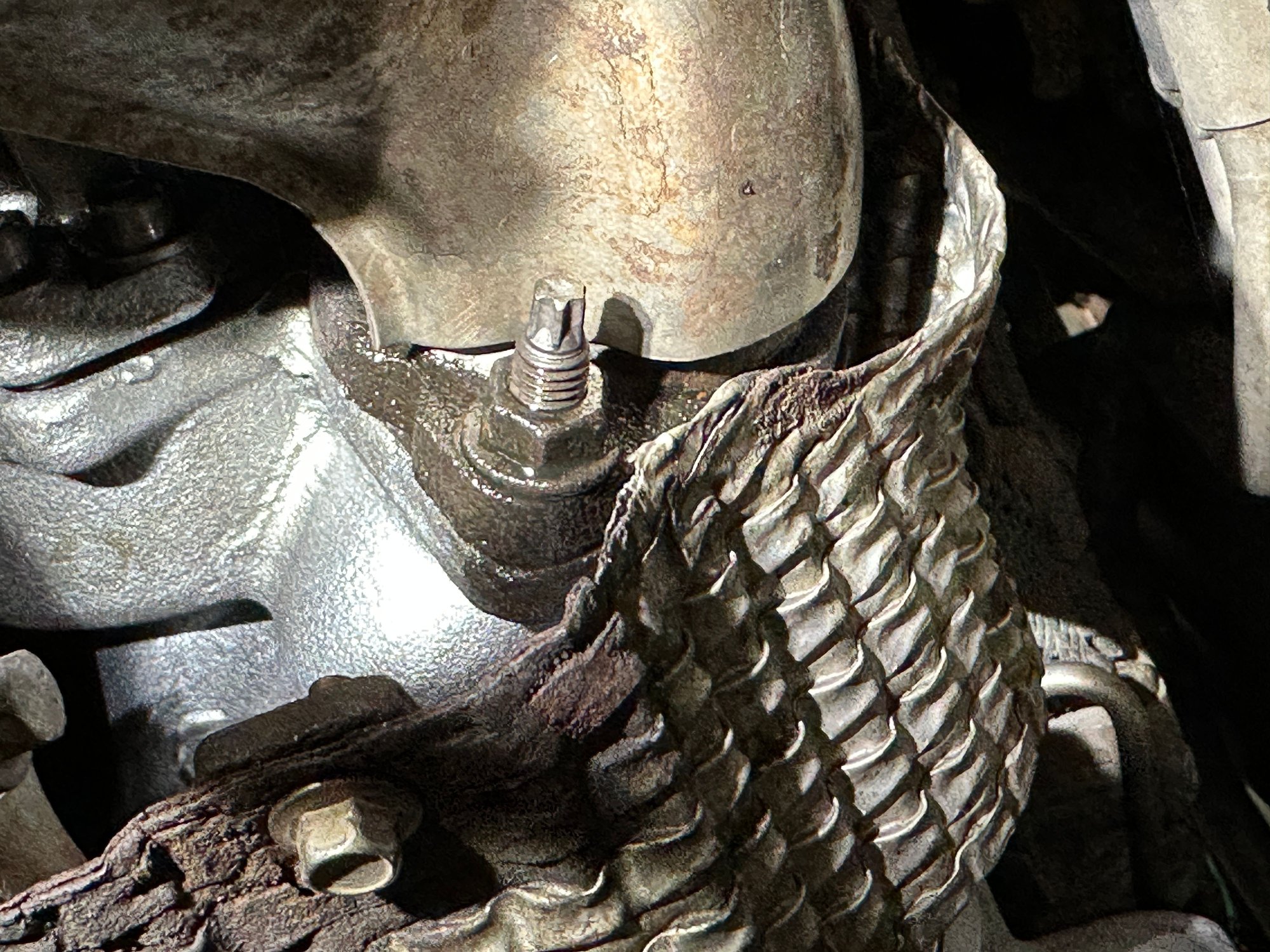

I have a turbo problem. Like I presented in another post on smoke under the bonnet
Left hand drive car. 3.0 diesel
Passenger side turbo has oil leak iin the exit gasket to the dpf
you can see the wet parte around the nuts. In addition, it has some oil on the cold part, intercooler part pipe. Not much, …. Yet, some 2…3 soda bottle caps…
The driver side has a gas leak I guess( can you have a opinion if its a gas leak?) but no oil leaks, and I looked at the other end that's not visible in the pic and its dry
So shiny oily on the intake of the driver side turbo guess its fumes and vapours. The pipe... Seems to te attached to cold part of turbo only by gasket.
Taking into consideration this:
Could I have one or multiple leaks on the recirculation gases system? I have watched a youtube on a discovery 3.0 diesel that had like 4-5 leaks of gaskets for the plastic pipes on gas recirculation system. And being those multiple leaks, generate accumulation of carter gases that could generate blow by? And by consequence.…. Return pipe on passanger side( that I think its the low pressure and rpm working turbo) to leak at both ends? Beside the possibility to have a problem with the return line?
So….. A leak or leaks in gas recirculation.….. Can generate turbo problems? Because gases in the carter and no pressure to recirculate properly? So…return feed pipe is blocked by badd install or over pressure in the carter because recirculation system not working?
Iddle has minor and rare moment when its.… just a bit jittery in traffic at stop and go. No suspicious noises.
And….. Vacuum pump could be a problem? And vacuum system is connected to recirculation system? Leaks would make recirculation system bad, also pump not doing enough with carter gases?
And……. Vacuum pump works with active mounts? Could a leak on the active mounts, beside the other leaks, cause too much leaks for vacuum pump?
Turbos are 3 months old since refurb and around 400 km since refurb. The passenger side has oil on both ends, the driver only fumes on cold end as seen on pics. I know the turbo could be bad from refurb…… but at this moment I consider some other problems.

Lot of quessing and nobody can say exactly where the issue is or can be for sure.
First clean everythng off and then go a have a spin and come back to see where oil actually leaks. (you might need several runs, depending how big / small leak is)
Check the inlet manifolds/cam covers as well, because if they leak, oil is coming above for these parts you see now oily. Yes, if cheap chinese turbos used as replacement they can leak in day 1, since the shaft sealing might not been made high pressision or correct material, but not nessesarly: I have seen very good chinese turbos as well. (even cheap ones) If the leak from turbo is minor it dosent matter. (five drop of oil looks like Exxon Valdez disaster over hot engine) Note: This could be diesel as well coming from above. I would check and solve all possible diesel leaks first. Check the fuel water sensor O ring at the botton of diesel fuel filter. (the sensor/connector/wires are wet if it leaks)
