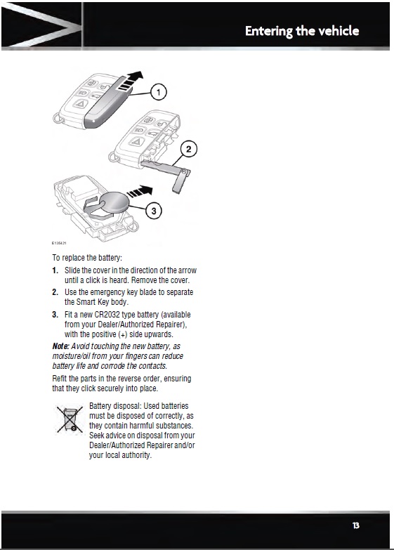

How do I change the battery in the key fob?
Do I need to do any reprogramming after i change it? How do I reprogram?
Old Nov 27, 2013 | 12:24 PM
Likes: 17,005
No programming is required after remote fob battery replacement.
