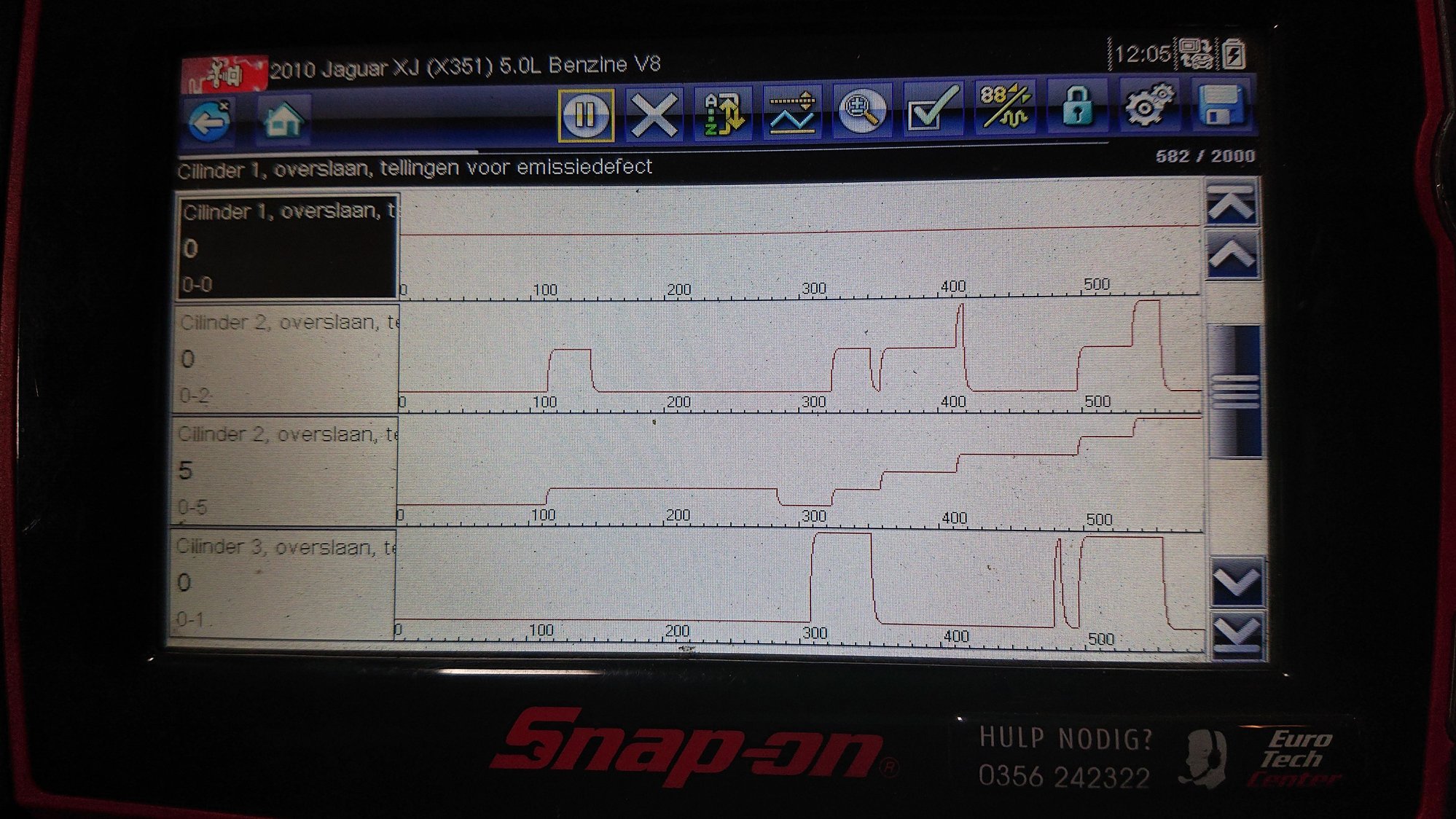

thank you for the reply. I use the snap on solus ultra. It has a counter for misfires in a timeline for every cilinder. On the timeline I see misfires and I hear and feel the misfires. There is no code. Codes I had were manifold pressure, fuel rail pressure, maf .at 1000 rpm I today saw cilinder 2 misfiring many times in a row but al cilinders do. While driving you hardly notice it...exept for 1600 and 2000 rpm... then there is a light shiver through the car from the engine vibration.

thank you for your reply. One moment it stacks up misfires on number two, the other moment it is cilinder 7, onother 1.... it spreads . What you see on the image is what happens random. Very strange is that at exacly 2000 rpm and som other a bit less, 1000 and 1600 there always is a rumble through the cabin that stays.
