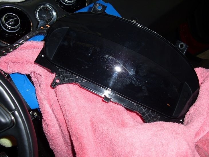

Here is the IP with the trim panel removed.
At this point it's only 4 screws/bolts to remove the IP.
When the IP is out you can still attach the wire harness so at least you could make changes and then check them out without putting everything back together.
You can see the leaper in the above picture when I powered the car up this way.
Sorry I did not go any deeper than this since I was working on installing the larger Android screen in the center stack.
