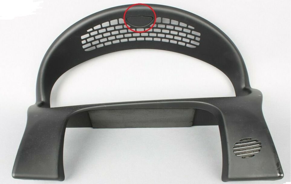

First remove the panel above the steering wheel that also surrounds the instruments. It's all clips except for one hidden screw at the 12:00 position on the panel. It has a small cover over the screw head. I have circled that in red.

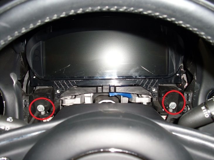

Next I removed the dash instruments. It's just a few bolts and they are all visible. There are more than what I circled below so that's just an example. I might have the wrong screws circled too as this has been several years ago when I did my install.

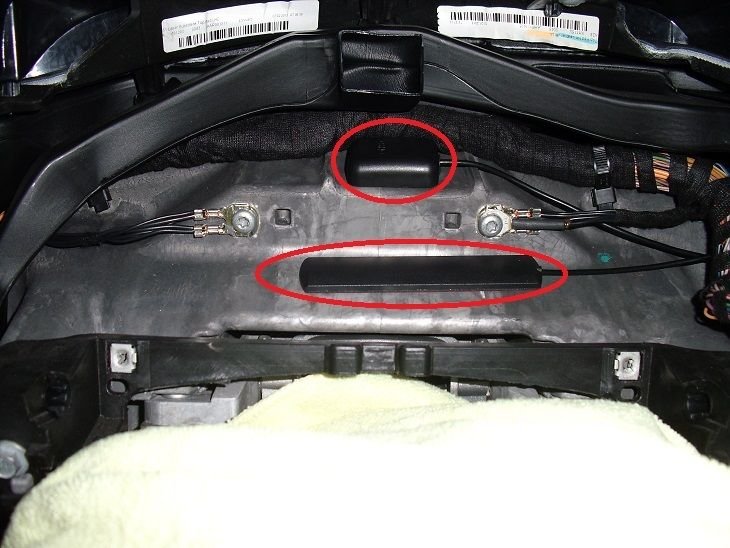

When this is removed start looking at how your part is attached. I went no further than below. Ignore the red circles as that was connected to my Android install. See the two white stick on labels? That's your part.

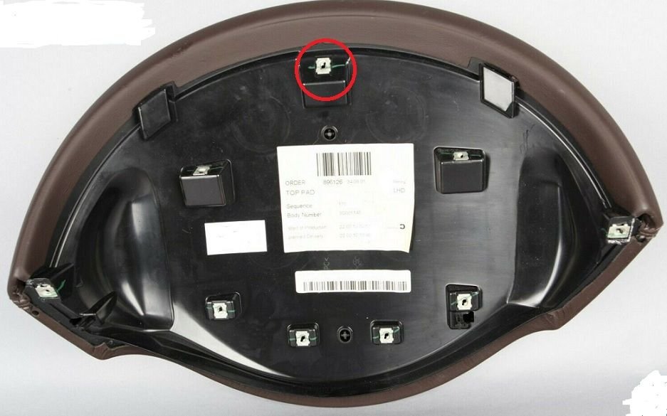

Here is that part from the back side and it does show mounting screws. The red circle is the screw you removed for the panel noted above the steering column.
Looks like you can do it and if you do it would be great if you could come back and fill in the details I missed?
