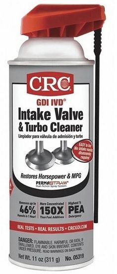

With DI engines the backside of the intake valves get deposits from the PCV system. Some engines are worse about this than others. After reading how to do it and what product to use I decided to give it a cleaning. 2014 XJR just turned 63K miles. Currently the car has no problems.
Used this stuff;
I got a 4 pack from Amazon for about $62 so it's not cheap. I am always unsure about any "miracles" in a can but it is an easy thing to do and not much downside.
Next was where to inject it and that turned out to be simple to do and I have not seen it posted before.
There is a large vacuum line right at the mouth of the intake. Remove the factory hose with the little clip at the base. Then attach some tubing. I wanted to sit in the car and rev the engine as I sprayed so got a couple of feet of tubing. Used a smaller bit of tubing to adapt down to the small straw on the spray can on the other end.
Followed the instructions about keeping the engine around 2000 rpm's while spraying this in bursts. Did not seem to make the engine stumble much so I increased the spray interval. Can took a while before it was empty. Again follow the instructions and rev the engine to 3500 rpm a couple of times after you finish the can. Then shut the engine down and let it cook for an hour (At least).
Started the engine after an hour hot soak and revved it to 3500 rpm with somewhat large clouds of smoke. Took it out on the highway for about a 20 mile hard run. Ran it in 5th and 70 mph to keep the revs up around 3000 rpm.
I was surprised but the car has a noticeable smoother idle now. Not sure but the throttle response seems crisper but that is just the ol' butt dyno speaking so maybe just me. Was expecting some check engine lights and temporary codes but the only thing I got (Which is the first time I have seen this?) was a loose gas cap warning with a yellow triangle on the dash. Not an error code! Stopped and cycled the gas cap off and on a few times got back in the car and all was well and I finished the drive.
So I think it was worth it and will start this as a regular service. Just don't know the interval? 10K miles, 20K miles? You can't over do it as it's just a cleaner. I should have used my snake camera to look at the valves before and after.

These guys did the before and after. Not much difference. If you have ever hand-cleaned the hardened, thick goop on these valves, like I have, a spray treatment seems unlikely to help.

When I was cleaning the valves by hand, I tried a lot of different products, and the best one was a common carb spray cleaner. The CRC valve cleaner did very little to dissolve the tar-like gunk even after soaking the valves in it. I rotated the engine by hand to close the valves and made a pool of the CRC product in that intake port. Pretty disappointing.
