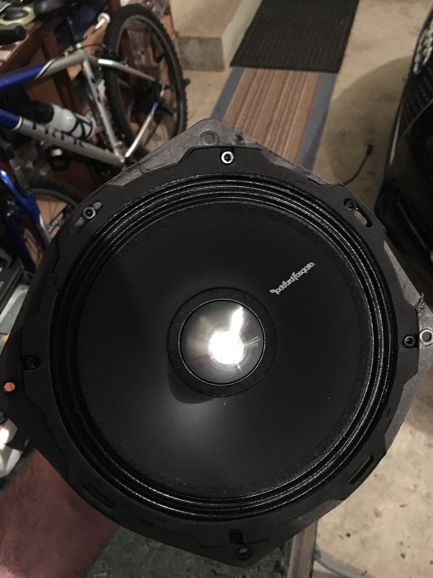

Fixed my speaker issues, and you were right, voice coil separation. So I ordered 8" Rockford Fosgate mid bass speakers, and removed the door card. Then pulled old speakers.
I actually had to cut the old speaker lip off the old speaker and use it as a mount. This also gave the magnet enough clearance to sit flush. I also used dynomat tape to make sure there would be no rattles. Everything went in tight and smooth, and the car sounds incredible. I recommend this even if your speakers aren't blown. The mid bass sound is superior. And you can hear the music a lot better, the speakers I used were RF PPS4-8 4 ohm. Only cost 120 for the pair from eBay. I don't have a final install pick as it got too dark, but you can see the way I cut the old speaker and how it mounted up when I was testing it.

How did you clear the window track mounted behind the speaker?? I ended up having to use a .180 inch thick spacer I cut out of lexan on top of the original speaker bracket.

In one of he posts in here I posted pics of how I used the original speaker frame as a spacer and mount. It worked perfectly. Basically I cut the back off of the original speaker keeping the ring that was the surround and using it as a spacer. Gives clearance and also seals back air tight.

I did that exact same thing and it still hit the window track! I had to cut an additional spacer to fit between the original speaker frame and speaker ring for the magnet to clear the window track. This is what I think the possible issues could be:

This is how I had to clear the window track! I used the stock speaker frame cut down the same way you did but had to cut two plastic spacers to fit in between the speaker and the mount. Without the spacer the magnet hits the window track within the door leaving about a 1/4 inch gap between the speaker and the stock speaker frame. Friday I will attempt the rears and see if I run into the same issue!
