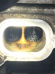

Intake valve carbon build up on my 2011 N/A 5.0 XJ with 88,000 miles. This engine does not have a rough idle. Fyi. Not too bad. I only use Jaguar oil

Cooked oil on the back of the intake valves normally spells a valve stem seal leak.
Not at a critical point yet looking at the photo.
You will know when they need changing because you will get a puff of blue smoke out the pipes on start up when the car sits overnight or for a few days, then clears within a minute or so.

Not even close.
That is from DI (Direct Injection) NOT from anything being wrong with the engine. Completely normal and really does not look bad at all.
We need to understand the basic problem. That is with direct injection the fuel is ONLY injected into the cylinder. So all the crap from the PCV system is deposited in the intake system all the way to the back side of the intake valves. Which is what that picture is showing.
This is a MAJOR problem with Audi's and other brands of cars.. Some need to be cleaned regularly and I have seen over 100HP loss of power because of the carbon build up. We are lucky because so far Jaguar engines that use DI don't seem to have a lot of problems. Just be aware there have been several case's on the 5.0L that have carboned up in a big way. Don't know why as I think the engines are the same but Land Rover 5.0L's are worse.
Be aware that cleaning can be as simple as sucking some solvent into the engine and letting it work to taking the top half of the engine apart so you can walnut shell blast the carbon deposits away. As you can guess taking the engine apart and blasting parts is not going to be cheap!
As I have posted before on boosted American Performance cars (Turbo or mechanical super charger) it is extremely common to install PCV catch cans to prevent the oil getting into the intake.
There is also many running Methanol injection (Corn). This keeps the intake spotlessly clean as well as lowing your intake air temperature which is critical in a boosted engine.

I also had the dealer do the BG cleaning service 4000 miles ago. I don't think it helped much with the Jag or my wallet!!!

Interesting because that is recommended to clean the carbon. But I have never heard anyone report back if it really did anything or not?
You can't see anything so unless the car drives different how would you tell?
Because look at the first post photo. That is my car with 2000 miles after the BG treatment from the dealer. We had to remove the intake manifold to replace the rear crossover coolant pipe.
I would question whether or not they actually did the cleaning service.

All I see is 1 picture?
Do you have a picture before the treatment was done?
I don't know how effective these intake cleaners are?
