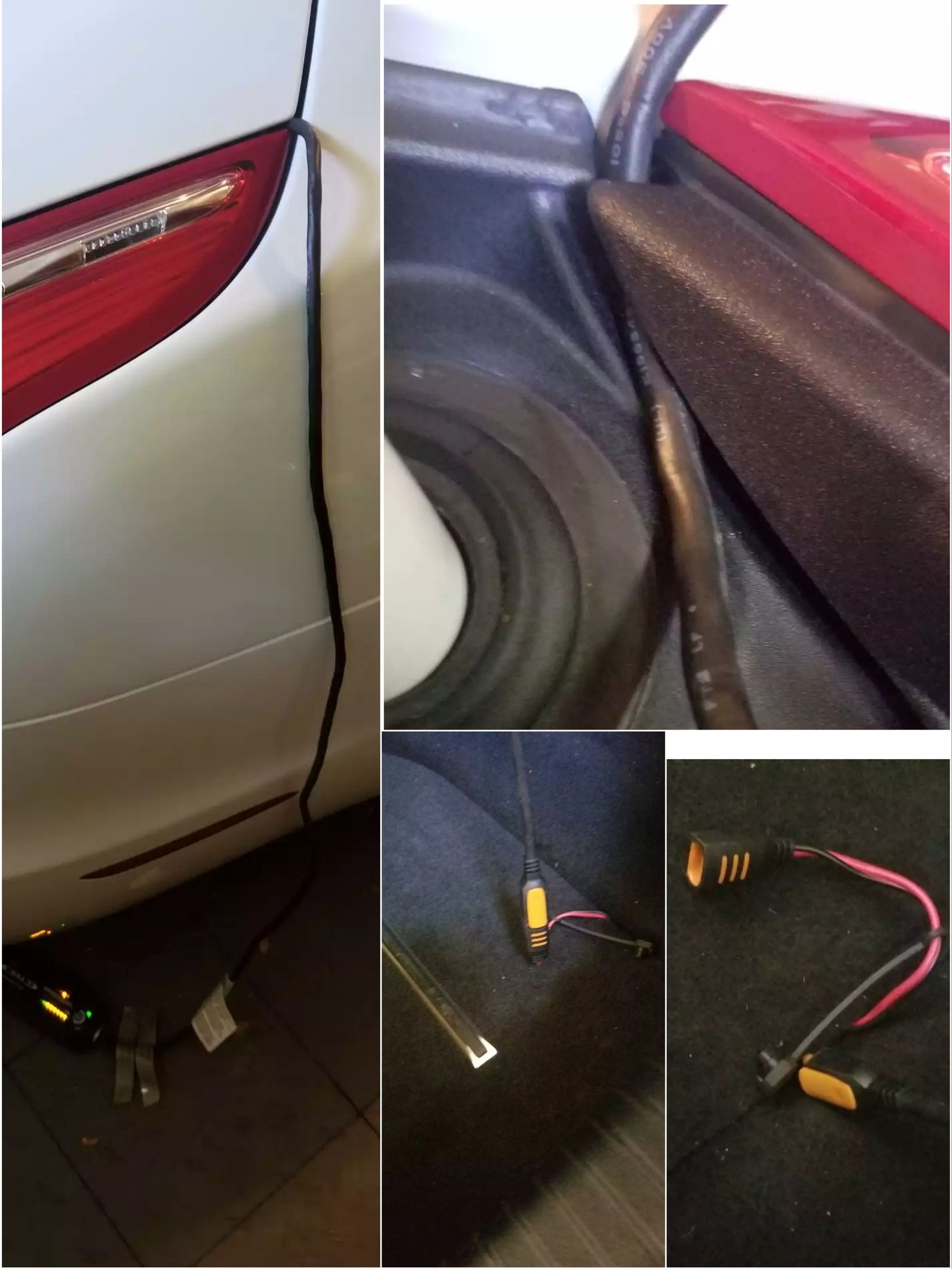

Thanks, this is what I originally did too. I also found just trailing it from the bottom of the boot opening worked okay too as the seal is rubber and it gives way nicely for the cable without leaving any marks (also an option for the lazier ones like me who just want to connect and drop the boot).

Can one charge using the connections meant for flat battery boot release under the bonnet and covered in the handbook? I'm not sure I like squeezing the CTEK cable in the boot rubber (or up by the rear lamp unit), even though that's precisely what I do with my X150... My X351 sits outside on the drive but sometimes it may be for a week to ten days, and I like to keep the battery topped up using a CTEK.

I've run a CTEK cable trapped under the boot lid seal for a while now, with the car outside, and I've not had any trouble. The boot seal is very flexible and the CTEK extension cable quite thin.

Me, too. Here's mine: I use two sets of pigtails, one for the main battery with the negative alligator clamp attached to a chassis ground on the fender and the other for the small auxiliary battery with both alligator clamps attached directly to their respective positive and negative battery terminals. Those alligator clamps are strong, and have never fallen off.
