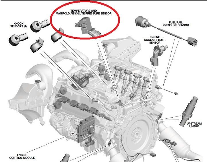

The error code is P012B - Supercharger inlet pressure sensor circuit range/performance. I know there is a variant code with a C and D at the end (low and high voltage readings) so I'm not sure how my code varies from these. In any case, I've located the one sensor on the inlet on near the top of the supercharger. I took it off, sprayed brake cleaner, let it dry and reconnected while clearing the code. Seemed to work briefly and it's back to square one. In trying to find a replacement part that is not with dealer markup prices, I've noticed this car seems to have two of these sensors (with different part numbers according to Jaguar reference)
Supercharger location reference (MAP pressure sensor): https://parts.jaguarcary.com/oem-par...Y4LWdhcw%3D%3D
Other location reference (MAP absolute pressure sensor): https://parts.jaguarcary.com/oem-par...Y4LWdhcw%3D%3D
I'd really appreciate if someone can help me find the second sensor's location before I purchase one (or both). If you guys also have a cross reference part number for replacement or any other advice, it would be GREATLY appreciated!

Is that a mistake? He had P012B and you posted P012D?
We need to make sure we are all talking about the correct sensor as the SC engines have 2.
One is at the back of the engine that Jaguar calls "Temperature and MAP Sensor".
And the other one is just called the MAP sensor and is on the front of the engine.
You will need to look at that code to see which one you need.
The part that was linked above looks to be the front MAP only sensor.
