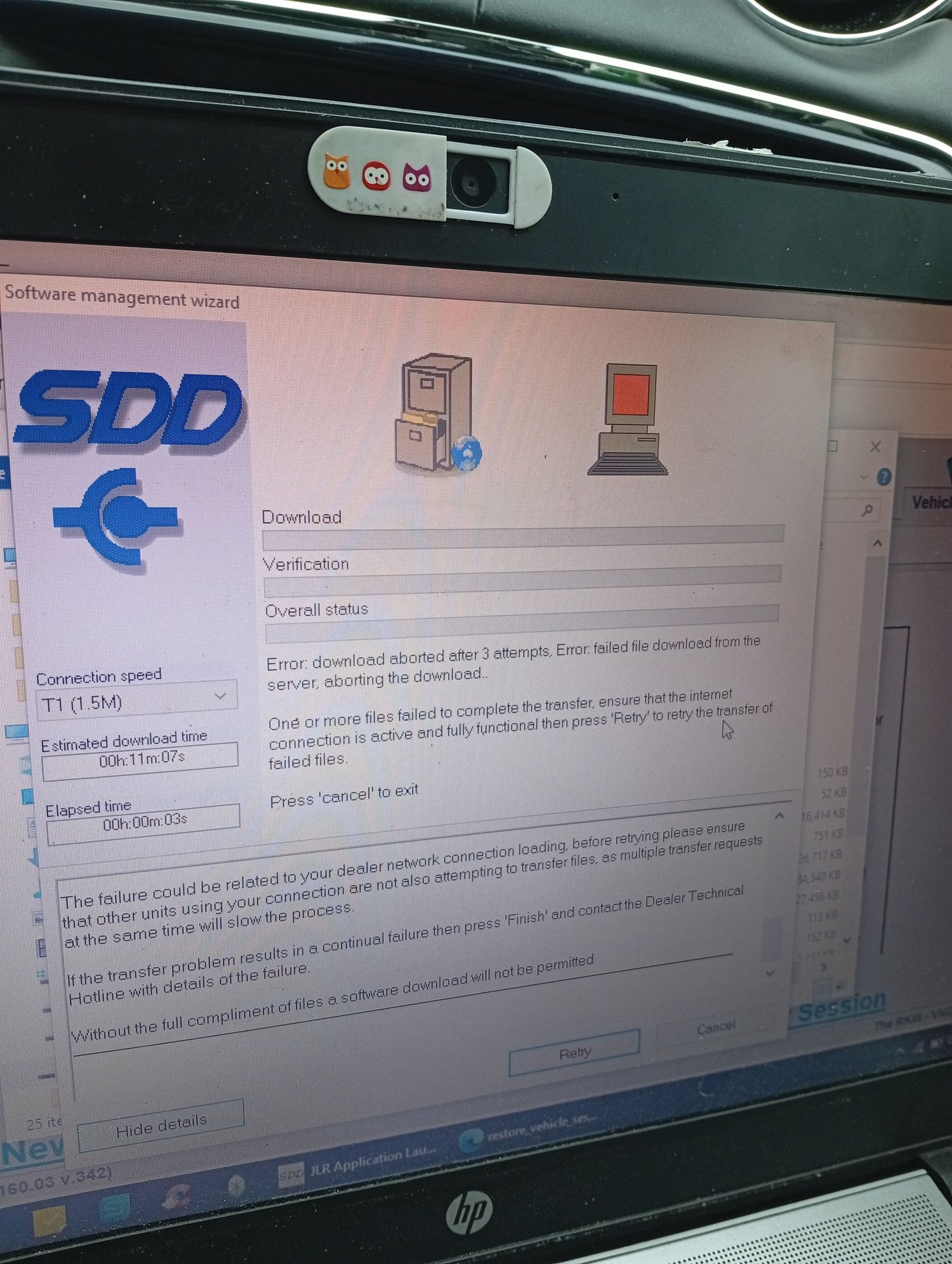

Can't update program not problem with internet anybody know how to solve this ?

Install V165 and this should fix it.
https://topix.landrover.jlrext.com/topix/ui/mylinks

V165 on a Windows 10 install with a V164 patch should fix it. JLR blocked all file downloads for earlier versions or older OS.
