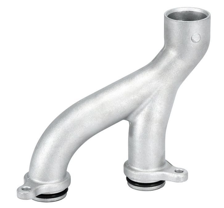

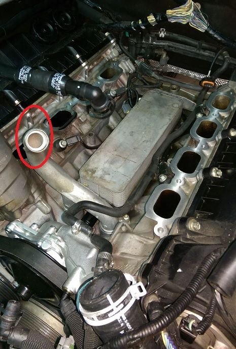

Yes I answered you on a different thread but yes your right. Originally the XJ had the 2 front cooling pipes in Aluminum BUT they had a coupler between them that failed also. So Jaguar redesigned the pipes removing the so called "crook" neck part but at the same time made the decision to go to crappy plastic and they obsoleted the original Aluminum pipes completely.
Here is a picture from the forum showing the old original style Aluminum "Y" pipe. Note the angle at the top of the "Y".
Here is the current configuration.
They don't interchange and the old stuff is NLA from Jaguar.
Here is a great thread with pictures that will really help too (That's where I stole the picture I posted!). Note the adapter at the top of the "Y" pipe is Aluminum (I in error have posted this part was plastic) but the O-rings fail causing leaks.
