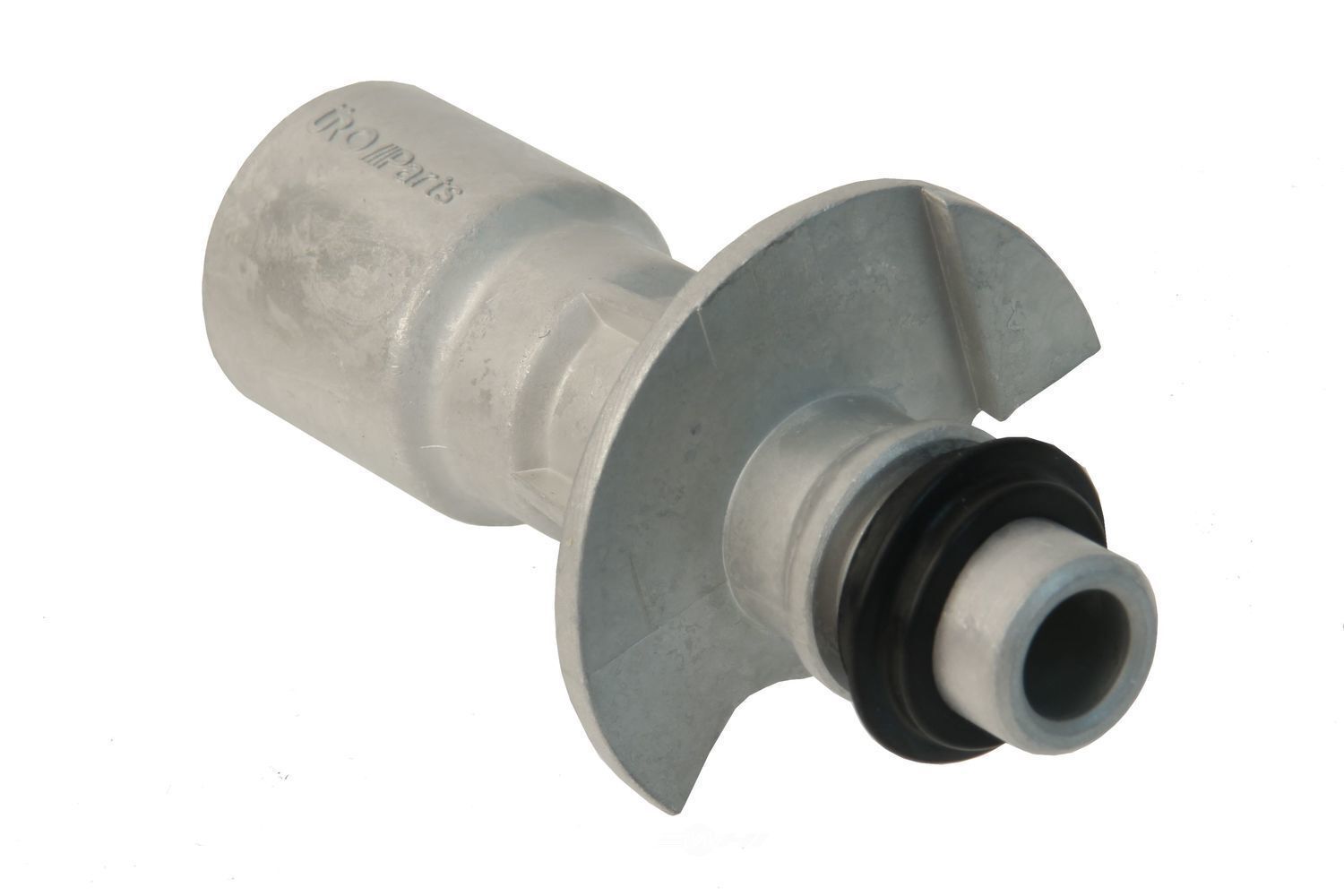

Originally Posted by NBCat
Another part that can fail is the coupler from the back of the water pump to the oil cooler, They are now made from aluminium as well to eliminate one more plastic part.
That's this thing right here correct?
Old Jun 27, 2023 | 05:28 PM
NBCat's Avatar
Posts: 6,068
Likes: 2,983
Originally Posted by silvertonesx24
Yes
