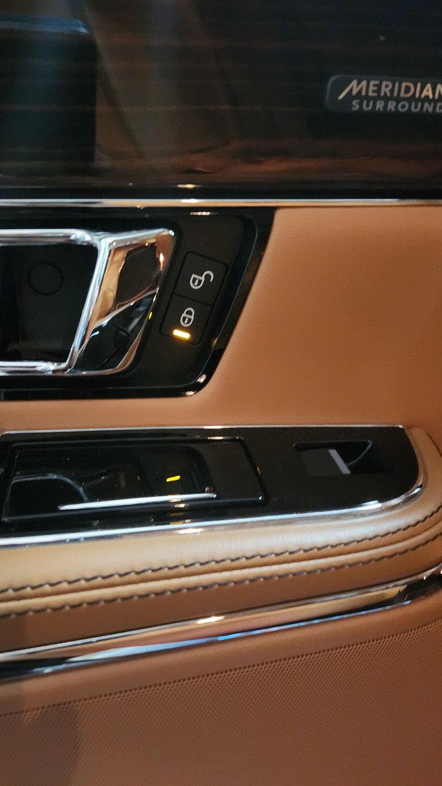

I do not have that SDD but I do have a scanner that works for Jaguar only and it showed a code: "B1109 Passenger's door central locking motor". Also I got into the car and saw the door lock light was illuminated and I was unable to open the door from the inside door handle. Pressing the unlock button on the offending door or on the other rear door did not resolve the lock light either and at this point, the only way to open the door is from the outside when I have the key fob in hand. It's like a child safety lock out is enabled. I cleared the code but the lock problem remains.
The lock light stays illuminated.
