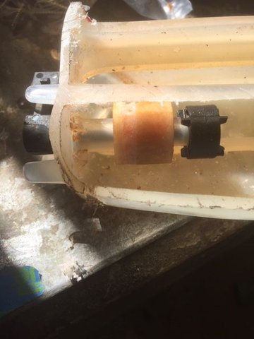

The low coolant warning on my 2013 XJ came on about 2 months ago. My first thought was a bad sensor, and so i replaced the tank, but the warning remained on. I did a host of troubleshooting. I verified that the connection to the computer was working properly by using a small gauge wire to short the the signal (wire inserted into the sensor female plug pin holes); results: shorting = no warning message, no shorting, i.e. open= yes warning message. I then checked the sensor. I knew that the sensor operated using a float which had an 'open circuit' when the float was down (i.e. 'dry condition'), and closed when the float was raised ('high liquid level'). I knew this by two methods: 1) i cut the old sensor out of the tank and tested it with a ohm meter 2) I tested the new tank's sensor using the same ohm-meter and using a stiff wire inserted through the fill hole to move the sensor up and down and confirming a open-when-down, and closed circuit-when-up.
Everything checked out electronically, so i tested the theory that somehow the coolant had gotten watered down and caused the float to remain permanently down (very skeptical of this). But, using the sensor i had removed, i tested it in two solutions, one water and one fresh 50/50 coolant. And indeed, the float did not rise in water, but did in the correct 50/50 coolant - yikes! But how did my coolant change? I speculate that when i took it into a quickie oil change place two months ago, they must have done me the favor of topping off the coolant with water - HA!
Also, i include a pic of the the sensor i cut from the original tank for inquiring minds.

The warning became consistent so I eventually got around to checking it out. With the car cold, I removed the coolant fill cap and shone a flashlight through the tank and looked down into the fill orifice. I could see the black top of the sensor (see jwbenn's photo in this thread). I could also make out the off-white float beneath this black top. I fashioned a hook from a piece of light copper wire and fished around for the bottom of the float. I was able to "pull up" on the bottom of the float and make the float rise. Since the float was fully submerged in coolant, this verified that the float was no longer buoyant.
