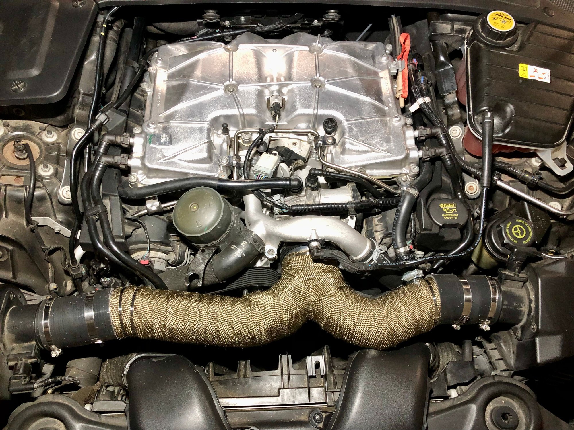

Yesterday I completed installation of the Mina intake tube to my XJ 3.0 AWD at 136k miles. My stock intake was partially melted during a cooling vent hose leak at the beginning of the year, so I figured an upgrade was in order.
My feedback is mainly around providing a step by step install recommendation. It took me nearly 3 hours of trial and error instead of 30 minutes I had hoped! I also chose to install titanium fiberglass header wrap to keep the intake temperature down. I learned from others on here that the intake temperature rises with the aluminum pipe. Mina recommended keeping the wrap off for aesthetic value and that header wrap was only needed if the pulley upgrade and tune was ordered with the intake. My key installation learnings were:
1) The center rubber hose connection needed to be installed first since it fit very snugly compared to the stock intake.
2) Then getting the center tube inserted was next most important, although I was unable to insert to full depth due to the driver’s side air box connection.
3) The back of the intake tube rubs on the drivers side intake funnel pretty well during install.
4) The clearance of the passenger side tube is close to the supercharger pulley but no contact so all good.
5) I cut the drivers side vent hose connector to length and secured with a plastic zip tie around the connector.
6) I left the passenger side rubber cap on the small vent tube. My stock intake was plugged here.
So far it sounds a bit different, and my butt dyno feels like the car has a bit more pep early in the rpm range. My intake temperatures are in line with my previous stock ranges after a couple highway trips, but I need to test it around town as well. Now I’m hoping to install some K&N high flow filters to the air boxes to help a bit more with intake temps.

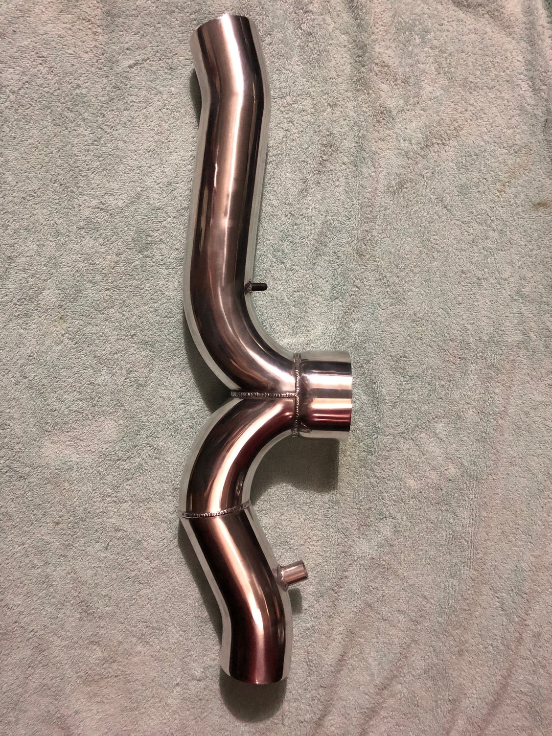

**Below is the installation order from Mina’s experts after I asked:
We make a lot of intake kits for the Jaguar model range and the V6 models have the tightest and most tricky setup. The placement between the throttle body and air filter boxes is pretty unforgiving. 1. Take off the factory parts. 2. Place the throttle body coupler and clamp down to the throttle body. 2. apply some lubricating spray on the very edges of the right and left tube and slide the 2.75" straight covers over the tube. 3. push in the tube's center pipe into the center coupler, but do not tight down. 3. position the tube so it gets are close to the maf sensors as possible (it will likely will not line up exactly, but as long as its close). 4. slide out the couplers and connect to the right and left maf sensors. The air filter boxes have a bit of give and can move slightly to allow for a connection. 5. clamp down the right and left couplers. 6. clamp down the second throttle body clamp. 7. lastly use the provided black hose as a union between the factory breather hose and the new tube's breather connection. It will likely be longer than needed to mark and cut. I know this is a lot of information so if you have questions please don't hesitate to contact us.

I meant to include this image of the slick polished aluminum Mina Gallery intake before I soured it with heater wrap!
