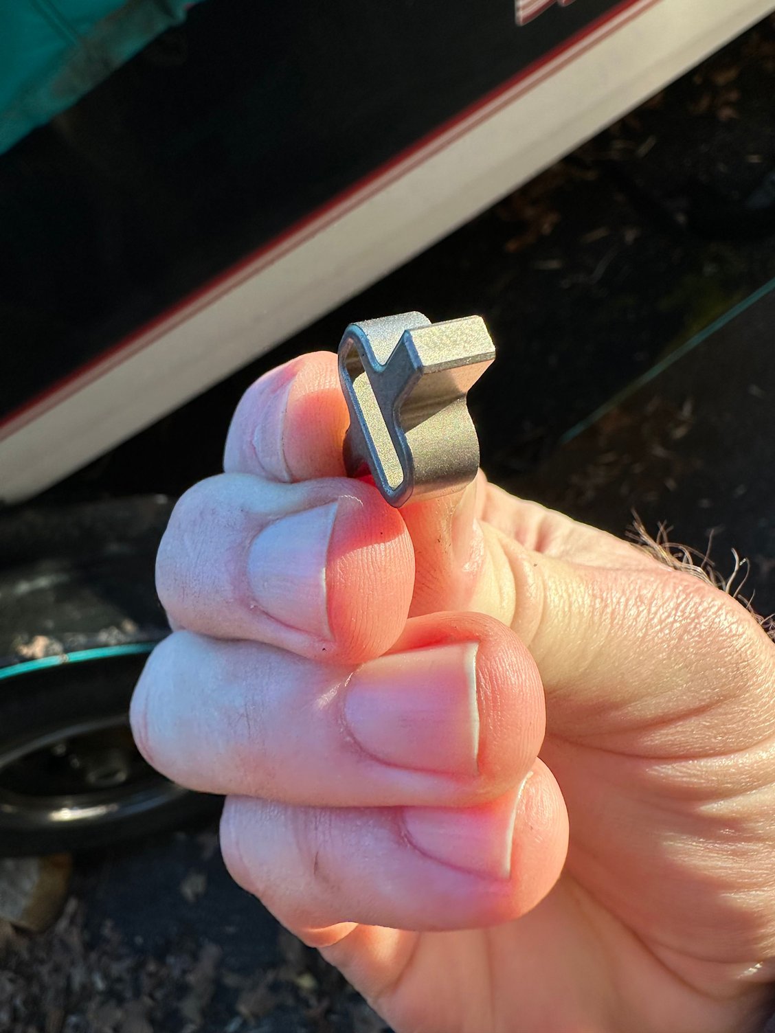

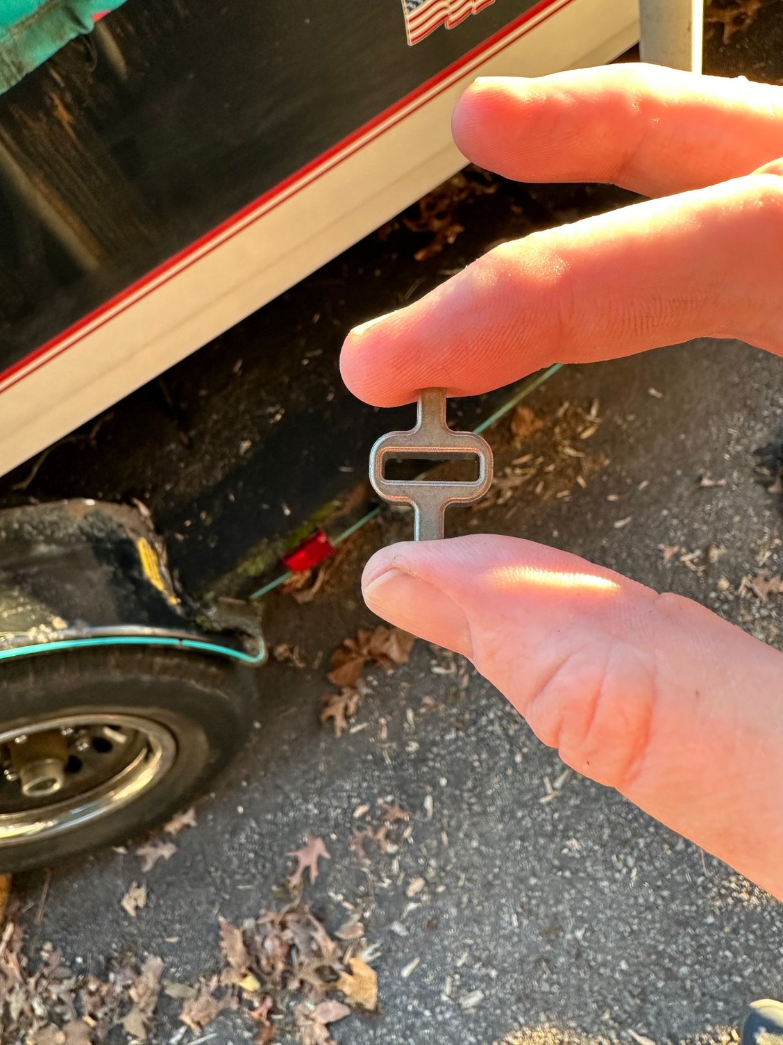

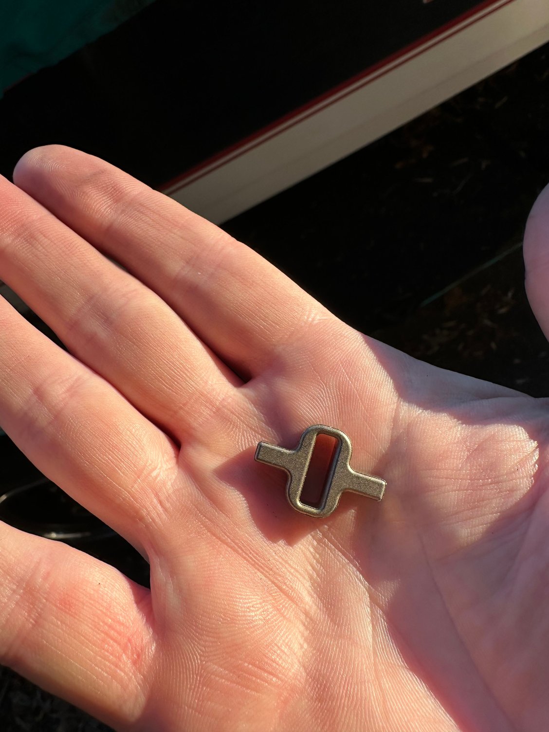

Need help I removed my supercharger and this piece fell out and I don’t know where it goes (see attachment)
thank you

That's odd. I don't remember seeing that piece when I did the coupler change 6 months ago. I am doing it again this weekend, so I will take a look around for it. But I wonder if it was just a piece that randomly fell in the area of the supercharger and is not really part of it.

Just got off the supercharger on our 3.0L and removed the snout, and there's nothing I see that looks like that part.
That part looks oddly new and unused with no witness marks which further makes me think it's just something that fell into that area.

I found that piece that fell out in this video at 37:05. You definitely need it!
