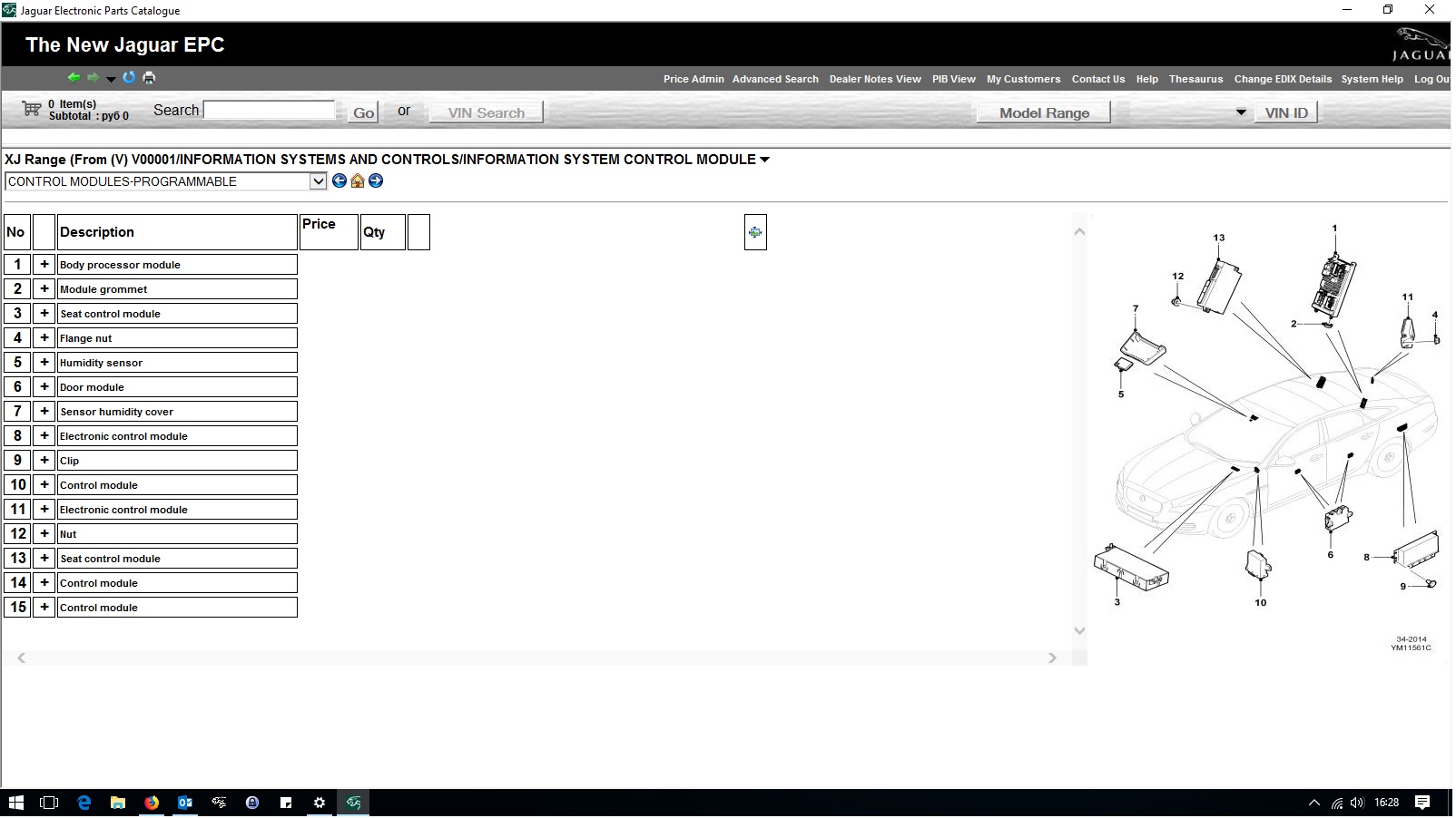

Hi guys,
Does anyone know of any diagram which shows the location of the main modules of a Jaguar X351 5.0 V8? Any help would be greatly appreciated
Welcome to the forum gimbli,
The diagram in JEPC (Jaguar Electronic Parts Catalogue) is the simplest location overview.
The online TOPIx Workshop Manual treats each module individually and in detail and generally assumes knowledge of the approximate location.
