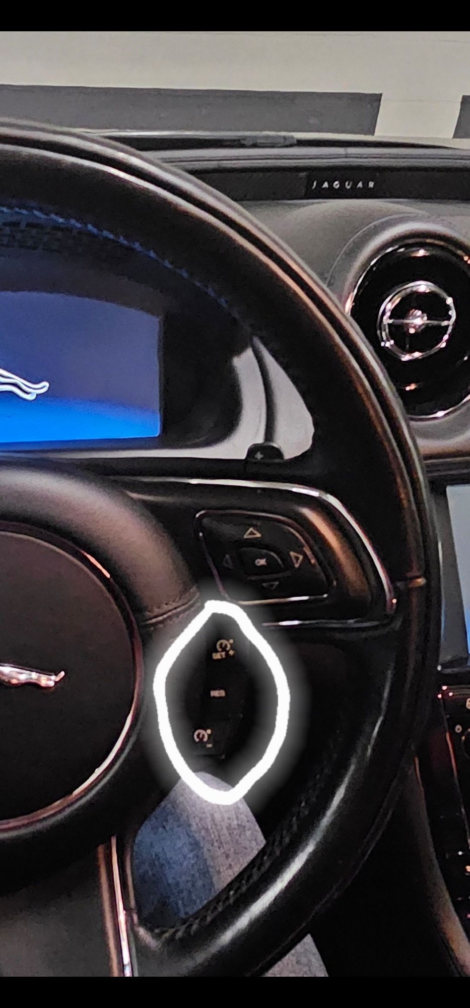

I have these boots and behind them three other buttons that are to get me closer or away from the car in front.
The + button will get you closer to a car in front of you, but the problem is that since there is no radar and no adaptive cruise control it'll run you into the rear end of that car in front of you.
Those buttons allow you to set/increase or decrease cruise control speed, or to resume cruise control after interrupting it such as stepping on the brake pedal.
I don't know what other buttons you are describing other than the CANCEL paddle and the manual shift paddle(s).
Have you tried to find an owner's manual for a reference of what the different controls do?

I'm referring to these 3 buttons at the bottom behind me, where it says CAN, that's what makes me move away from or closer to the car in front

It should be under the bumper bar, here is a link to some additional information.
2009-2012MY used the exact same setup as the X350, XK, and earlier (pre-facelift) XF. It is referred to as a GEN 1 system. You have the sensor mounted lower left under the bumper bar and an internal ECU that handles the logic side.
C2Z9500 is the sensor part number and C2D13346 is the bracket, you can Google those to get an image of what to look for.
