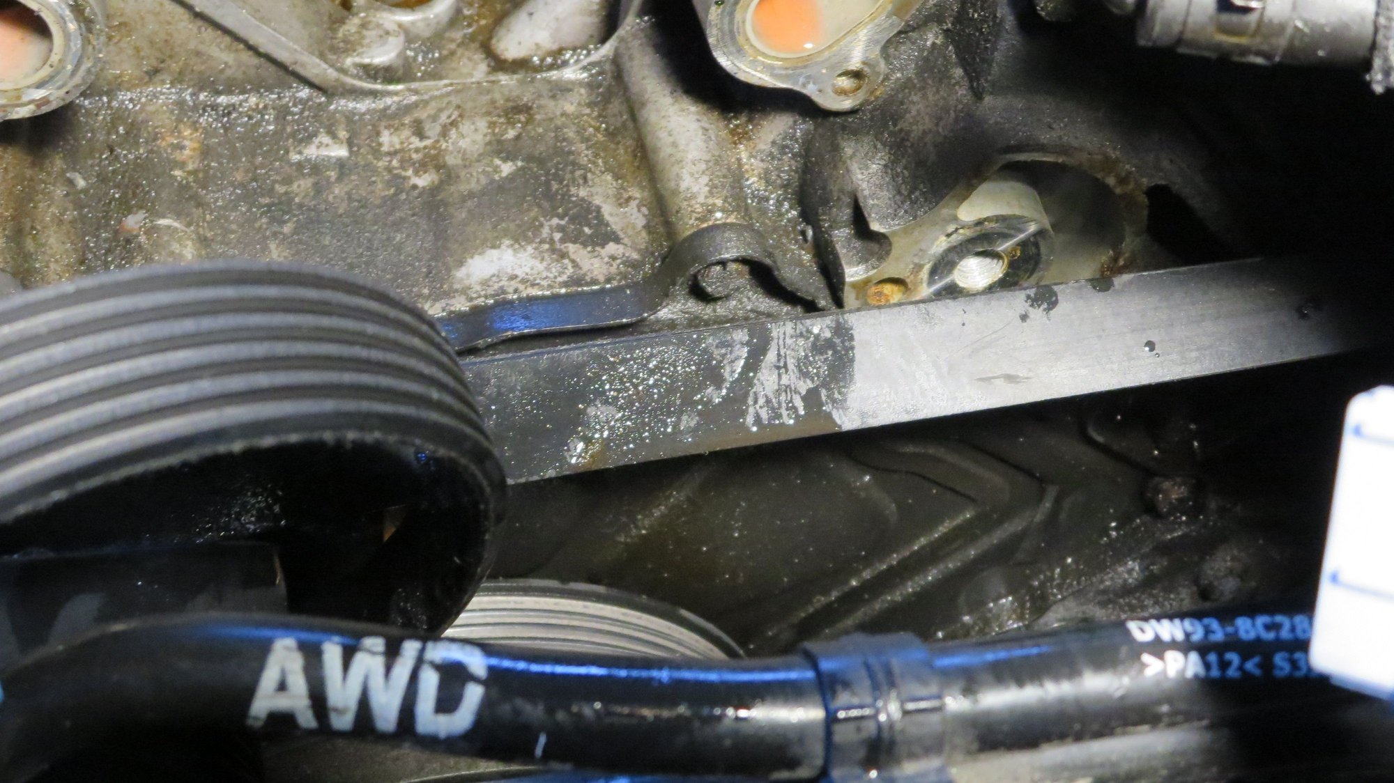

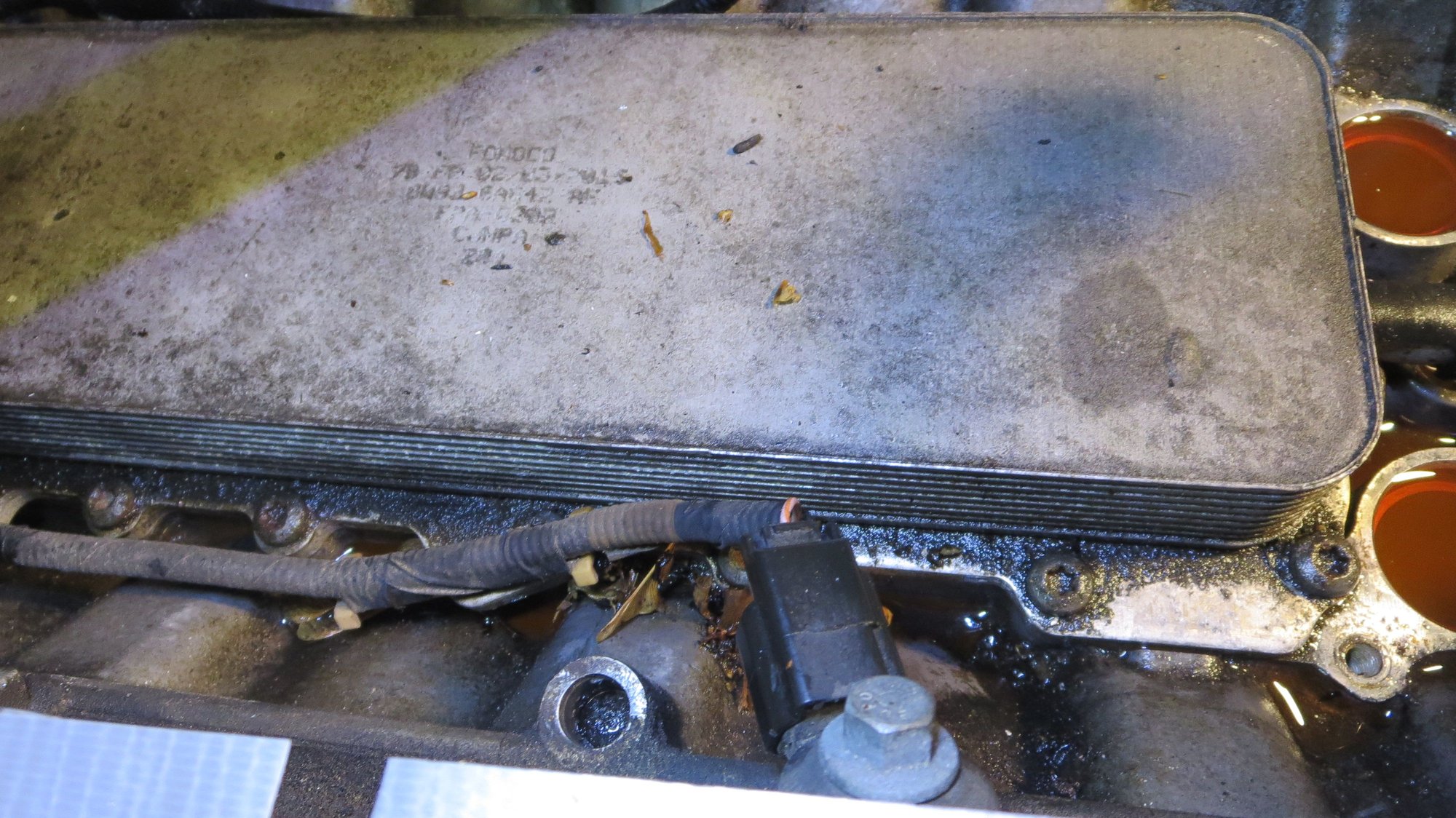

I think my oil cooler might be leaking oil
Is it possible to tell if its the cooler leaking or the gasket?

I can't recall a report of the oil cooler leaking, so it is almost certainly the gasket (Part 3). You should also replace the two coolant O-rings (Parts 2 & 6):
When the engine is running, pressurized oil can squirt out against the block and heads and splash back onto the cooler. The oil runs down from the sloped sides of the block and heads into the valley, but splashed oil collects on the horizontal flange of the cooler.

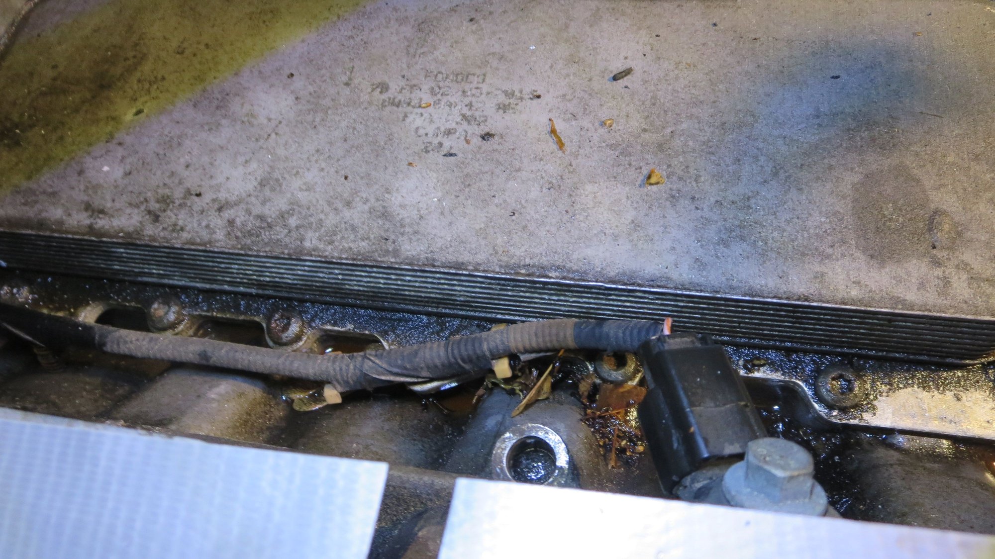

Replaced the cooler gasket today could not see anything wrong with
I did have coolant pour out and go into the engine now I will have to change the oil
the new one left side old one right side

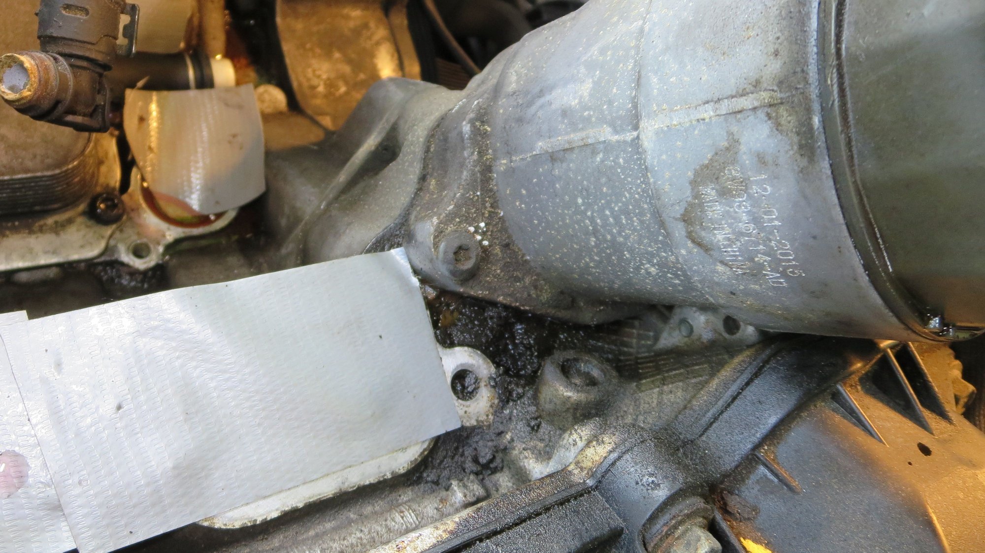

The oil leak could be from the valve cover or Oil Filter Adapter Gasket / O-Ring

if your valve cover gasket was never changed you are approaching the 10 year mark, and that is usually the first
to leak. I would clean that area thoroughly and re-inspect
