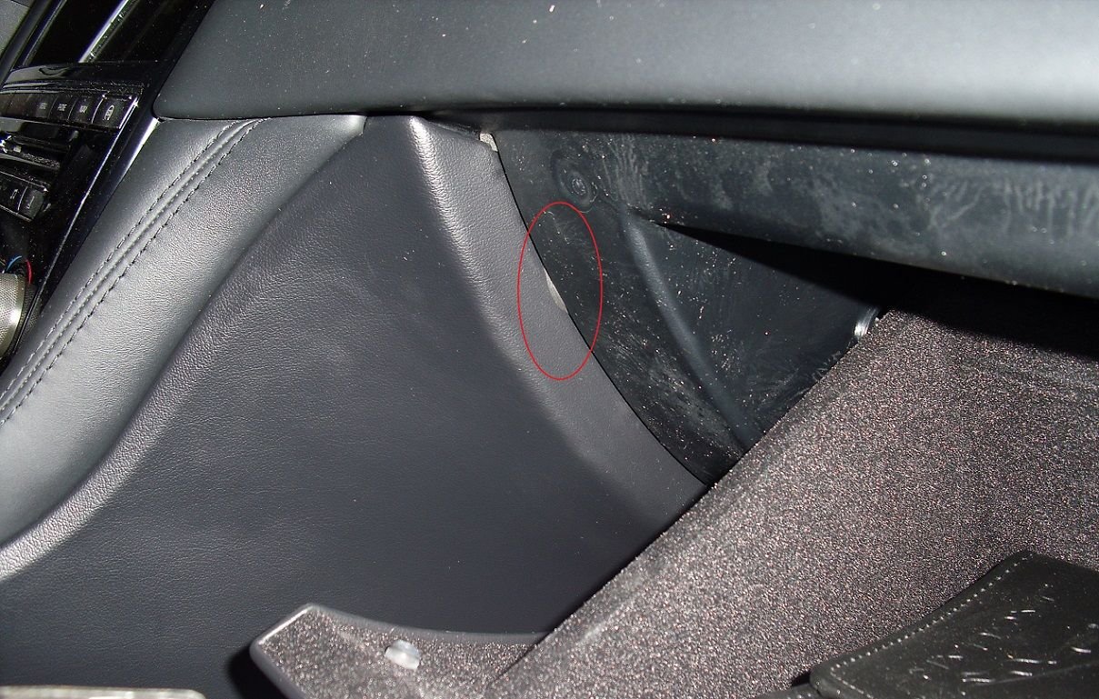

Had a buzz like sound on certain surfaces in my 2014. Finally got the wife to drive me around while I checked the passenger side.
Found the console side panel rubbing against the glove box on the inboard side of the glove box. I circled a bit of the black foam I stuffed in the gap to quiet it down. Surprised I found it to!
Attached Thumbnails Passenger Side Dash Rattle Fixed-glove-box-rattle-fix.jpg
