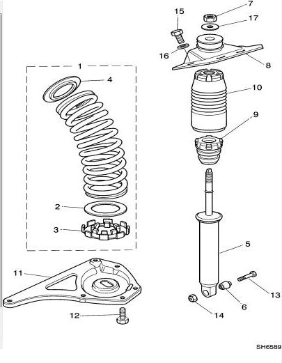

Here are the Front Suspension Diagrams:

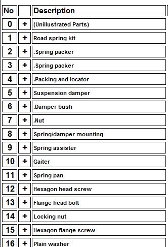

yes yes. thanks. #9 part in the third picture is what I'm talking about. the spring assistor. what is the function/purpose of that part? and what happens without it?
Old Jun 24, 2012 | 09:06 PM
jimlombardi's Avatar
Posts: 2,636
Likes: 1,636
From: Southington CT
Hi
The part number for the Spring Assister is MND2150AB (also called a shock bump stop), Jaguar retail price is $18.05, Gaudin Jaguar parts discounted price is $14.80
I also found this article on shock bump stop on the internet:
"The main purpose of a bump stop is to serve as some final suspension cushion to keep the metal parts from coming together or from traveling too far, which might in some way damage the suspension or chassis. In the case of a coil-sprung suspension, you'll want the bump stop to stop movement before a condition know as "coil bind," in which the coil spring is completely collapsed and can compress no further.
This is a good time to have some kind of effective bump-stop action at the front axle. There's a lot of motor weight bearing down on the front end, and if the suspension bottoms too violently, something is bound to break sooner or later.
Consider also that a bump stop used in the final bit of travel in a suspension behaves much like a variable (or rising rate) spring. This allows a vehicle to use a softer spring rate than would normally be needed if there were no bump-stop control. Using a bump stop allows the suspension to soak up large bumps while still allowing use of that soft spring for normal suspension travel conditions."
