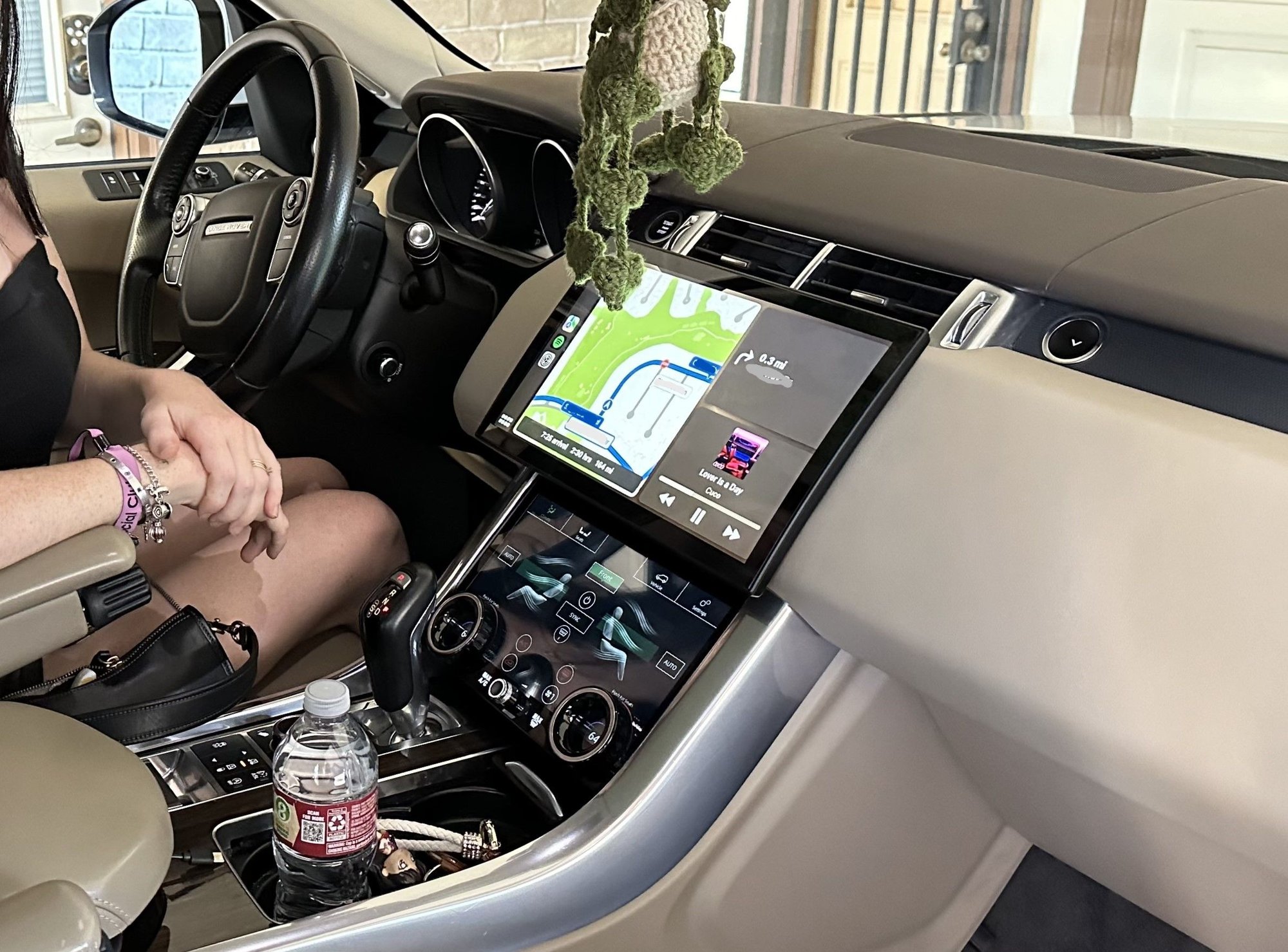

My 2019 has Apple CarPlay activated from the factory on the 10" screen, which is awesome. But I just did the 13" aftermarket screen upgrade on my daughter's 2014 Range Rover Sport, and I have to say it's definitely worth it to upgrade to these aftermarket screens. With the unit I purchased, the original circuit boards are maintained from the factory system, and when needed, the video feed from the old screen is sent to the new screen. That way everything OEM works for controlling the car, including the backup camera automatically coming on as soon as the car is put into reverse.
We also upgraded the climate control panel, so the whole center stack looks like a 2024 RRS. They have that upgrade for the XJ as well. For the RRS, you have a choice of aftermarket screen that are integrated into the dash, but my daughter wanted the newer tablet style that is much more common in today's cars. For the Jag, I haven't seen a tablet style, nor would that look good anyway, so you would get a version that looks much more OEM, like my 2019.
So if that's the perfect car for you otherwise, I wouldn't hesitate to pull the trigger and do an aftermarket infotainment upgrade. It will give you a lot more functionality that you get from the factory unit as well, because it will have other Android apps like YouTube. There are threads on here covering the aftermarket screens.

I bought the Range Rover's CarPlay unit from Android Aftershock (https://androidaftershock.com/). The owner's name is Ray and he imports from a supplier in China and resells and supports them in the US. Local support and his testing the products before selling them is why I went with him. He's well known in the RR community. You can probably spend less for the same thing if you can find out which of the many sellers on AliExpress are selling the same unit. I couldn't figure it out.
The climate control panel came from Amazon, and it is excellent, despite the negative reviews. The negative reviews are actually for the CarPlay unit they sell on the same page and not the climate control panel. The panel is in English and in Fahrenheit, which is not a given. Some of the units sold on Amazon only come with Turkish language! We don't have massage seats in the RR, so it's not an issue for us, but it seems none of these digital climate control panels for either the Jag or RR support massage seats.
Amazon Amazon
I'd give Ray a call at his number before ordering, and also ask him about the XJ because I see F-Type and F-Pace units, but nothing for XJ. He can probably get it though.
