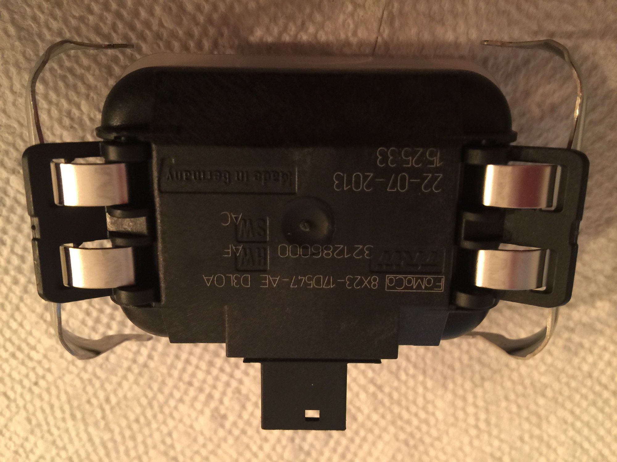

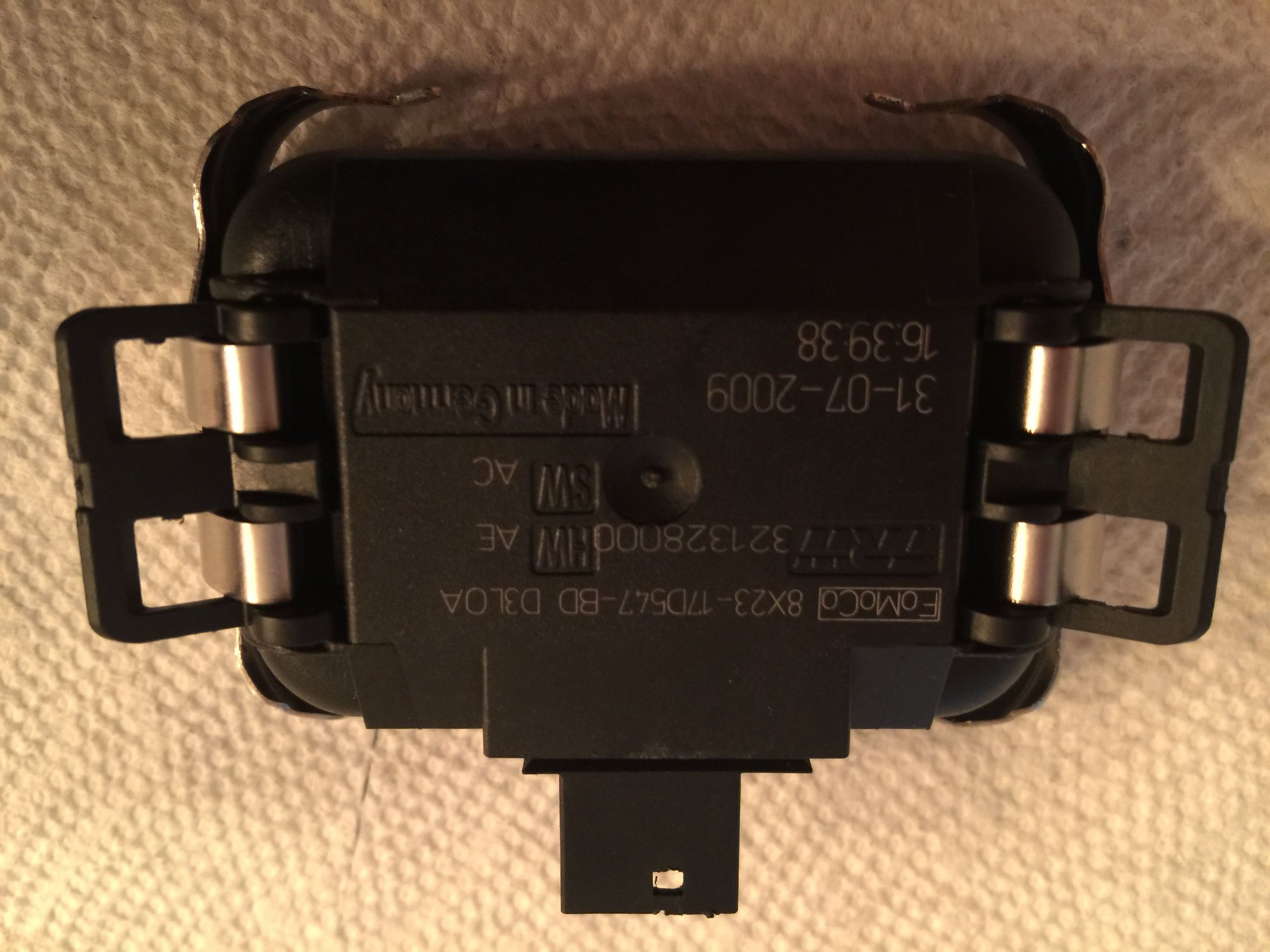

Okay I got the part in and plugged it in. It appears identical.
New Landrover part
Old Jaguar part

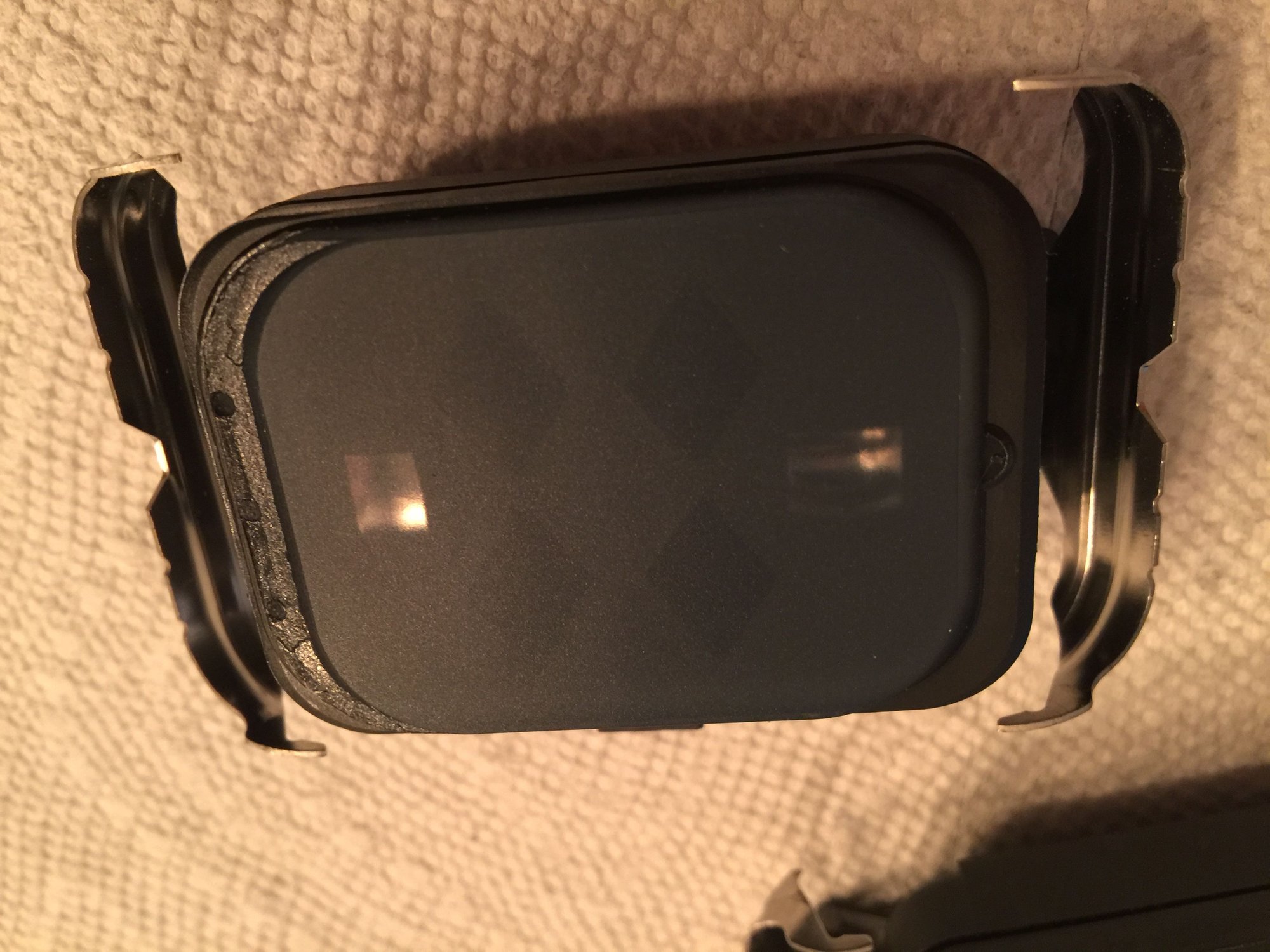

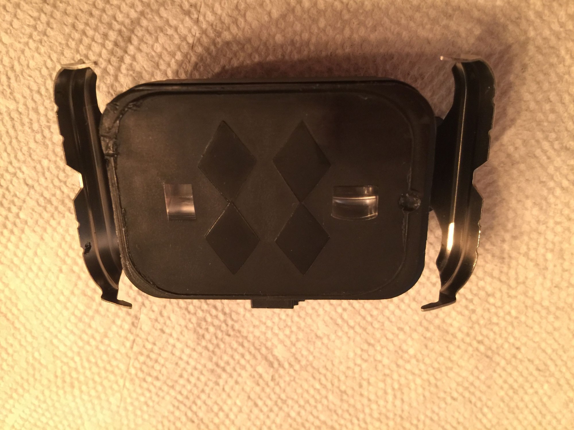

Though now I’m thinking I screwed up. There is a small scratch on one of the old sensors, but it doesn’t seem big enough to be the cause of the problem. The big issue is the lack of silicon gel on the old sensor.
Old part, no gel on the front
New part has gel over the sensors.
So it appears the gel is supposed to make an air-tight fit between the windshield and sensor. The previous owner likely changed the windshield or something and didn't put a new gel on the sensor. I now see that a bunch of aftermarket replacement gel pads exist, but don’t know how well they work.
