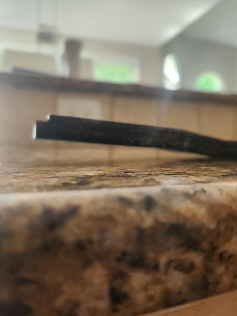

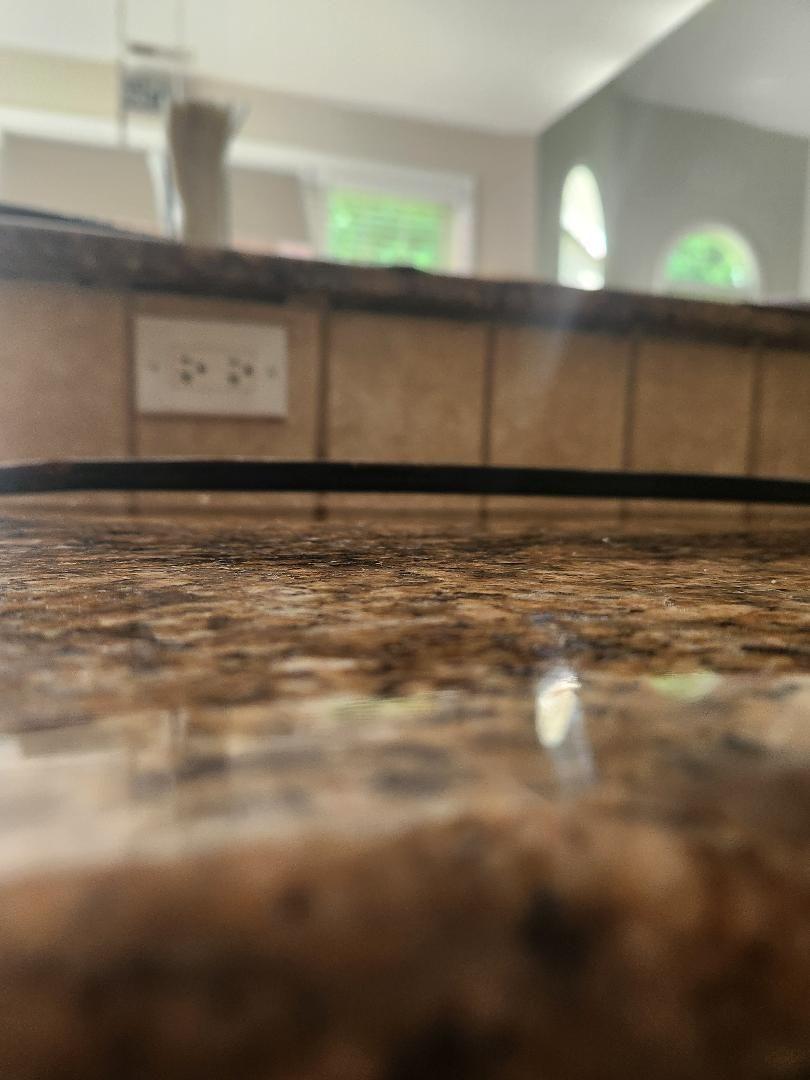

Barak, hello from NC. Hey, I have followed your repair scheme here. Need your help. Is the stabilizer bar #C2D10278 perfectly flat? (In the pics it is item #2) I ask because I bought one from eBay and it is NOT flat to a table top? The first pic is the end of the bracket and the other is the black line in the middle of the pic and is some 3/8's of an inch off of 180 degrees flat. Help!!! Can you let me know?

GRIFF, Hello from NC. Hey, I have followed your repair scheme here. Need your help. Is the stabilizer bar #C2D10278 perfectly flat? (Item #2 in the diagram) I ask because I bought one from eBay and it is NOT flat to a table top? Can you let me know?
Hi NC, I would say your part will be much better than the rusted/oxidized part you are removing, and you should be able to torque your bolts down to help straighten the part against the undercarriage. My only concern would be alignment of bolt holes, but I think 3/8” is doable.

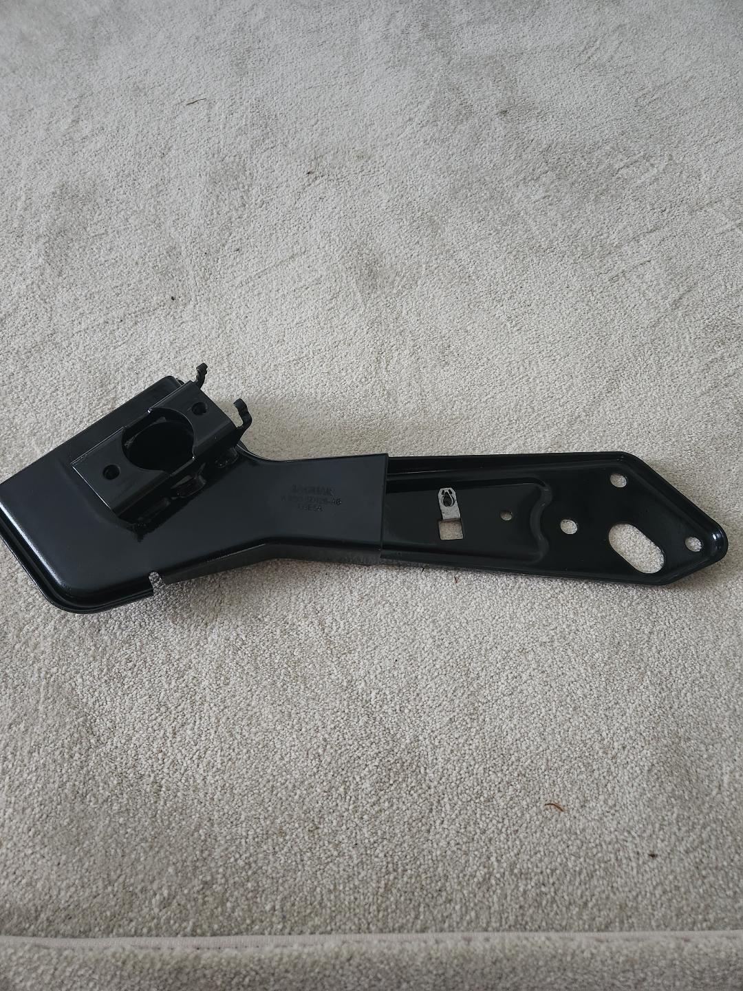

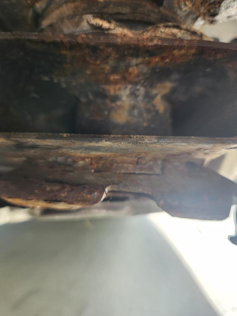

Griff, this is what I am doing now. The rear, subframe, brace bracket extension. Mine is bent from an accident and it is compressed in pic #1. The new one is pic #2. When you replaced yours, did you have issues with the bracket being under tension? You mentioned this "captive nut" in a bad place. My X351 is a 2015 am I facing the same issues or is this extension bar an easy fix?
jaguarguy100, replacing this part is supposed to be easy unless you encounter the rust damage to the captive nut in the subframe. To prevent breaking this captive nut free from the frame mount, I suggest a generous bath in lubricant to loosen things up!
