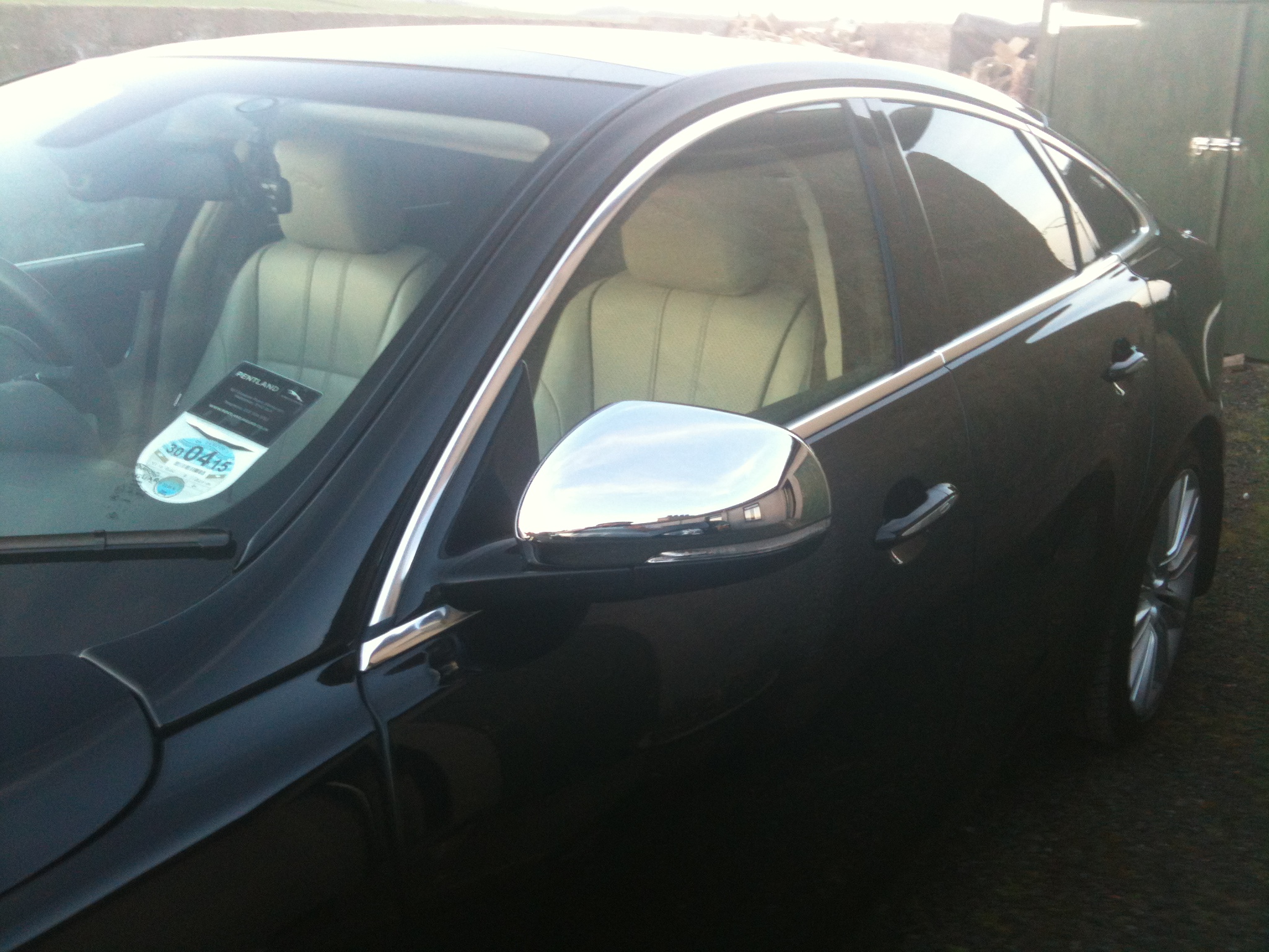

The ones I got just stuck on over painted caps. There was thin strips of 3M on the inside of the caps, that's double sided foam tape.
Attached Thumbnails Replacing Painted Mirror Caps with Chrome-img_0335.jpg   Replacing Painted Mirror Caps with Chrome-img_0364.jpg
these look great on a black xj 👌🏾
