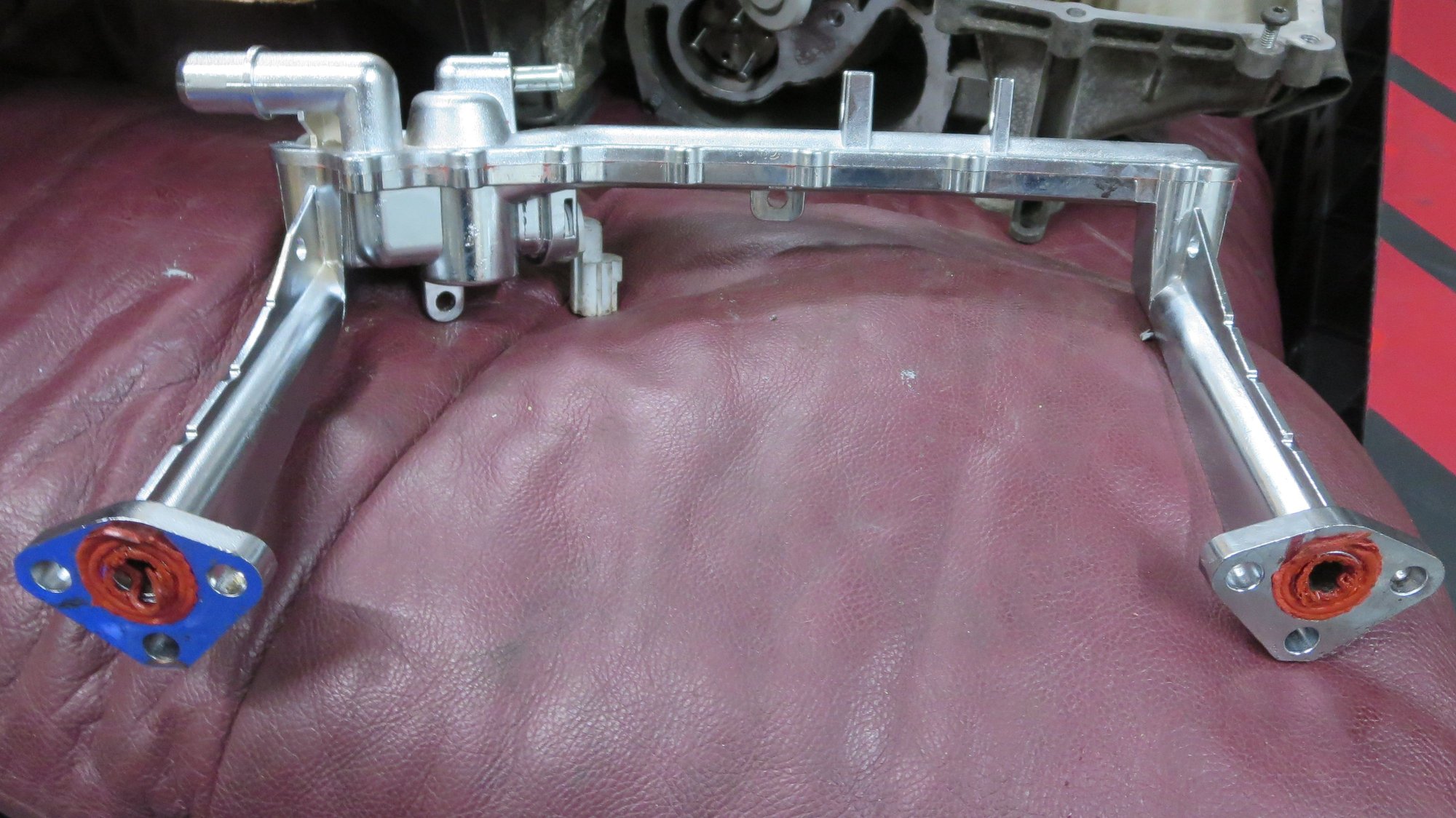

Here’s bad experience I had with aftermarket aluminum parts the gaskets turned into mush after just a few drives. I removed it and installed an OEM part instead.

That … looks like someone played FAFO games with RTV. The aluminum coolant pipes are a worthwhile upgrade, but definitely pair them with stock/factory O-rings.
