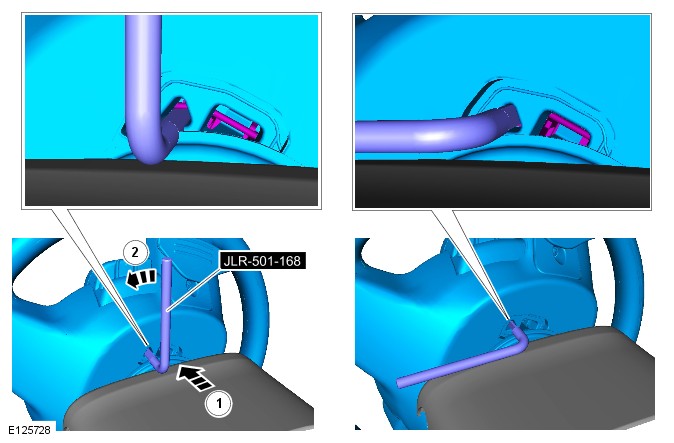

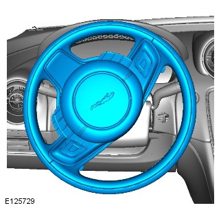

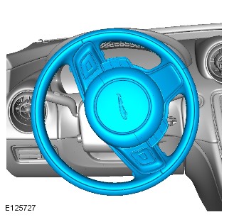

  1. Refer to:Startup Battery Disconnect and Connect (414-01 Battery, Mounting and Cables, General Procedures).
  2. NOTES:
    • An audible click can be heard when the airbag module has been released from each side of the steering wheel.
    • Gently pull on the side of the airbag module which has been released until it has been withdrawn sufficiently to clear the spring clip.
    Special Tool(s): JLR-501-168
  3. Remove the special tool.
  4. NOTES:
