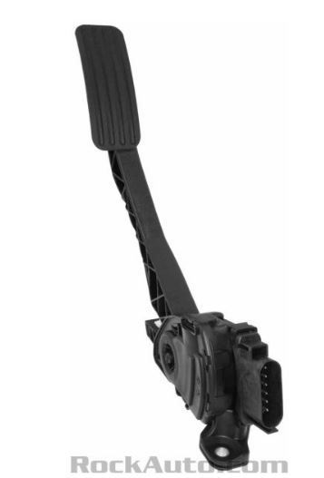

On the other hand, it could be the accelerator pedal assembly which is a replaceable part (and shouldn't be too difficult, other than contorting to get inverted down into the drivers floorboard).
Price and availability are a function of where we are, and while I can't speak for the situation in Dubai or Abu Dhabi, IIRC, you can find anything in the souks.
Over here in the US we have a few good on-line sources, here's one for example with a few reputable brands of aftermarket accelerator pedal assemblies:
2012 JAGUAR XJ 5.0L V8 Accelerator Pedal Position Sensor | RockAuto
But then I also find the genuine Jaguar accelerator pedal assembly (part number C2D20663) from an on-line Jaguar dealership (again, in US) that I use with the price that's below $200 US - in the middle of those aftermarket options.
