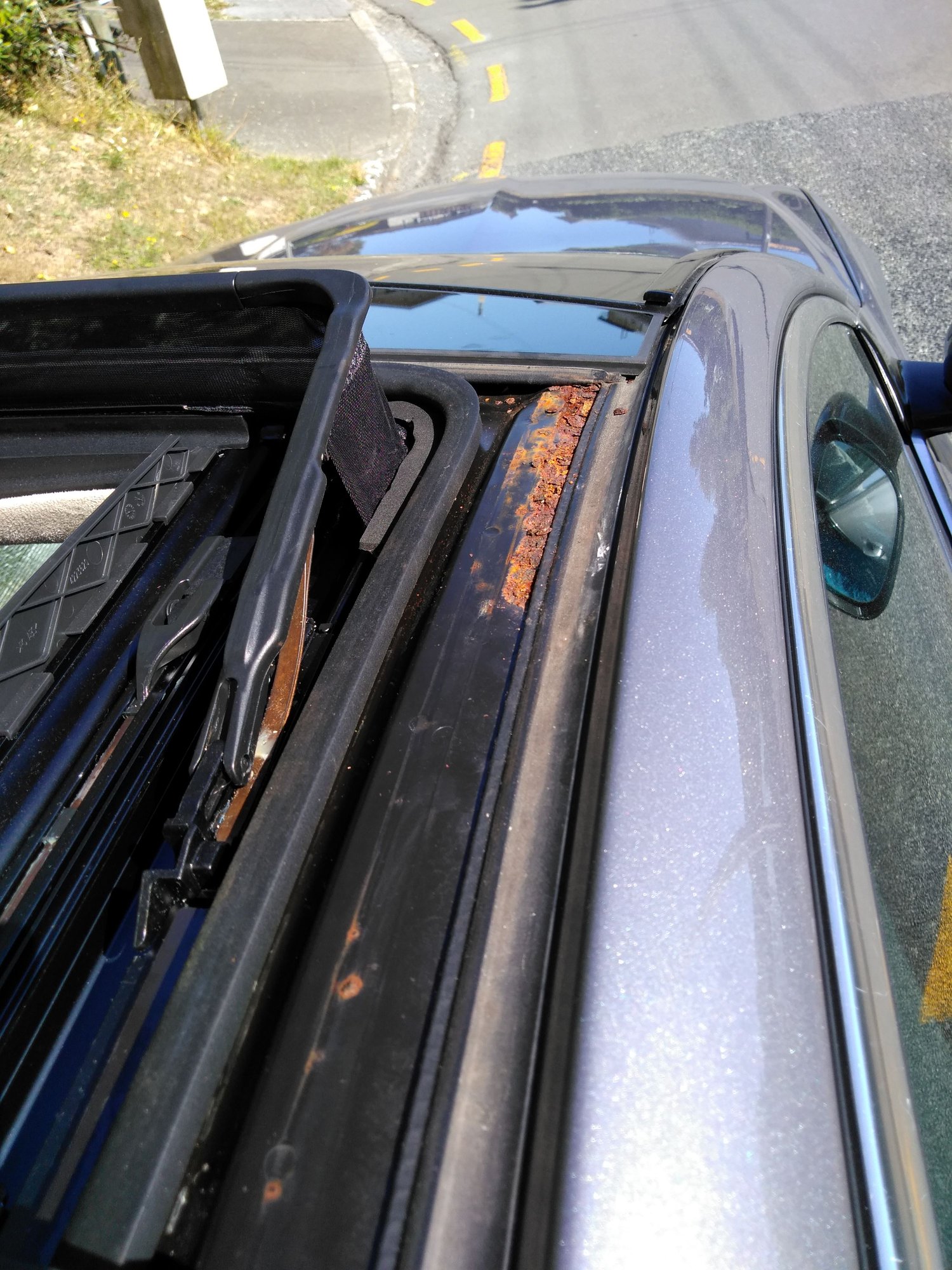

Hi fans,
My 2011 XJ portfolio (5.0L naturally aspirated) has the dreaded rot in the sunroof frame which goes up under the forward seals. Plenty of discussion on it but am wondering what's involved in removing this subframe. Not been able to find sod all. Have gleaned info on removing the glass panels but how is this sub frame secured to the car? Am going to import a replacement frame and have a panel shop do the work. Obviously staying away from anything from MY10-11! Thanks in advance.

Here is the workshop manual section detailing how to remove the frame. Not a job for the fainthearted!
https://db.tt/Siufd9Pn4b
