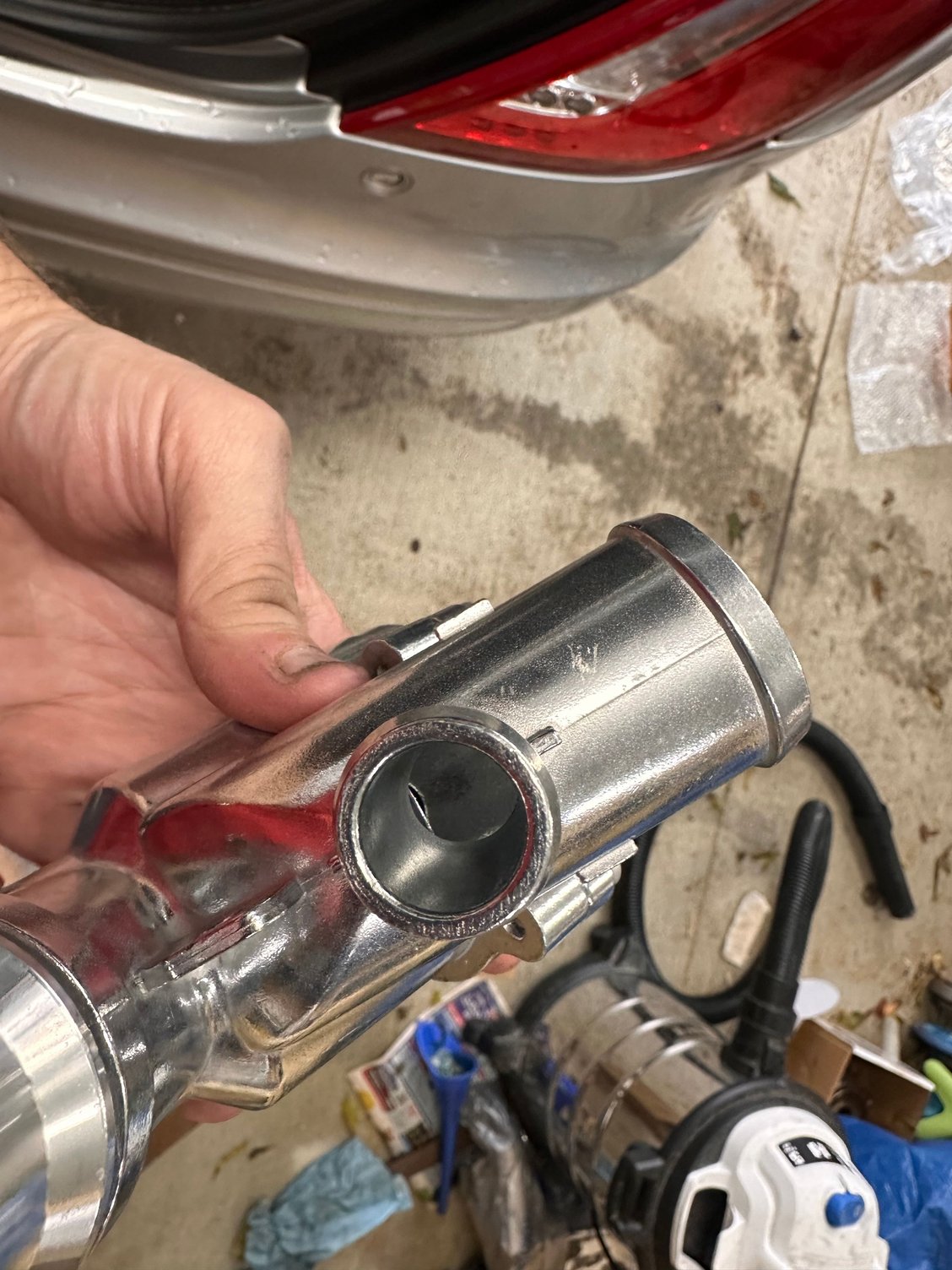

I will take photos of the two units side by side when I remove it... I may as well have the correct unit I guess.

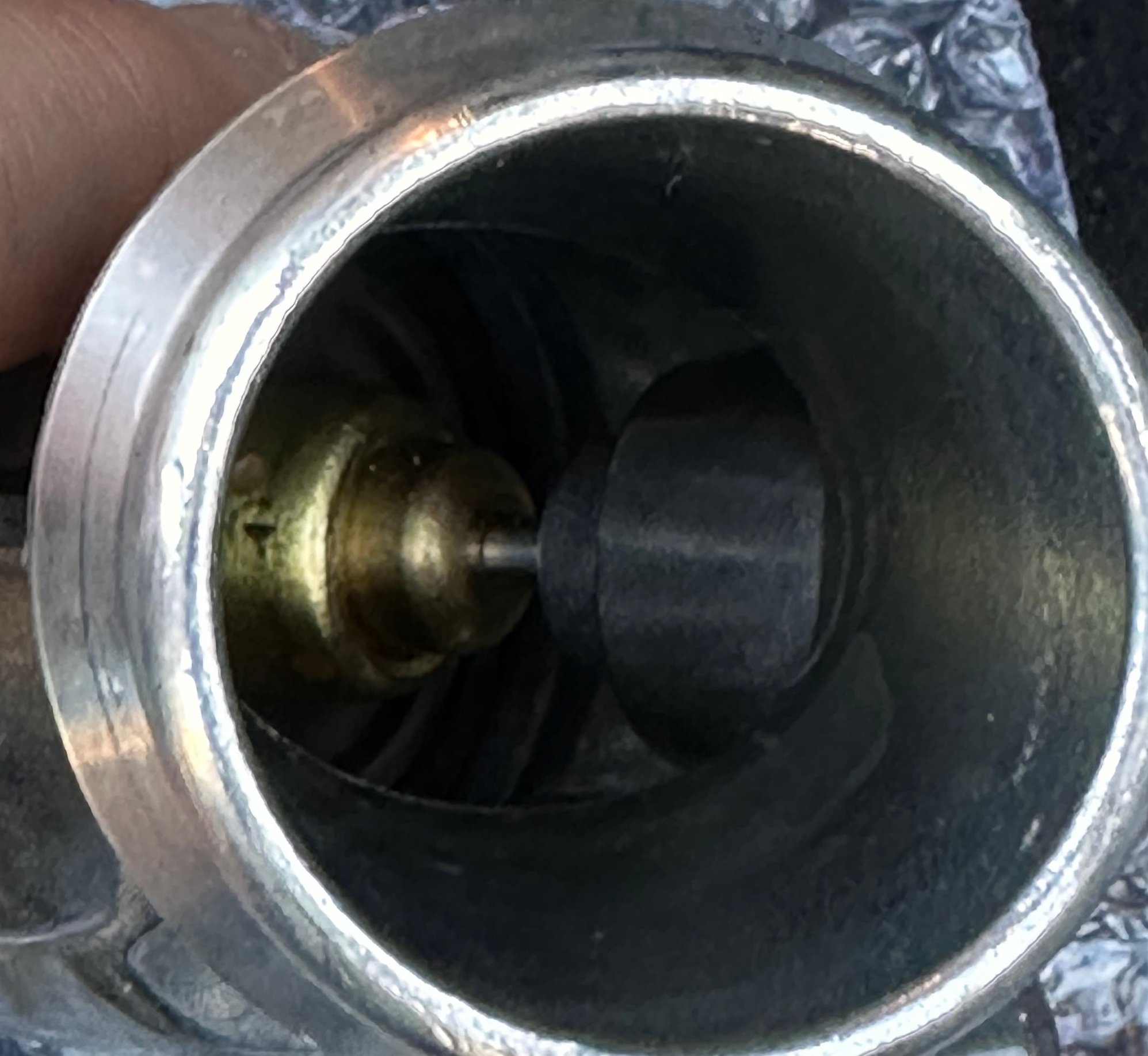

Ok having both side by side I think I can see the issue. I think it would still work but maybe not as optimal as the intended one. The channel has freer flow to the thermostat in the older design, which is probably not a factor in the updated one as the computer can manually open the thermostat.

Good pictures and maybe we are getting closer?
How does the sensor act to open or close the thermostat?

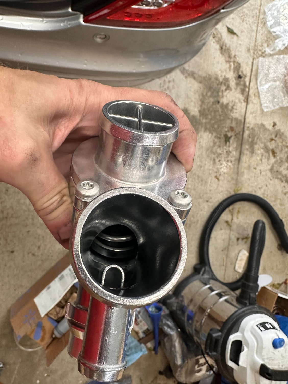

Here is my metal version taken apart. This is the no sensor version.
Maybe if I could take apart one with the sensor I could figure it out?
With what you have posted I think I will go back and take mine apart again as it's still on the bench and do some more comparisons to your pictures.

I'm returning this one so don't want to open it, but I will try to get a better picture or video of the port that flows in past the element. You can see it butt up against the bottom of the thermostat, so I wonder if it's more of a solenoid or actuator that pushes the thermostat open manually when prompted.
Once I get home from work I'll take some more pictures.

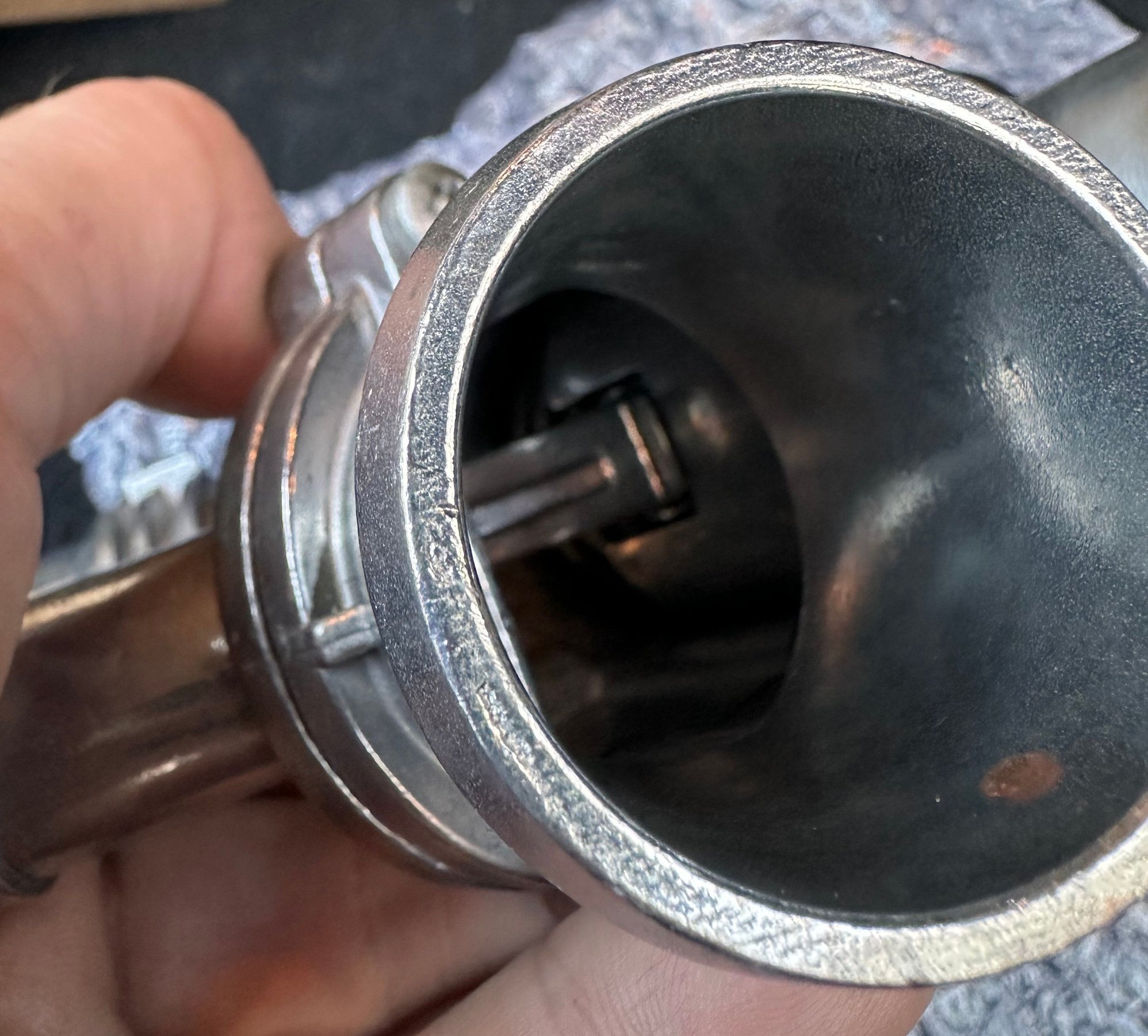

As promised, some more close ups of the updated thermostat w/ element

Thanks for the good pictures and the "sensor" attaches to the thermostat itself on the pin end. Looks like it might in some way push the thermostat open before the coolant heats up? The sensor is powered and might move?
