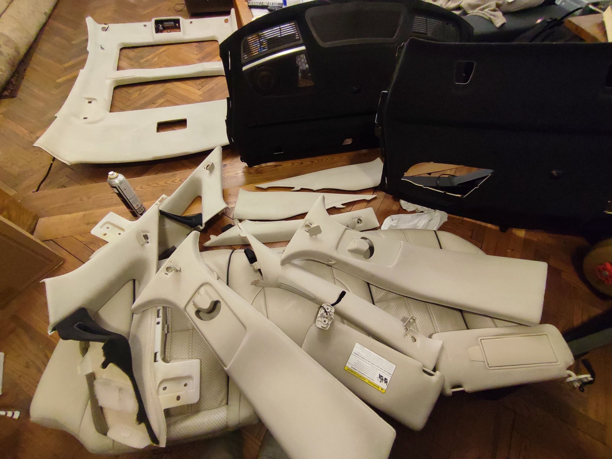

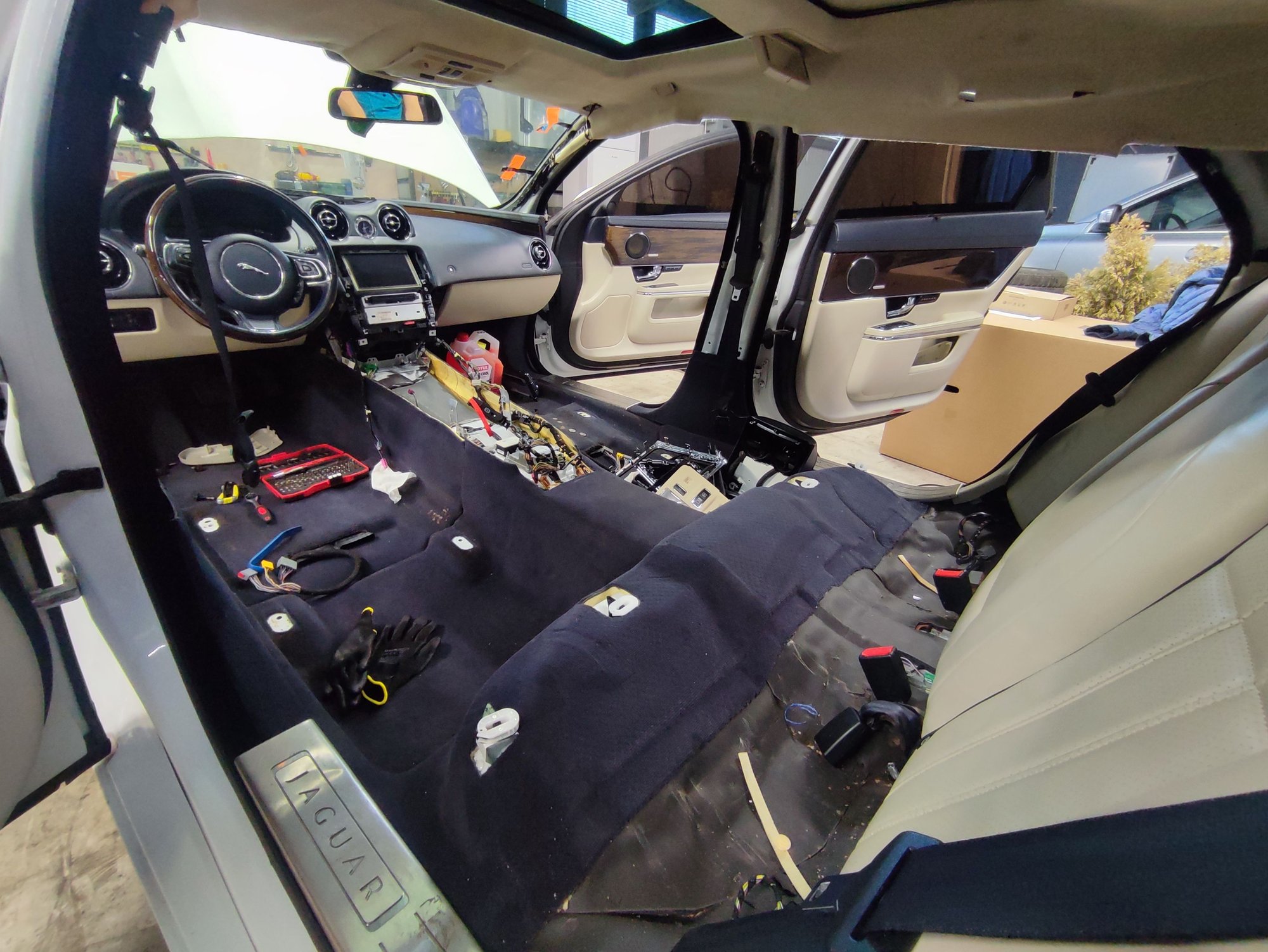

At first I wanted to change the fabric with one that was as close as possible. Where I live this is not a very expensive job(around 500eur) but as I understood there weren’t any suitable options for fabrics and colors that are close to the original color. The other problem was that I had to remove the headliner by myself in order to be sure that someone else will not damage it in the proces.
After long days of searching the internet I did not found any suitable material. I started removing the old fabric from the B pillars and this ended up being way harder than I was expected it to be. In the end I managed to find a salvage 2014 car with like new interior. I bought a lot of parts for my car and the seller agreed to sell me the headliner and all the trim for 250euro. This was the easier task.
My car came from the US to Europe with a broken windshield and the guys in the garage replaced it on the next day, before knowing that it needs to be removed again in order for the headliner to go out of the car. There is only one way this headliner can go out of the car without the risk of damaging it and it is through the windshield.
However there is another way involving more than one person and a high risk of damaging the headliner. This is what I did - removed all the front and back seats, removed the center console and even the front passenger door. The disassembly is not that hard and takes not more than hour. The problem however is to remove the headliner from the car without bending it too much. Even with everything out of the car(including the removed door) this is a tough job requiring two people. There is no way the headliner can go out through the back door. Maybe for the SWB there is a slight possibility, but I tried everything on my XJL and it was impossible.
After removing my headliner by disassembling the majority of the interior I paid a guy to remove the windshield from the salvaged car where I took the replacement headliner from. It was a much easier job and I didn’t wanted to risk to damage the replacement headliner twice. The process of putting it back in the car was a little bit easier, but still very tricky and you have to be patient and very careful. It needs to be bent a lot to go through the door.
