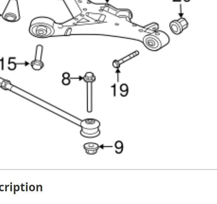

Hi team,
Anyone had to replace the rear tie rod dust covers? If so what are the dimensions or even better, a link to suitable ones would be great. The ones in question fit between #8 and #9 in the attached. Thanks!

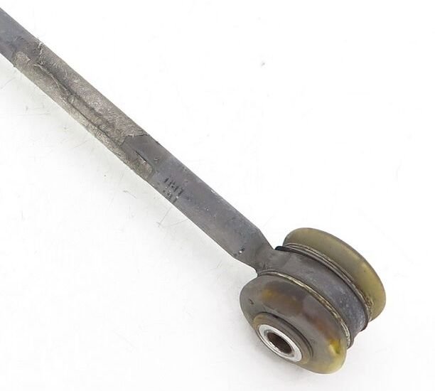

Are you sure that a boot is used between #8 and #9??
That diagram looks like it's showing the rear track rod end? I think that bushing may need replacing?
So I think you need to replace the entire rod?
Interesting background on this part too. It was first used in the Lincoln LS/S Type rear suspension way back in 1999. It originally started out as a passive rear steer setup as the rod initially had a flex joint where the adjusting mechanism is. That proved to be an idea that did not work all that well and very shortly after release of those two cars Jaguar/Ford went back to a solid tie rod/track rod set up.

i bailed on the tie rod boot renewal for this part specifically, by the time i paid for the boots and postage, plus time pfaffing replacing the boots and grease etc and not considering the fitted parts wear, i opted for just paying $95AUD a side for the original Jag part from a bay seller here in Australia, i hunted around on the net but other sources around the world made it non economical due to postage cost but the OEM Lemforder part is the next best, then the rest of the OE parts all the way down to the cheapest Chinese parts..
Postage is the killer here in Australia, i just paid 100GBP (thats equivalent to over 200AUD) to have a sunroof blind casting kit posted from the UK, but even that was cheaper than a freight forwarding company quote, it is what it is i guess, we are not driving ford falcons, sometimes you just gotta suck it up.
