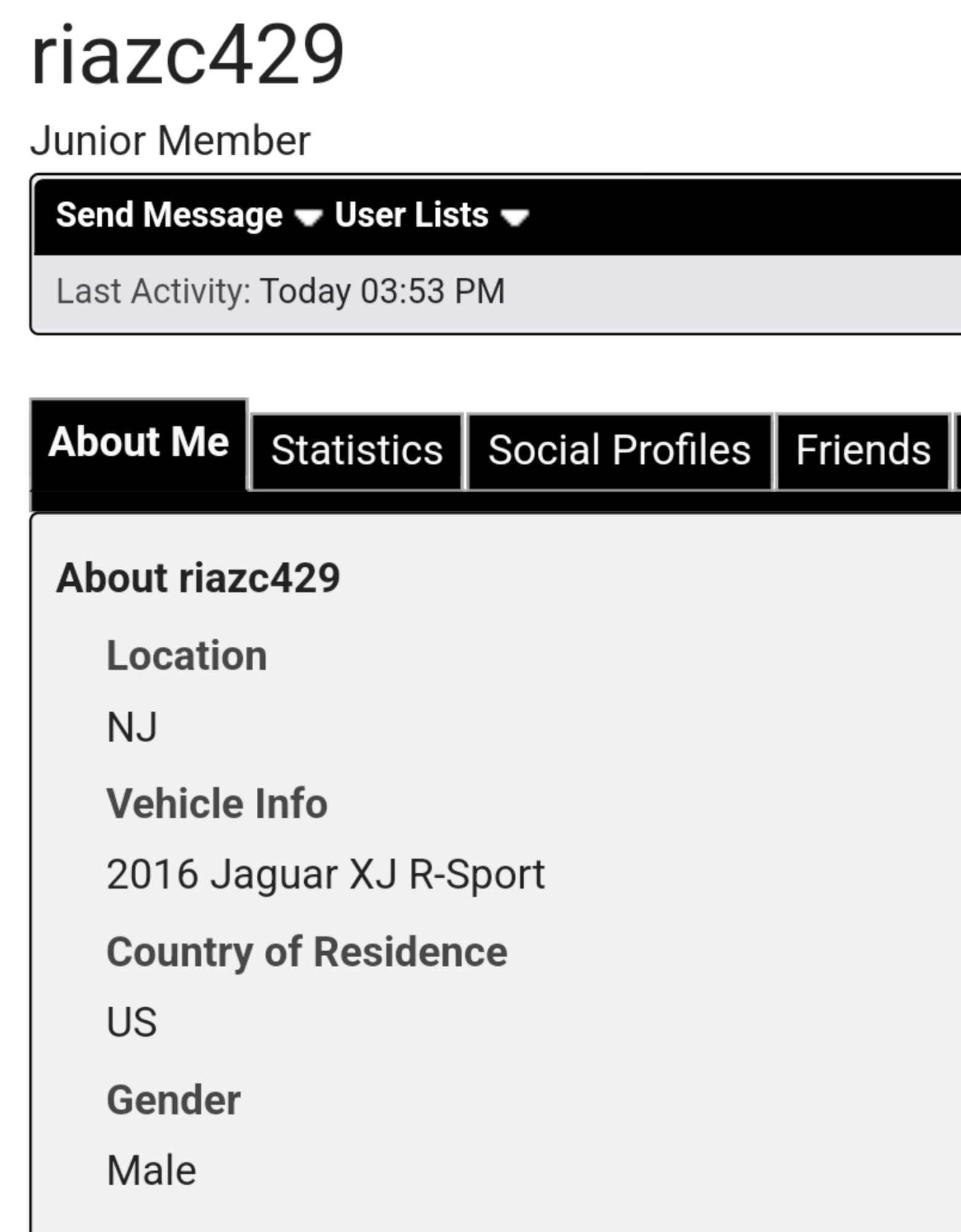

Details are in your Public Profile:

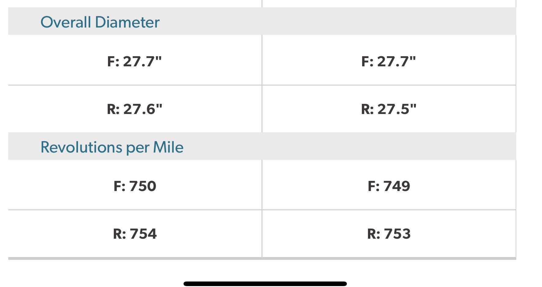

these are the other two tires tirerack.com recommends for this car (each column is different tire). These alternates show a 0.1-0.2 size difference between the front and back tires. The OEM model however is exact same size front to back.
Does this mean front to back size difference is allowed? Even for AWD cars? That’s about a 1% diameter difference front to back.

I don’t think you’re understanding. See my latest comment with the screenshot from recommended tires for this vehicle. There is only ONE tire from all brands that has EXACT same front and back tire diameter.
