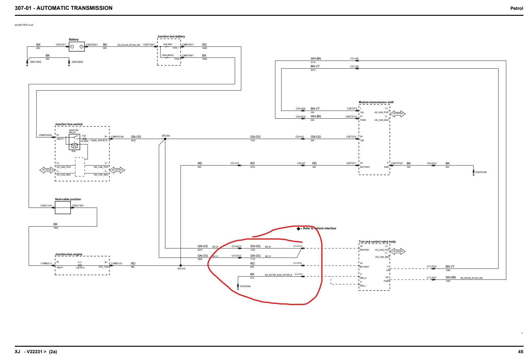

This one is kind of a mystery, and at this point, I’m honestly a little confused and would love to hear some opinions. I tried to explain everything clearly below because I feel like I may be overlooking something. Originally, I replaced the transmission and torque converter because my car had been throwing a P0740 code for a few months. Then one day, while making a left turn, the car suddenly stalled and came to a hard stop in the middle of an intersection. It made a loud clicking/ratcheting sound that almost sounded like Park trying to engage while moving. After that, the car would not move. I talked to a lot of people and read a lot of posts, and almost everyone said that P0740 usually points to a bad torque converter. Since I was already planning to replace the converter, I decided to install a lower-mileage transmission at the same time instead of replacing only the converter. I installed a complete transmission, torque converter, and donor mechatronic from another XJ with around 48k miles. What has me confused is that I’m still getting P0740, and now I’m also getting P2764. I know anything is possible, but it would seem pretty unlucky if both torque converters happened to be bad, so I’m starting to wonder if something else is actually causing this, maybe even electrical, or if the new transmission TCM is a replacement, do I need to configure it in SDD?

My question:
Most Jaguar techs I’ve talked to say P0740 almost always ends up being the torque converter.
But:
- I now also have P2764--Torque converter clutch pressure control solenoid control - circuit low
- P2764 appears conditionally (mostly high RPM)
- Am I the one in a million that actually has a dead TCC solenoid, which is causing P0740?
- Donor mechatronic issue?
- Since it's showing up in both transmissions, is it possibly a software or even an electrical harness issue?
- Replace solenoids?
- Replace mechatronic?
- Pull the transmission again for the converter?
- Investigate wiring/configuration first?
