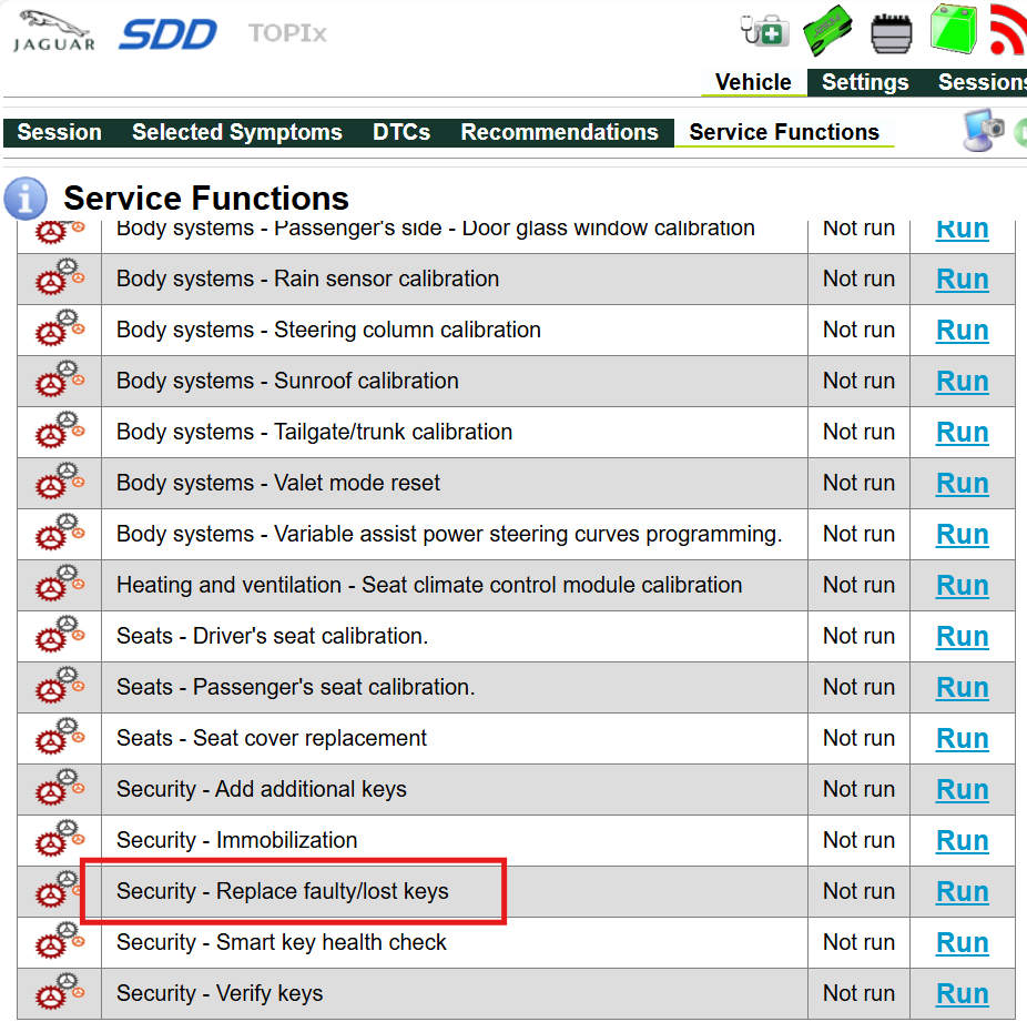

I stand corrected, I played with SDD today and it certainly seems that keys can be replaced without the ignition on. I assumed the JLR process would be similar to BMW, that they would have to program (and cut) the key based on VIN.
As has been previously stated, ensure you have a healthy battery and a substantial power supply connected. I use a Mongoose cable, as long as you get your interface connected to SDD it should be fine.
In SDD, in the Service Functions is the option to "Replace faulty/lost keys" and that should get you taken care of. I did not progress past the function screen shown below. From what I have read, they need to be new "virgin" keys. I have gotten genuine new Jaguar keys off eBay for $25-30, I prefer the quality over the cheap alternatives. That still does not get you the physical key blade, but as I said previously if you can get one then it can be duplicated by any decent locksmith for relatively cheap.
Alright I ran into an issue, I got everything i needed finally and go through the lost keys option but toward the end it states I need to download some file to continue but I can't download the file. I'm using SDD V168
