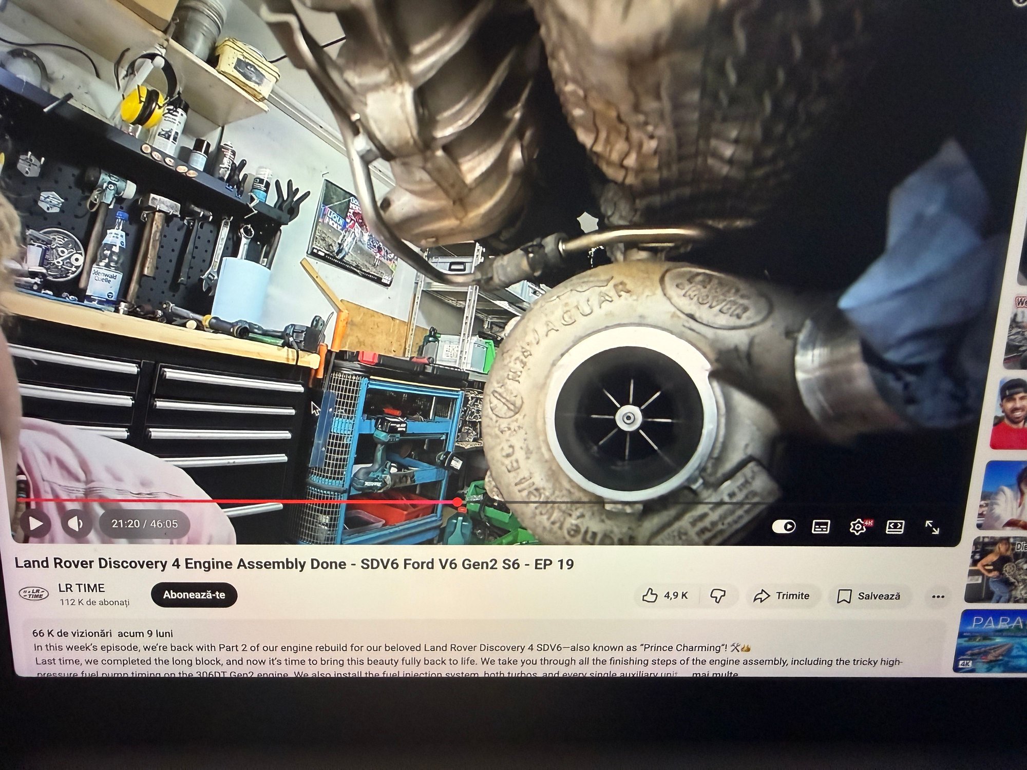

ideea update
on YouTube, there’s a guy who builds range engines. Very knowledgeable
in one of his movies
this…
you see the name and minute to find the movie,he Says that if the clamp on that small hose that unites the snap turbo air pipe to the long metal pipe that goes to the air box on the motor, gets of and the whose is not properly pressurized,
“it’s going to disable the vacuum actuator for the secondary pump. “
So….. the front pipe from the airbox….. must be holding pressure…. All the way to the turbo. Why….. and how that helps the vacuum actuator on the back of the turbo….. I don’t know. But…… I guess whe gets his hands on a full turbo, needs to make some proper testing.
look at the movie on YouTube , minute 21 and someone give us an opinion.
