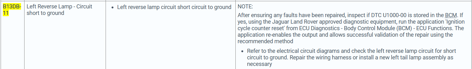

Hi, I noticed my 2018 X351 only has one reverse light, the right side, the rest of the lamps on the left side seem fine, I read the codes and it had b13db-11 Left Reverse Lamp - Circuit short to ground, which I found a bit more on here...
...I also have the U1000-00 code they mention.

Don't understand what Jaguar wrote at all but again it's pointing you to using SDD to scan the car and clear the errors from the BCM (If there are any). You got the deeper 2 digit codes so maybe you do have access to a SDD setup?

The error description seems to say wiring damage but the last statement says replace the tail light.

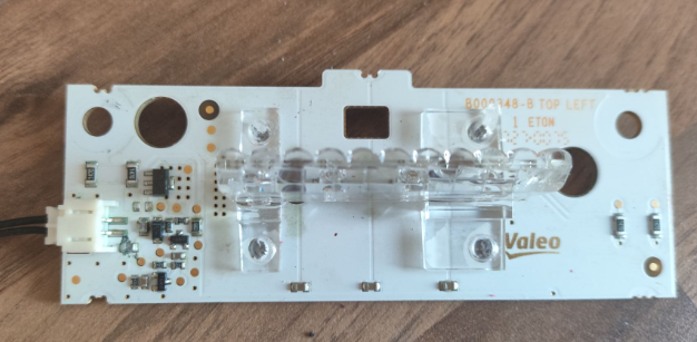

Apologies for the long time in updating this post, been meaning to update it but it is still not fully fixed, I lost the pictures I took, lost the draft reply I made (thank you XenForo), forgotten half of what I did, however this is what I can remember and hopefully will be useful for someone:

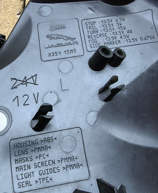

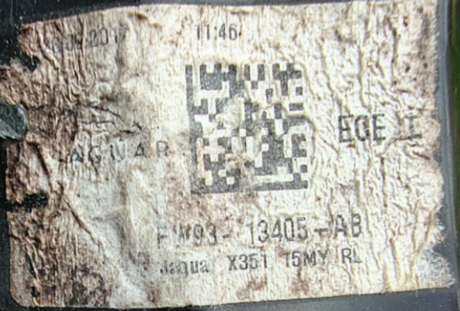

  4. FYI and when looking for parts, a new tail light from Jaguar is £760’ish inc VAT so it's worth trying a used one first. I found out that part C2D60948 is the latest left tail lamp and part C2D60948 is an older one. From speaking to Jaguar parts, they are all compatible but as they find faults (such as places where they leak!) they bring out a new part number. The engineering code is FW-9313405-AC and is on the paper sticker (see the pic below), the last two characters are the revision, mine was a “AB” and the used one I got was also an “AB” but if you can find an “AC” all the better.

  1. From a bit of research it seemed like the BCM might need to be reset to re-enable the output as per TOPIx - SSM74171. I took it to a Jaguar specialist who tried this but it made no difference. The specialist's opinion was that the BCM would try each time the car started before disabling the output. Could it be a faulty BCM as well? Thinking about this further and checking the wiring diagrams, the BCM only sends out one power feed for both tail lights and then splits off to the right lamp somewhere in the wiring loom. As the right side was working the BCM must be fine and it is a wiring fault.

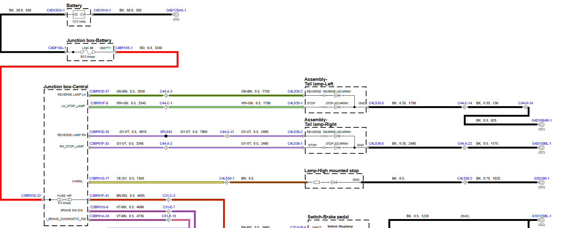

  2. If it is only one wire powering both reverse lights, how does the car know the left one is not working and the codes generated? From reading the repair manual and looking at the wiring diagram, the vehicle works out if there is a fault by using the earth and each tail light has a different earth point so this makes sense, as there is only one earth for each tail light and all other lamps work, it still points to being a wiring fault..

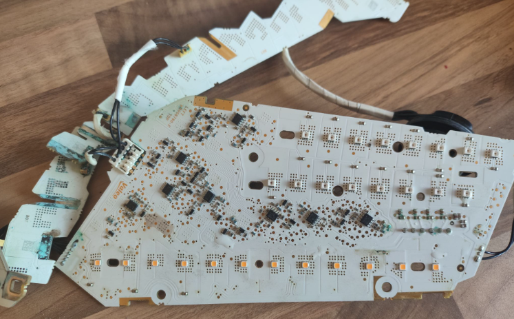

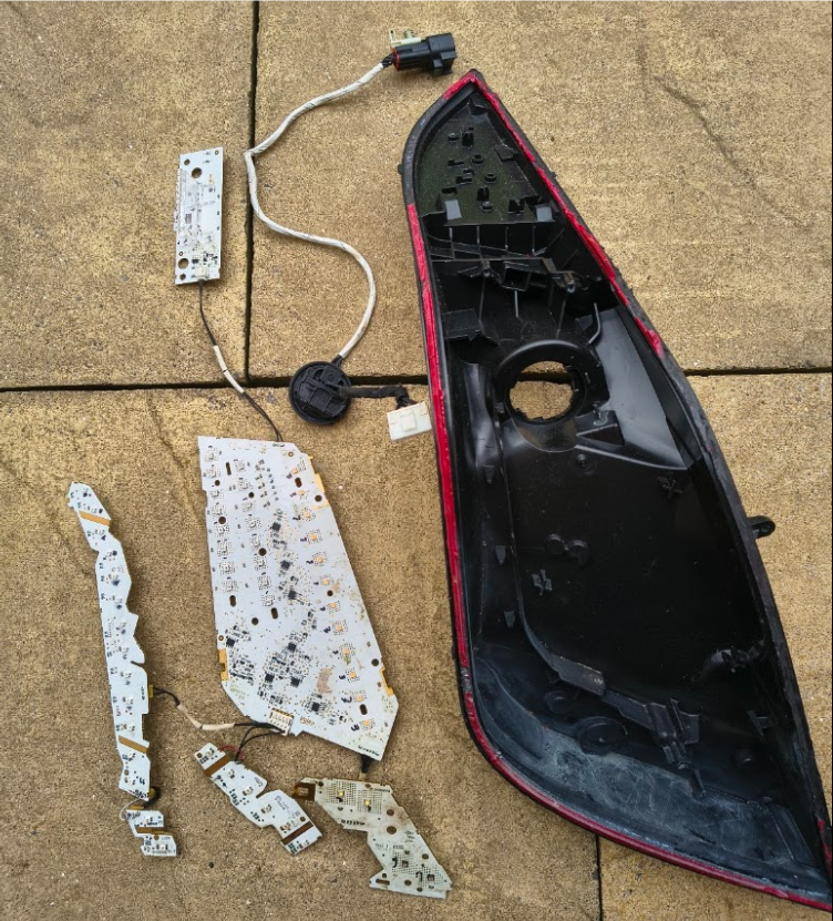

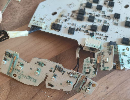

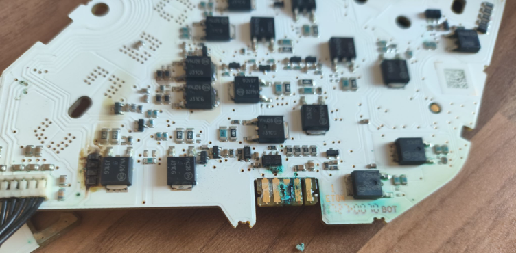

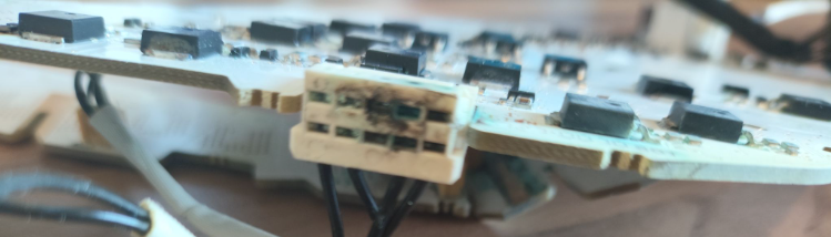

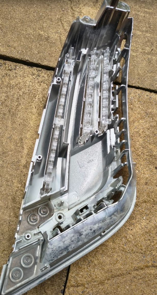

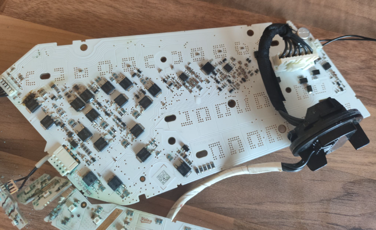

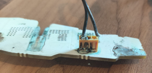

Bad Tail Light Root Cause Analysis and Dissemble
  1. Just for fun I wanted to work out why water had gotten into the lamp unit as I could not see any obvious issue
  2. To test, I sealed the two holes on the back and dipped the lamp unit upside down into a large bucket of water so that the top 50% was submerged and left it for 10 mins. I removed the covers and no water came out so that seemed fine.
  3. Repeated but this time submerging the lower half, this time water poured out. On close inspection I could see where the red plastic and the clear that is in the center of the units were not flush on one side, you could catch it with your finger nail. I could not see any damage so I think it is just a ‘feature’ of the design. I also left the lens in the shed over summer and winter and when I check it again it is now flush so maybe it is a heat thing where the plastics expand at different rates and can split but when they are not in the sun they are ok. Note to all X351 drivers, reverse your vehicle against a wall to keep the tail lights in the shade
  4. In case it is useful for anyone else, I also bench tested each tail light using a 9V battery, by putting negative on the earth pin and then the positive on each of the other pins the LEDs light up fine with that voltage, for the orange indicators they are sold orange of course as the flash comes from the car. Handy to know if it is cold and wet and you want to do testing in the house 🙂
  5. I took the lamp unit apart (used a dremel to cut out the lens from the black plastic case) to see what damage was done and to see if I could fix it (just for fun). After some cleaning and resoldering, all of the LEDs worked apart from one and I managed to get most of the circuits working but not all and I think this is because some of the metal contacts on the circuit board have gone, lots of the solder joints are just dust etc, some pictures below (there is lots of green in the lower part of the lamp from sitting in the water) in case you are interested…

Looks like they do not share anything from left to right. If your output is disabled (that U1000 code), you may need to run the 'enable protected outputs' function in the BCM to get the light back on.
You can try doing a battery reset, it might bring it back if the circuit is fixed. The module detects the short and over-amperage and turned the output off, it needs to know that it's fixed before it tries it again. There are no fuses in the circuit, so this is how it protects itself.

Also out of interest, where did you get the circuit diagrams from, I think mine a back and white

That's from Topix, the factory workshop manual.
