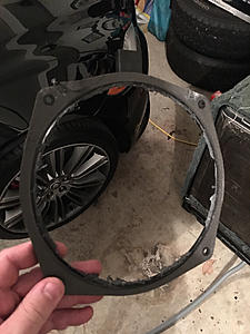

These speakers are a bizarre design and when the cone is popped out or the surround is failing the metal coil barely touches the magnet and it causes distortion sounding like a blown woofer. But it's not blown. Similar sound to if the + - wires were barely touching. My driver door was like this and it kept getting worse. If you pull on the Orange surround you'll see it's starting separate from the frame so the issue starts happening. Anyways I swapped all the door woofers and the car sounds amazing. Had to basterdize the old speakers to use as mounts, but they worked perfectly, not one rattle.
The. I couldn't get to the rear deck woofers so I re-glued the surround with speaker surround epoxy and they sound great again too. I had the bowers Wilkins set up.

Crutchfields in Virginia sells that adapter ring. You mount the new speaker to it and then bolt the ring in like the original speaker. I've always used the Infinity Kappa series speakers in all my GM's. So far the B&W speakers are ok in mine.

I had already started and I was impatient so I just made my own. I cleaned them up with a grinder and added some polytape to make a seal and they worked perfectly. Plus they were free :-)
