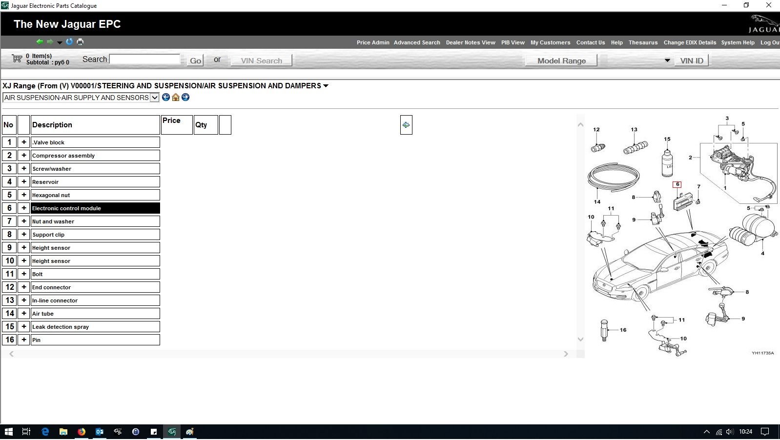

I'm having issues with my suspension fault warning coming on and the rear drivers side suspension becoming super low. After I start the car and then move, it will level out, sometimes it will lower while driving and then level out after parked. I need to know where the module is actually located so I can look for loose wires or just replace it.

See item 6.

What specific DTCs are being logged with the fault?
Assuming you have checked the pipes for leaks, also check the ride height sensor through the full resistance range with a multimeter and compare with a known good one from another corner (they can fail) and check the wiring in the split plastic tube that goes to the sensor (the wiring can rub on the sharp edges along the split and wear through the insulation).
