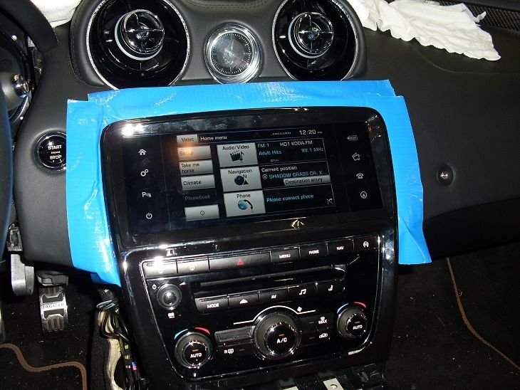

I have a problem with heat and air controls, but you have to removal the bezel to access the control. I have put together a set of tools to do this without damaging the bezel. If anyone has any comments, please respond.

Are you having problems removing the bezel?
It pops off pretty easy and the only suggestion I have is please put some tape around the bezel so you don't put dents in the leather. I almost made a mess of mine!
Any standard plastic pry tool will work. The cheap Harbor Freight ones are fine.
