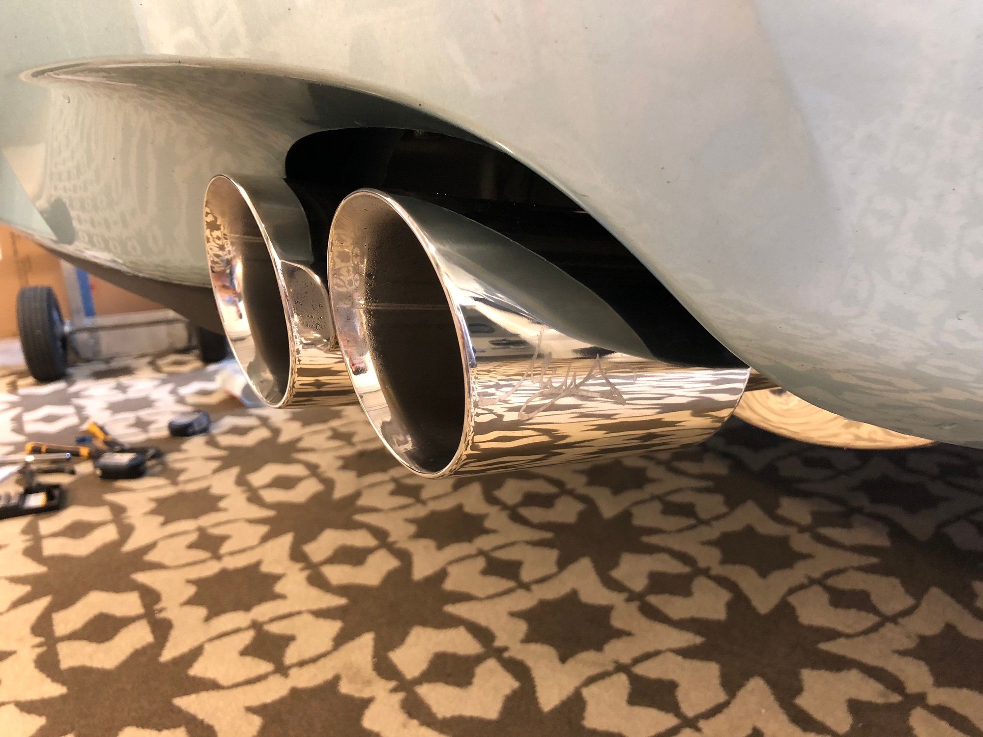

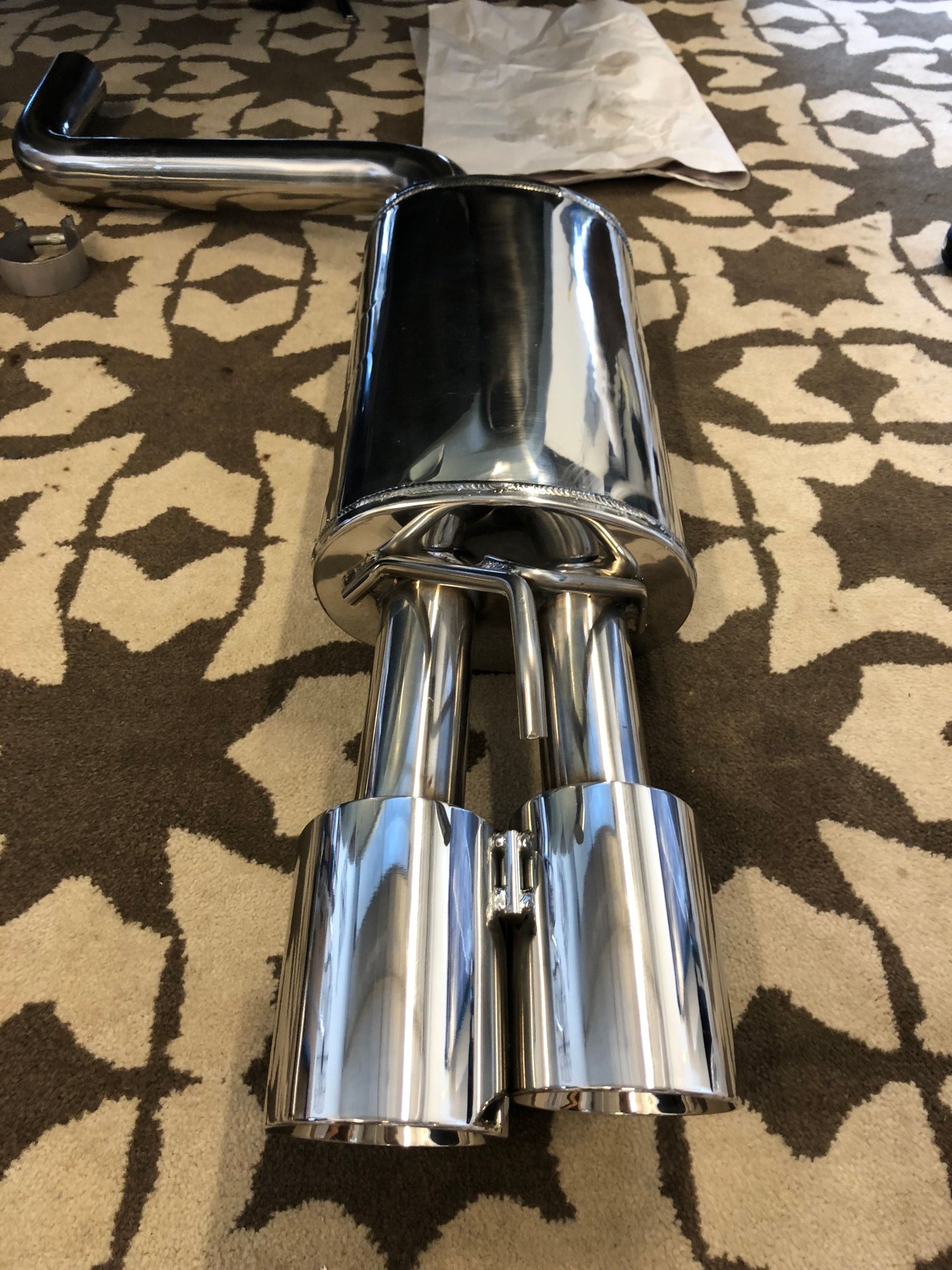

Hey Guys, Here are some photos and videos I took when I installed my new exhaust a few days ago. The Mina exhaust looks and sounds great. Much deeper sound and super easy to install. If you notice in the Mina video the deeper tone makes my phone resonate a lot more.
