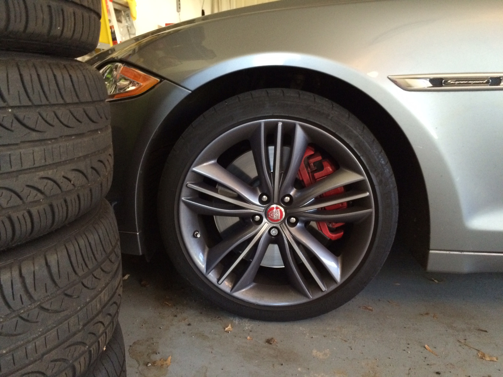

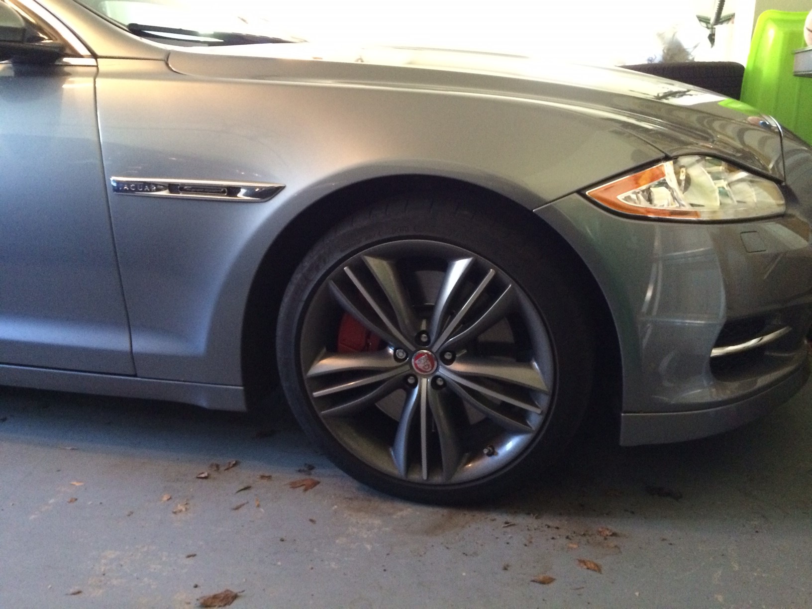

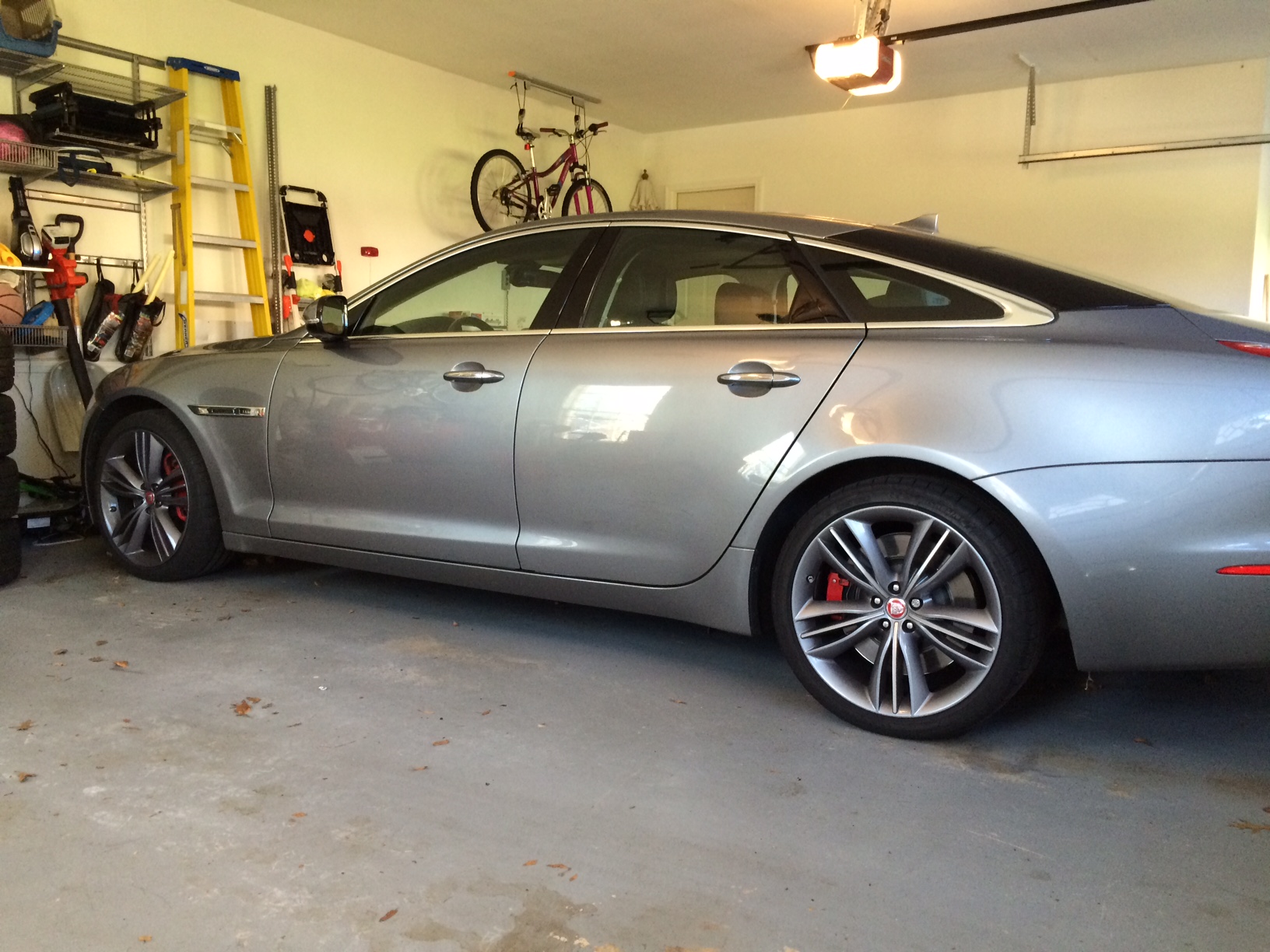

Rostman: Here are a couple of shots today. Please, note that the tires are 80% worn so they gap is just a little larger. I do like the way the tire sidewalls protrude and help the look and protect the wheel.

Thanks XJsss. For me it looks ok. The funny thing it doesn't look much wider than my usual sizes with Continental (245/40 and 275/35).
Pirelli looks more "square" on the rim as i can see.

Tire diameter difference is less than 1/2"so the look should be pretty mush the same. The reason the XJR tires don't protrude is because those wheels are 1/2" wider (9.5" X 10.5") than my Mataiva Wheels (9" X 10") BTW my wheels are the minimum widths that will support the wider tires. Below are the versions of Michelin PSS's. Note that the rears are offered in three different compounds (BMW "*", Mercedes Benz "MO", and non manufacturer specific). Make sure you buy a matched set as I did (BMW) where speeds are higher a missmatch of compounds may result in unwelcome handling
