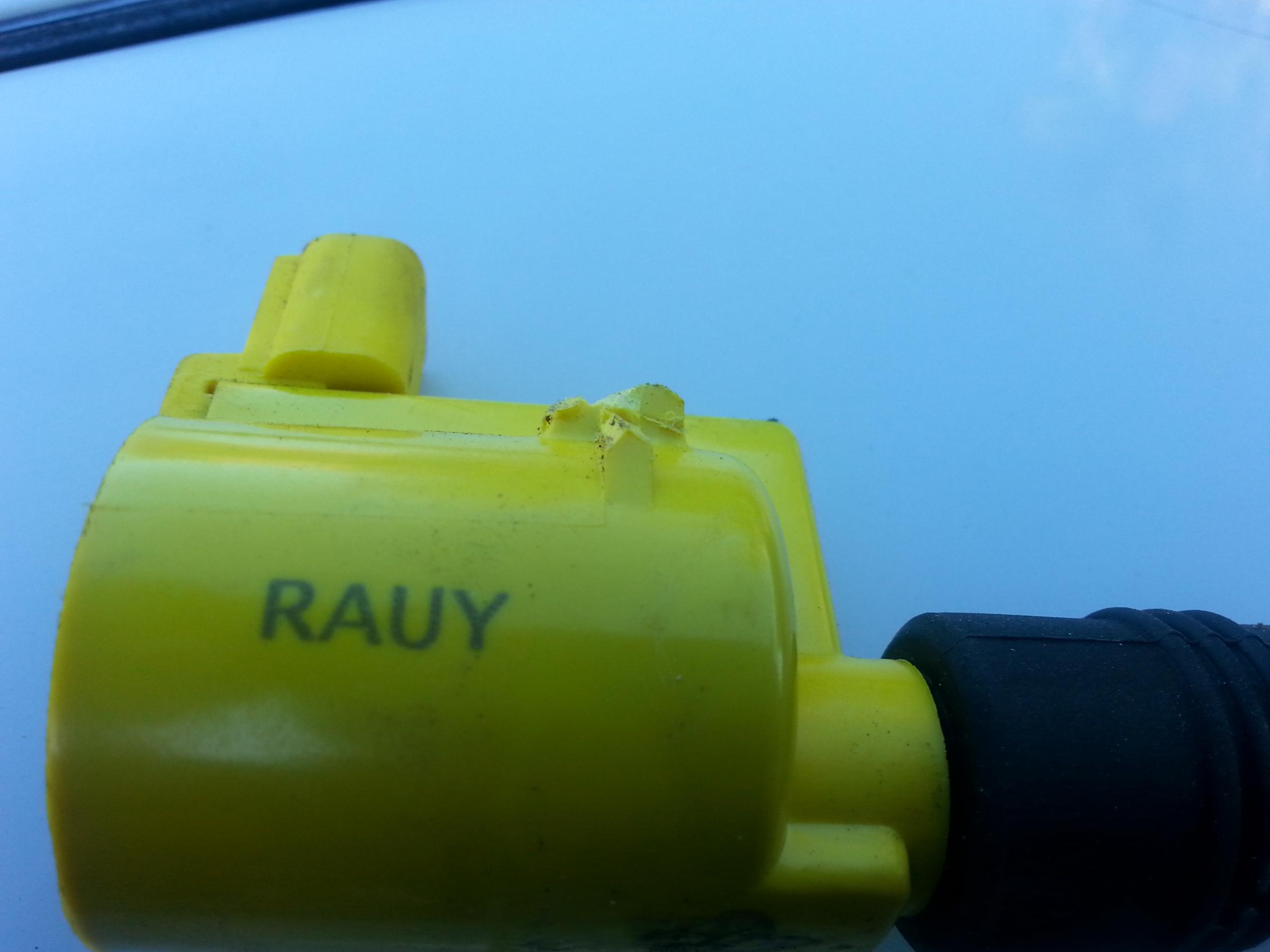

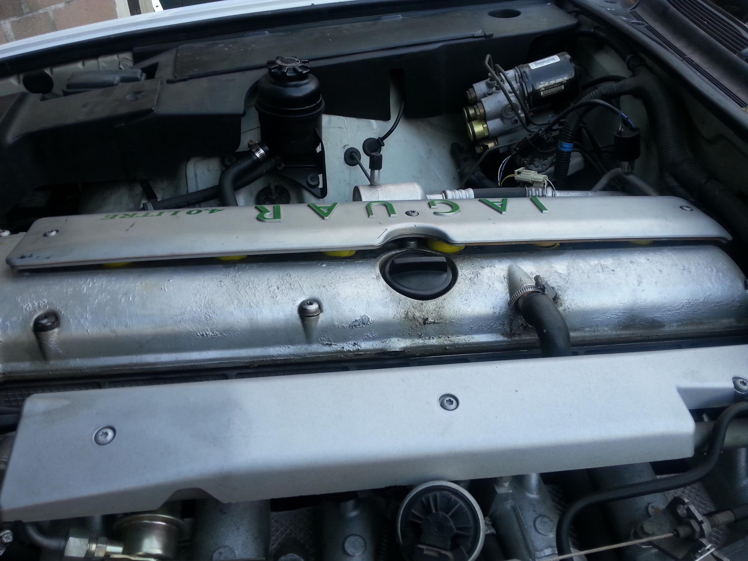

The LS coils can be bought on EBAY as cheap as $51.00 for 8 coils. I paid $8.50 for each coil. Just break off the mounting tabs like I did. It's very easy. I didn't like the way the electrical connectors fit. Even though you can make them fit by turning them upside down. There was too much cracking and crunching for my taste.
I went to the local "Pick A Part" scrap yard and cut the connectors off a 1999 Lincoln Continental. You can find them on so many Ford and Lincoln Vehicles from 1999 to present. Pretty much any of them with coil packs. Just cut your connectors off and splice them in. Don't be afraid to cut and splice. It's not rocket science. There was no charge for the connectors at the "Pick A Part" scrap yard.
I am extremely lucky that I read about bad coils before I spent money on other things like fuel filters and pumps,ECU issues,TPS and transmission diagnosis. I put these cheap coils in my Jag and she has been purring along ever since.
Before I replaced my bad coil packs my car was acting absolutely crazy. Idling high,low shutting off at any given moment,dash lights flashing like a Christmas tree, transmission limp mode light coming and going. The new coils solved all those issues. My car has been running perfect for 23,000 miles. If it acts up again I'm going to just replace all the coils before I do anything else.
The 2000-2006 Lincoln LS Coils are the ones from the V8 engine. Not the V6 engine.
