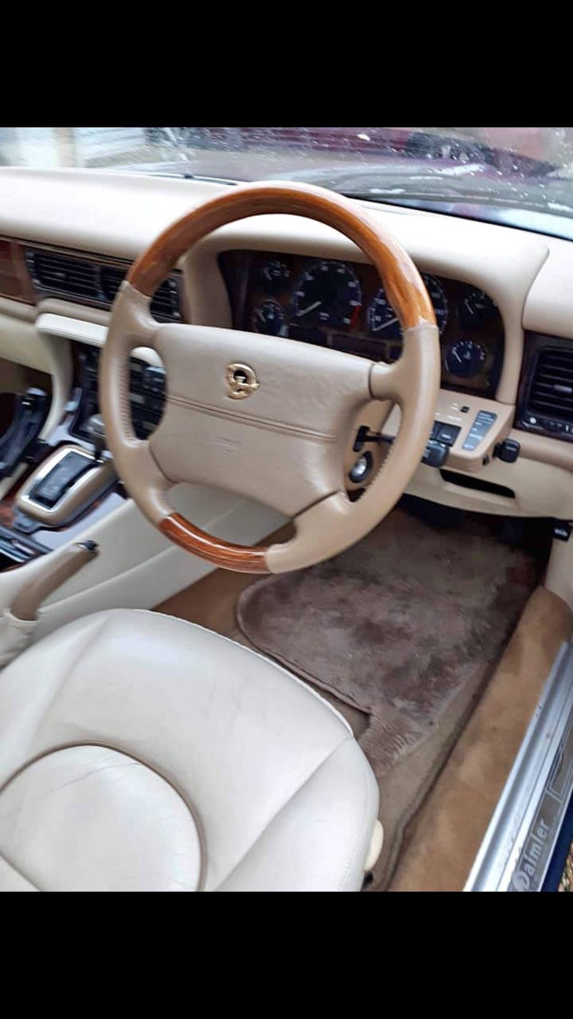

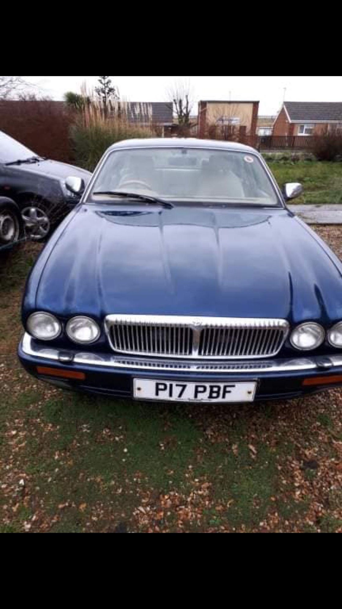

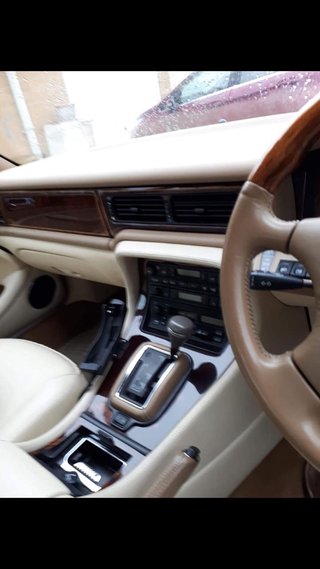

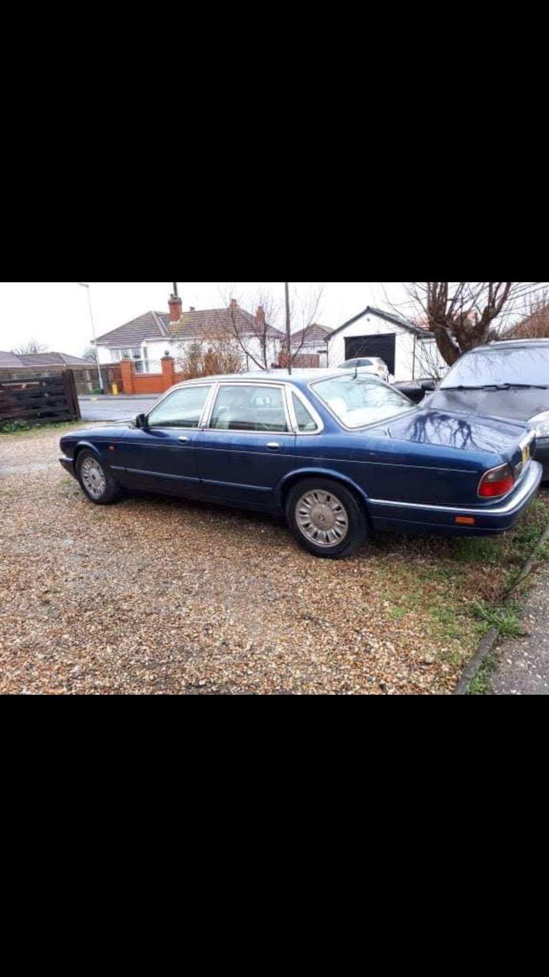

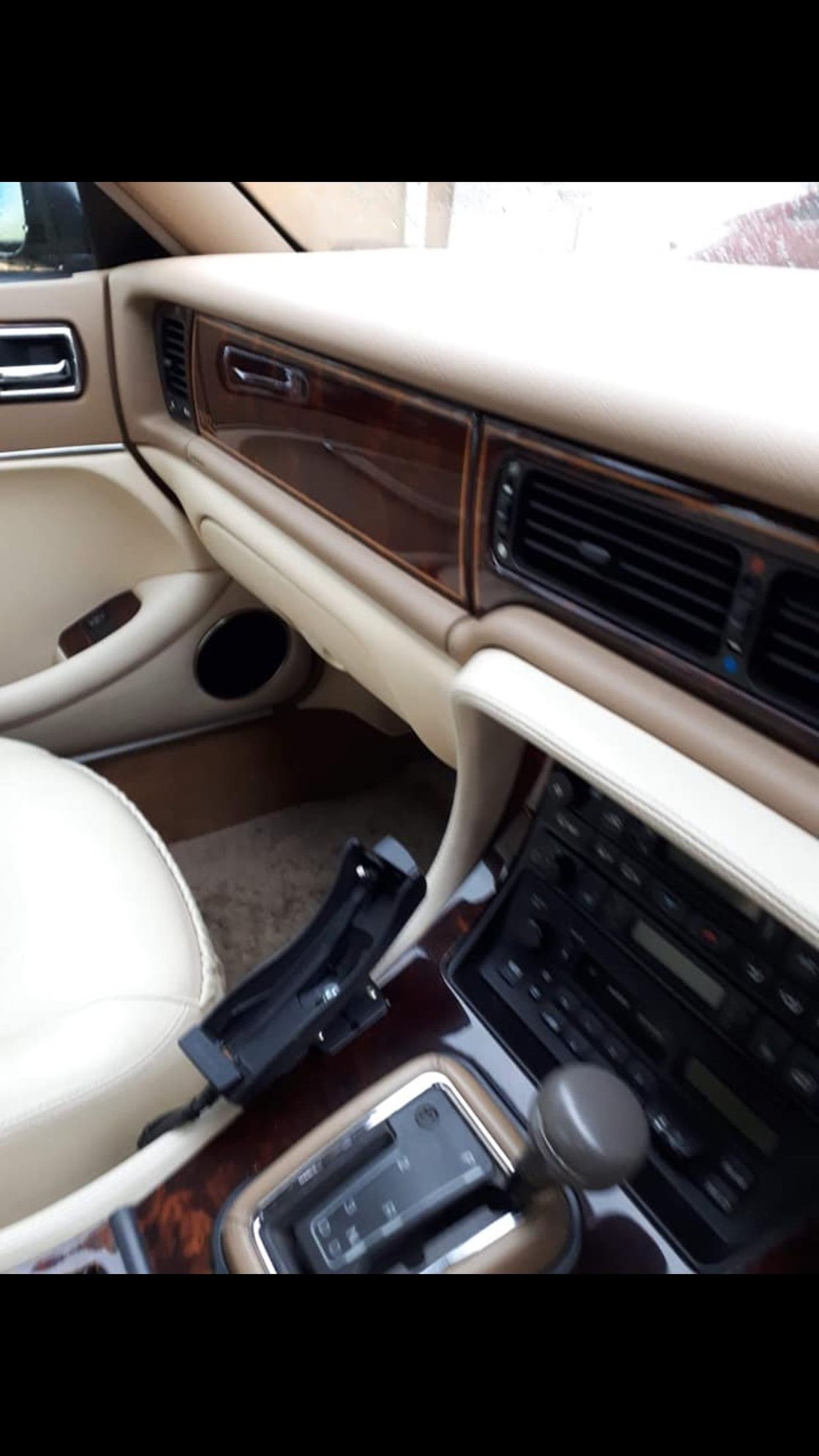

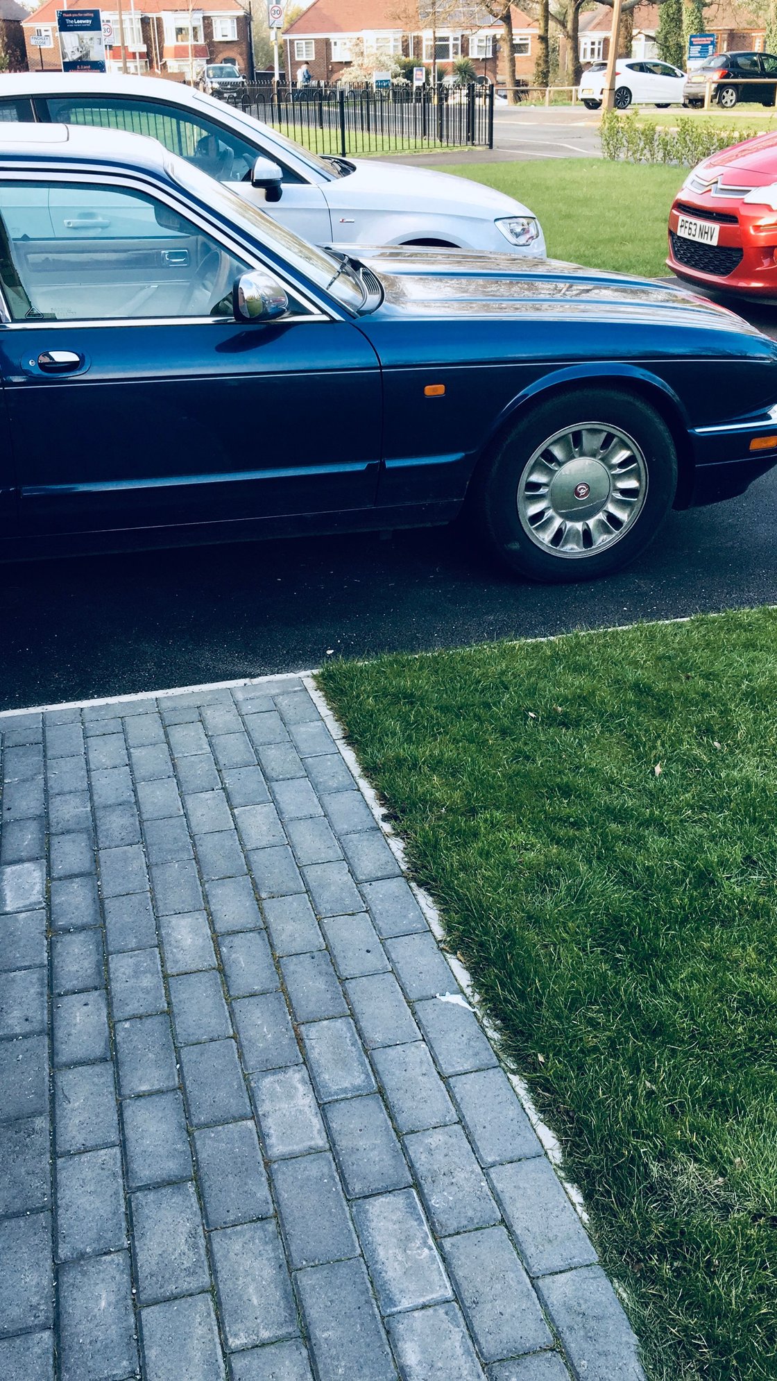

Thanks for the photos. I see it is very similar to Tcasmarcus's recent DD6 Century in Sapphire Blue, with chrome Turbine wheels and Cream interior. Lovely. Although I see yours is a short wheelbase model and a RHD of course. Very interesting.

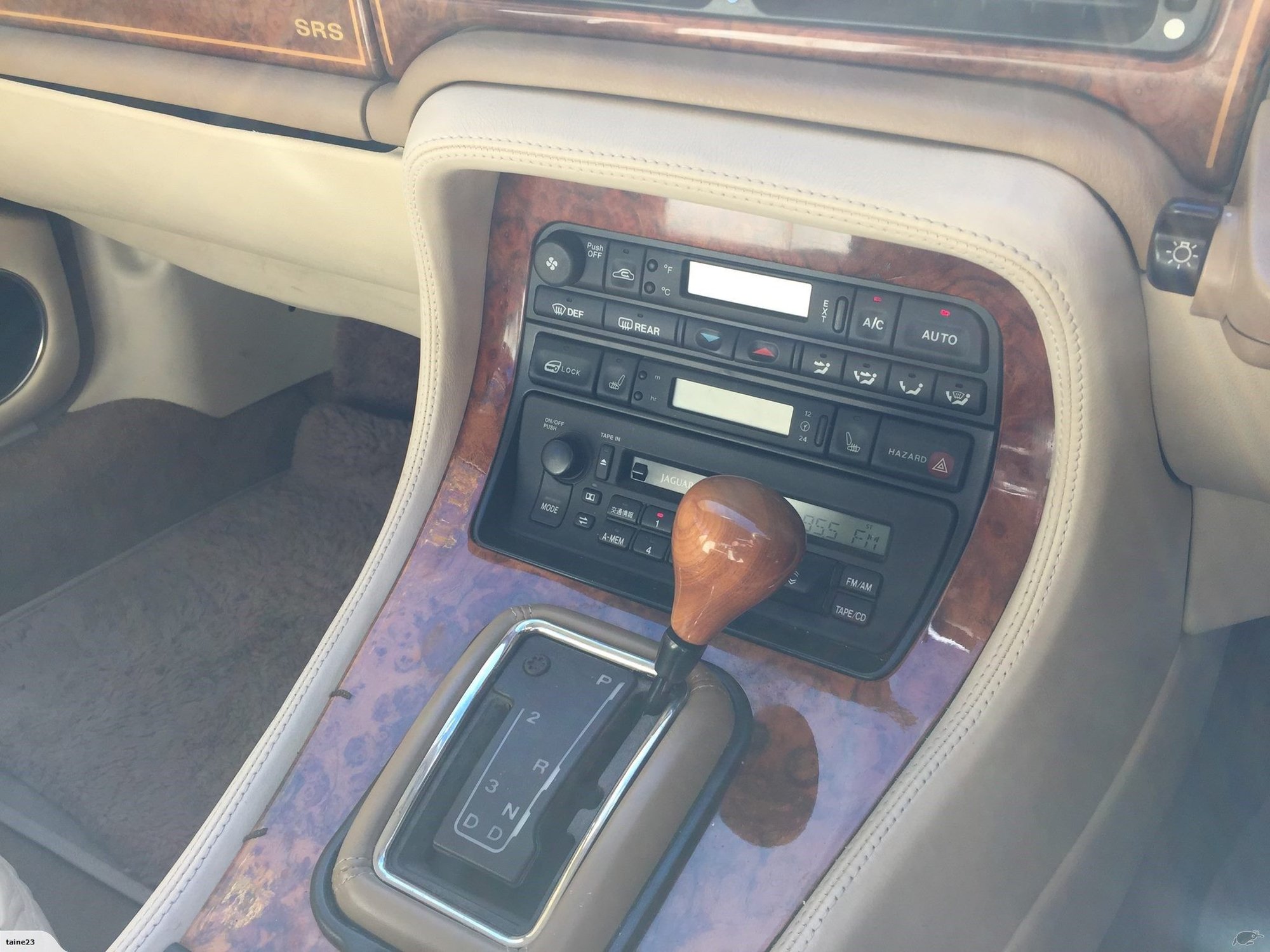

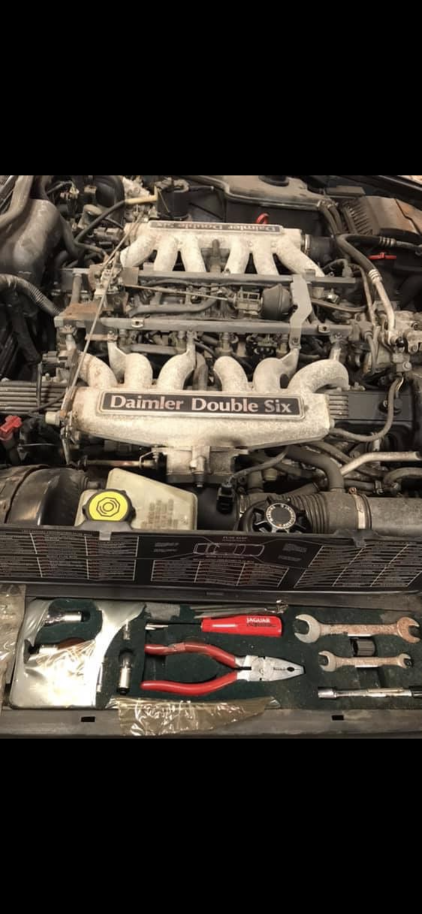

Someone has made off with your engine cover and original wooden shift knob! Lots of options for a new knob, but the engine cover, not so sure. How are those fuel rail crossover hoses looking? Likely time for new ones. I documented the replacement I did last year in this thread.
How's she running now?

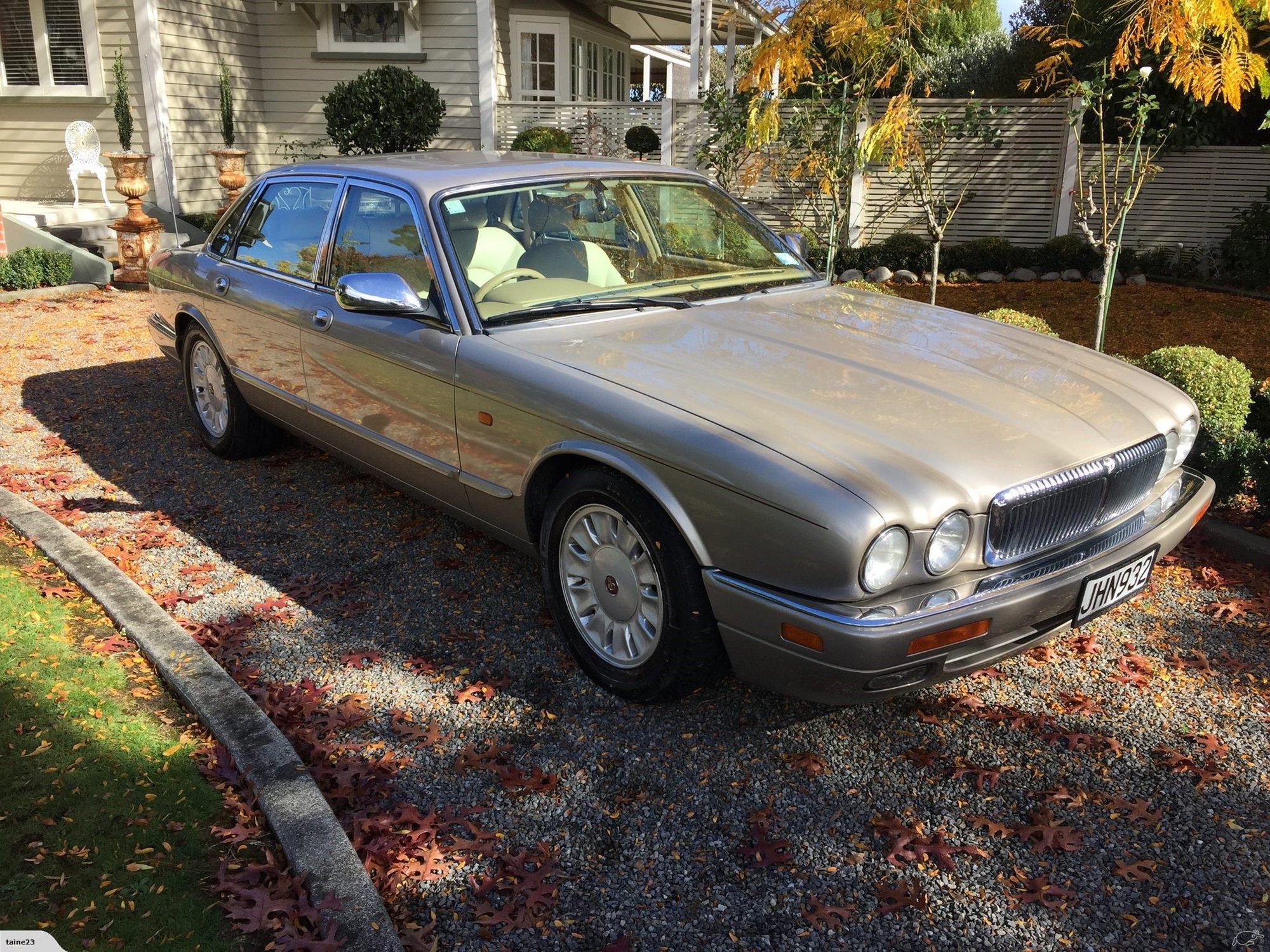

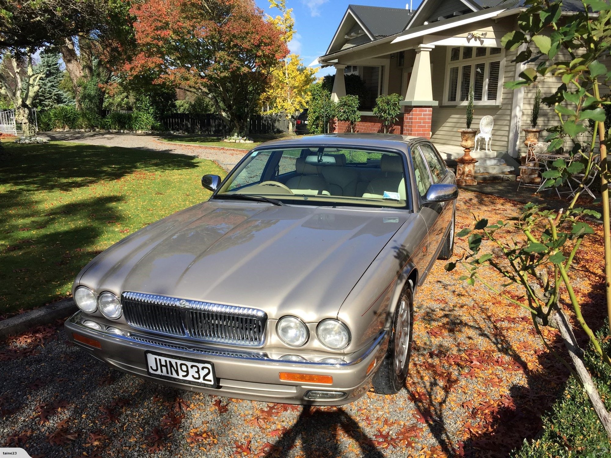

I was browsing through the forum to pick up ideas for the 'new' DD6 I've just acquired and thought I'd take the opportunity to reply to this thread. I'm in New Zealand and have owned a '64 V8 Saloon for a couple of years and thought I should enlarge my fleet with a 'modern classic' so ....
Have a couple of local 'Daimler' nuts, one with an X305 DD6 Century and the other with an XJ40(?) DD6 Insignia (one off Signal Red)

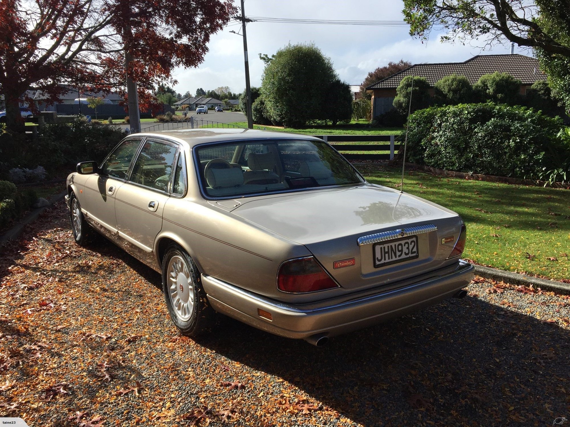

It's a 1994 RHD with 92k kms and was originally delivered into Singapore, imported to NZ in 1999. Let me know what you think.
Old Feb 4, 2020 | 01:24 AM
1 of 19's Avatar
Joined: Oct 2014
Posts: 1,757
Likes: 748
From: Eau Claire, WI.
She's a looker. Love the color.
