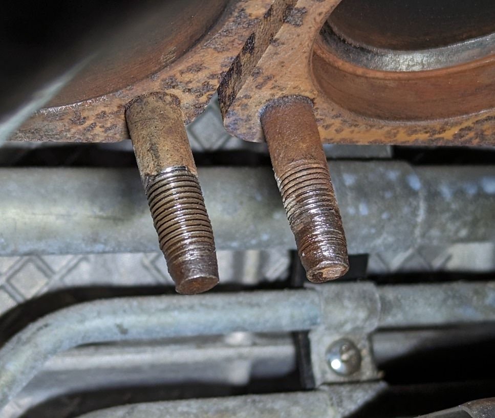

Well, turns out the studs are backordered anyway. I have ordered a 3/8-24 hex die; perhaps I can revive the old studs.
I'll try to clean the manifold aperture surfaces, but they seemed to be pretty smooth already. I'm definitely not above throwing a bead of exhaust paste at it, too. There's already paste in place of the RH olive.

On the inline 6 the studs going into the manifold were a different thread than the running nut side
I have 2 ( but not 4 ) new spares in the garage and should still have the invoice part # and maybe the same for the V - 12
Could still get the specs from a mandrel at the hardware store
Your existing threads can't get any stronger

Convinced myself to redo the downpipe today. Only one of the four studs was truly in a bad way.
Going over it with the die seemed to help a lot -- helped all of them, really. Unfortunately, I only took a 'before' pic. Surprisingly, I was able to get a drill with a 2" wire wheel up there to clean out the mating surfaces in the manifolds, though they didn't need much.
I'm letting the exhaust paste set up so I don't yet know if it was a success.
