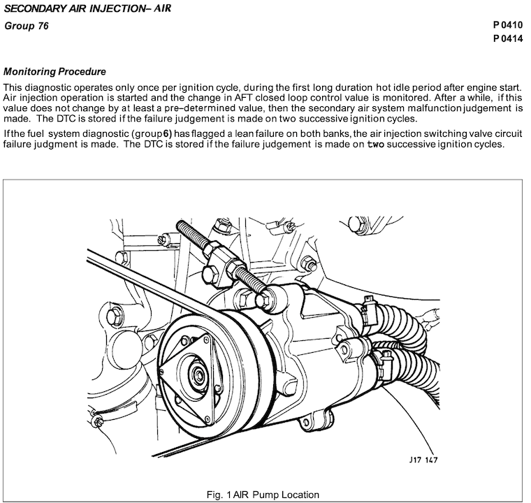

Secondary air pump.

If it is the secondary air pump (I assume I’ll be able to tell now I know where to look), any thoughts on the urgency of replacement?

My car has the start up hum from the air pump also, and it’s nothing to be concerned about. You can only hear it because everything else is so damn quiet.

As I wrote in the thread above, if you are concerned about excess noise from your smog pump you may just need to detach the in and out air hoses (accessible from the wheel arch) and putting some compressed air through it to clear out any dirt and dust that has been ingested.
Also blow some air into the clutch gap area at front of pump as crud can get in there and cause slippage/noise.

You don't get a CEL? I was reading the OBD-II manual and theres a bunch of possible codes for inop air pump, which scared me into not disabling mine.

You will get a CEL without a smog pump. The thread I linked to was about how to keep the smog pump operating efficiently. The one I took apart was a spare, not the one on the car.

Original poster N Bath has a smog pump that is turning somewhat just noisy so may not show a code in my opinion ( not a V - 12 owner )

My car, a V12 built for the British market, has no smog pump and no associated CEL so there must be a way to program the BPM or ECU to allow for this.
All that is there in the pump's place is an idler pully.
